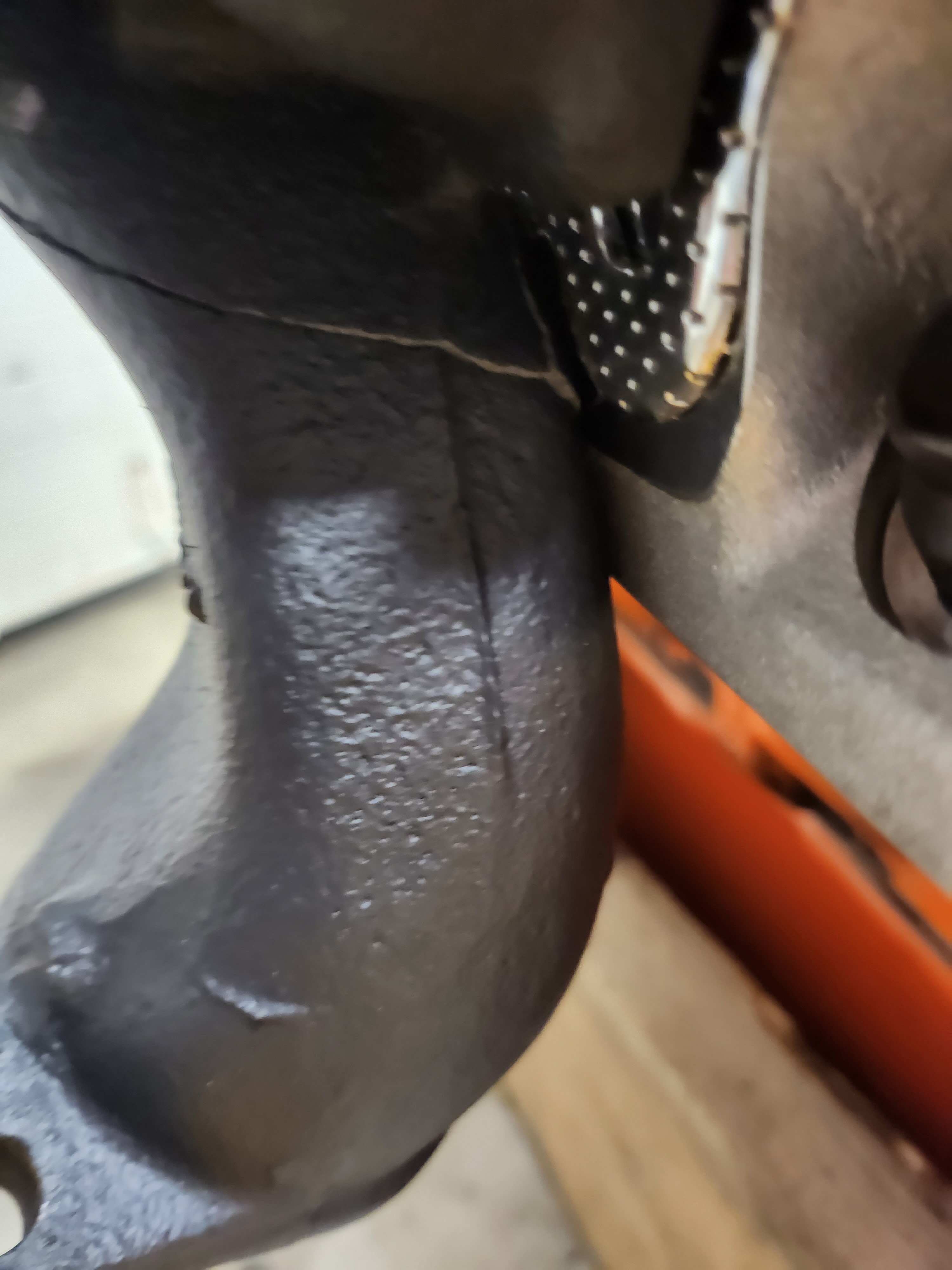

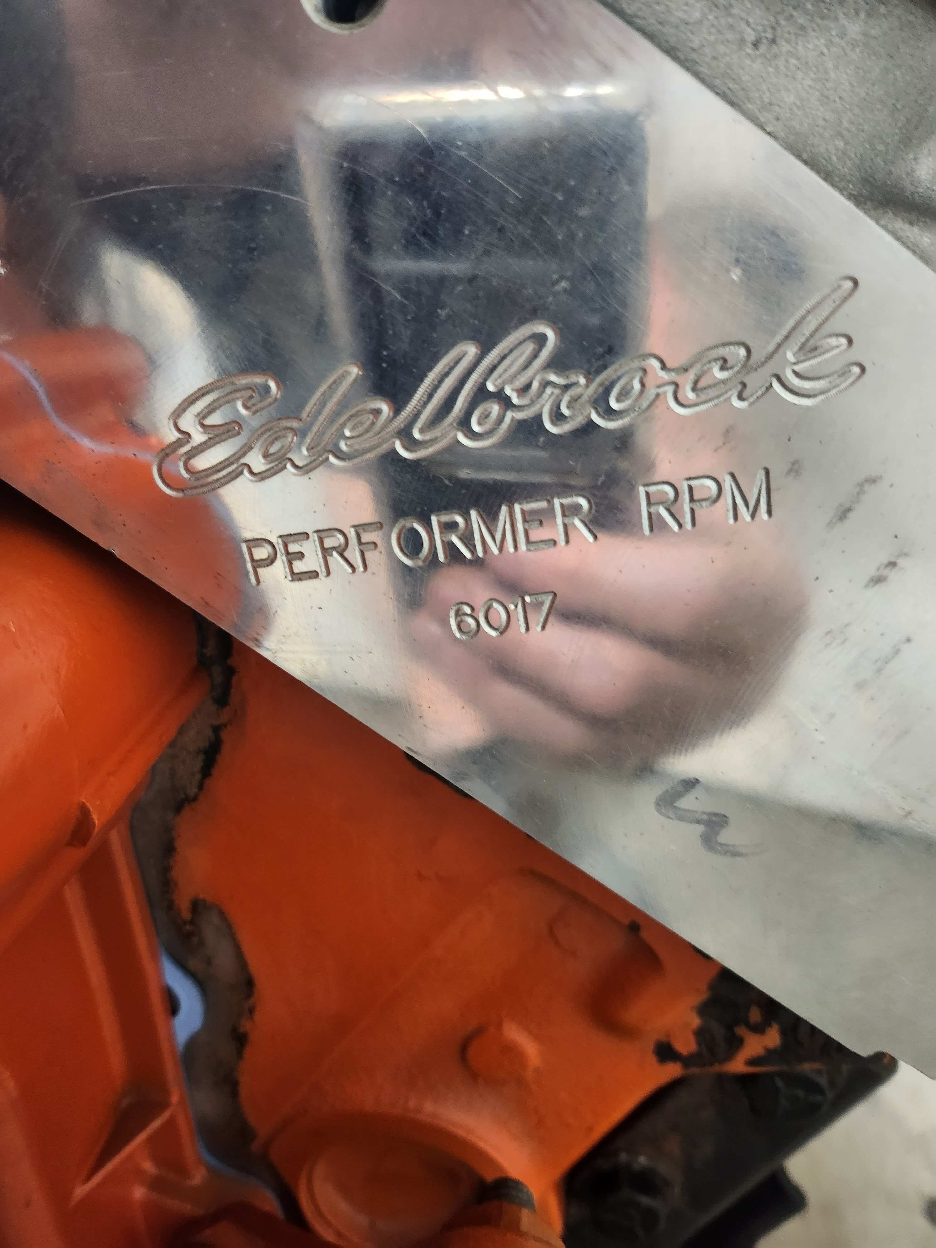

Just putting the final parts on a 340 thats going into my 70 cuda today, bolting up the exhaust manifolds to a new set of aluminum edelbrock heads, when I hear a pop, I look down and cracked my exhaust manifold on the drivers side, After a closer look it seams that the manifold was hitting the aluminum head on the back of it and would not allow it to flush out. F--K!!. so I guess its header time now or has anyone else had issues with the clearance. wondering if I can remove some of the aluminum head for clearance. if I can find another drivers manifold. and if not what headers are people running that fit the best in these cuda's. Thanks in advance!

That bites , Eddy heads are not a great choice & probably interfered with sitting flush , yes you can grindthe head & manifold for clearance .
if you choose headers TTI , Dougs or Hooker 5115 are the only choice that stay about the steering centerlink

I agree, that sucks! Can the exhaust manifold be brazed or is it a really ugly crack?
Like Chryco mentioned, TTI, Doug's or Hooker 5115 fit the best and don't hang down too low. I like using Remflex graphite gaskets as well.

Manifold is pretty bad plus it's an aar with correct exhaust so it looks like either find another manifold or plan on headers and customizing the exhaust which goes hand in hand with the headers

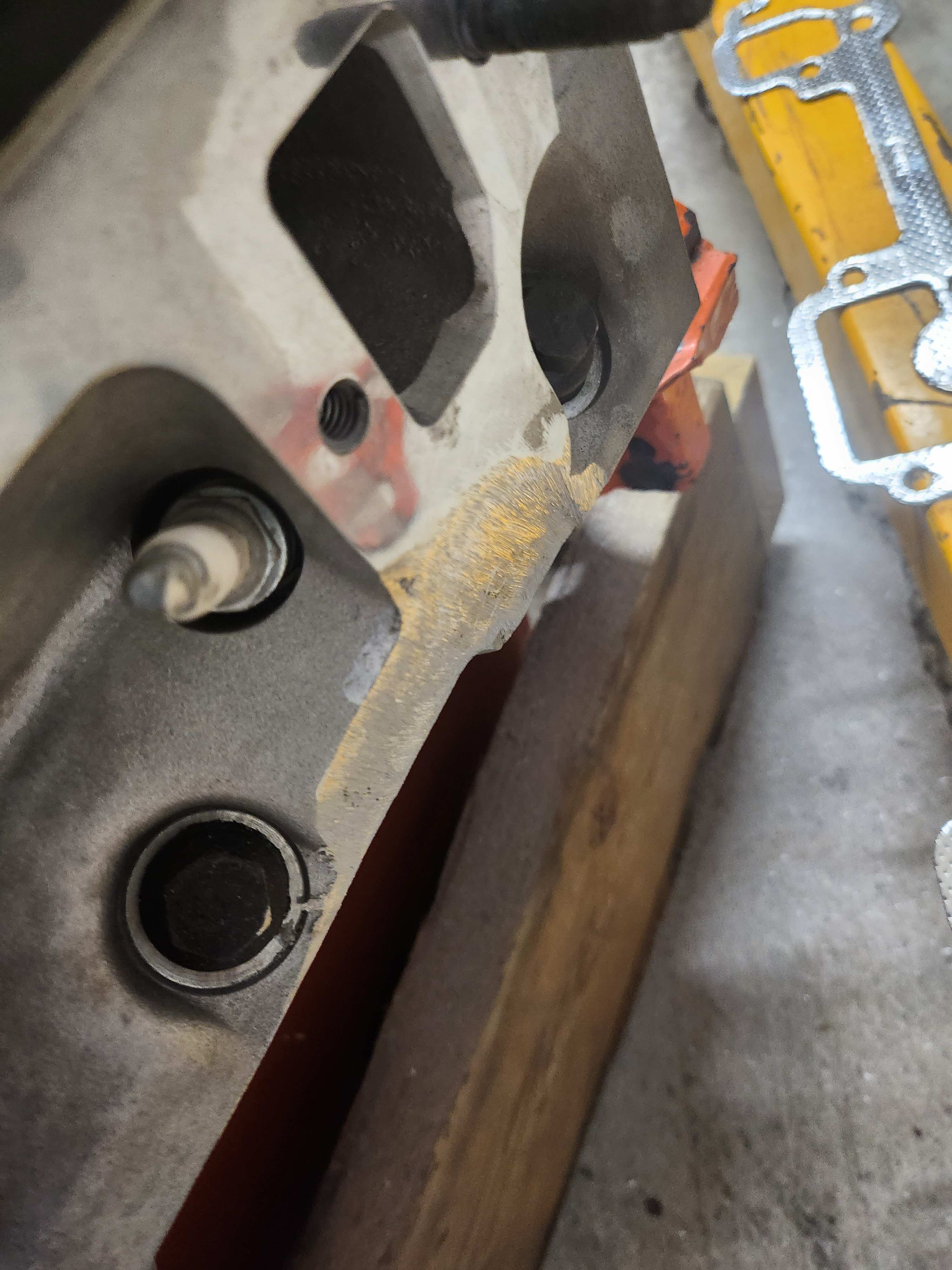

I had to grind a bit of clearance in to the Edelbrock cylinder heads when I fitted the TTI shorty type headers to my 340 engine.
I suggest a trial fit next time - the heads have a fair bit more material along that bottom edge.

Ditto, I had to grind a bunch off the alum head at the bottom lip on the driver side to clear one of the header pipes.

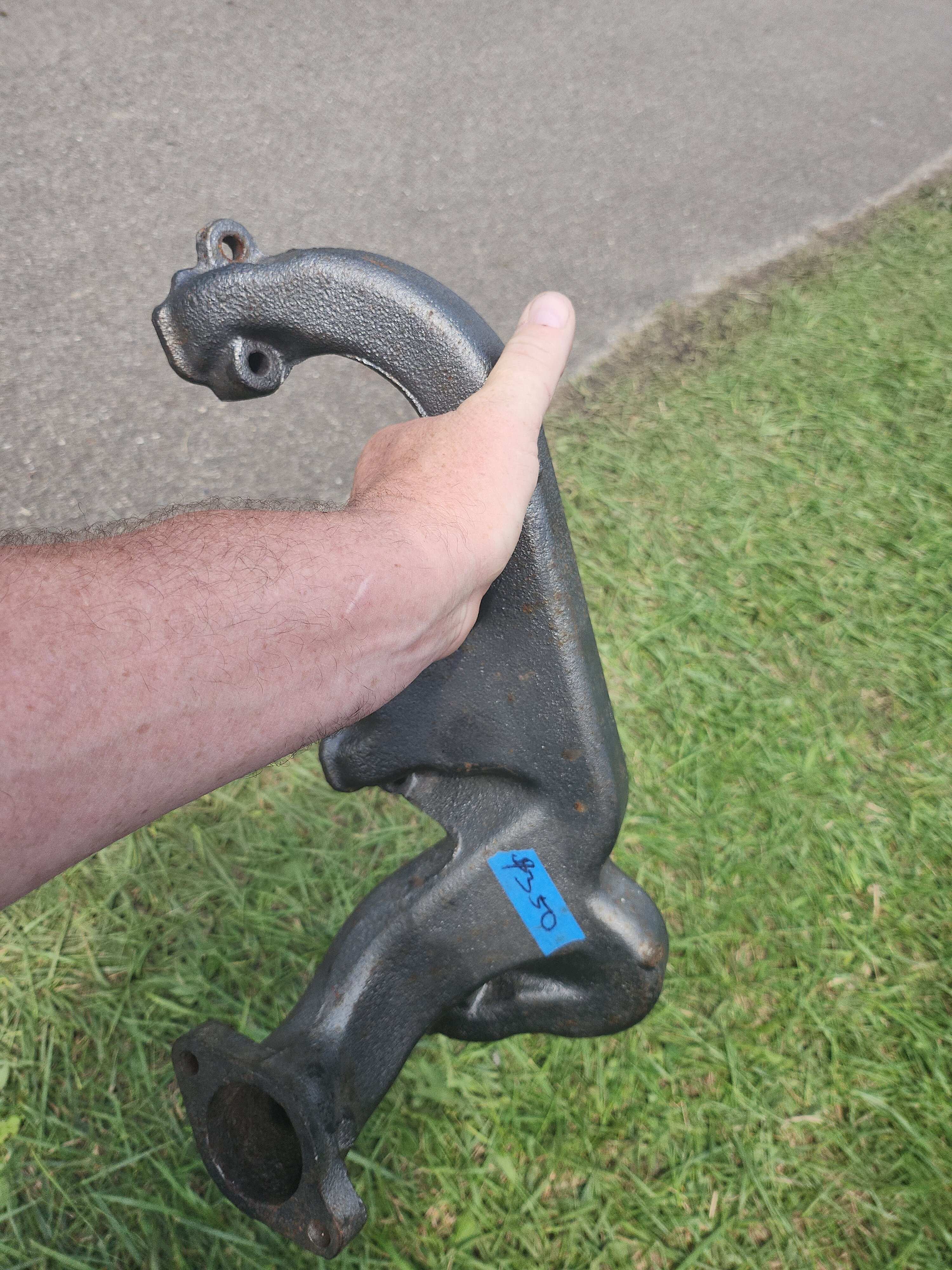

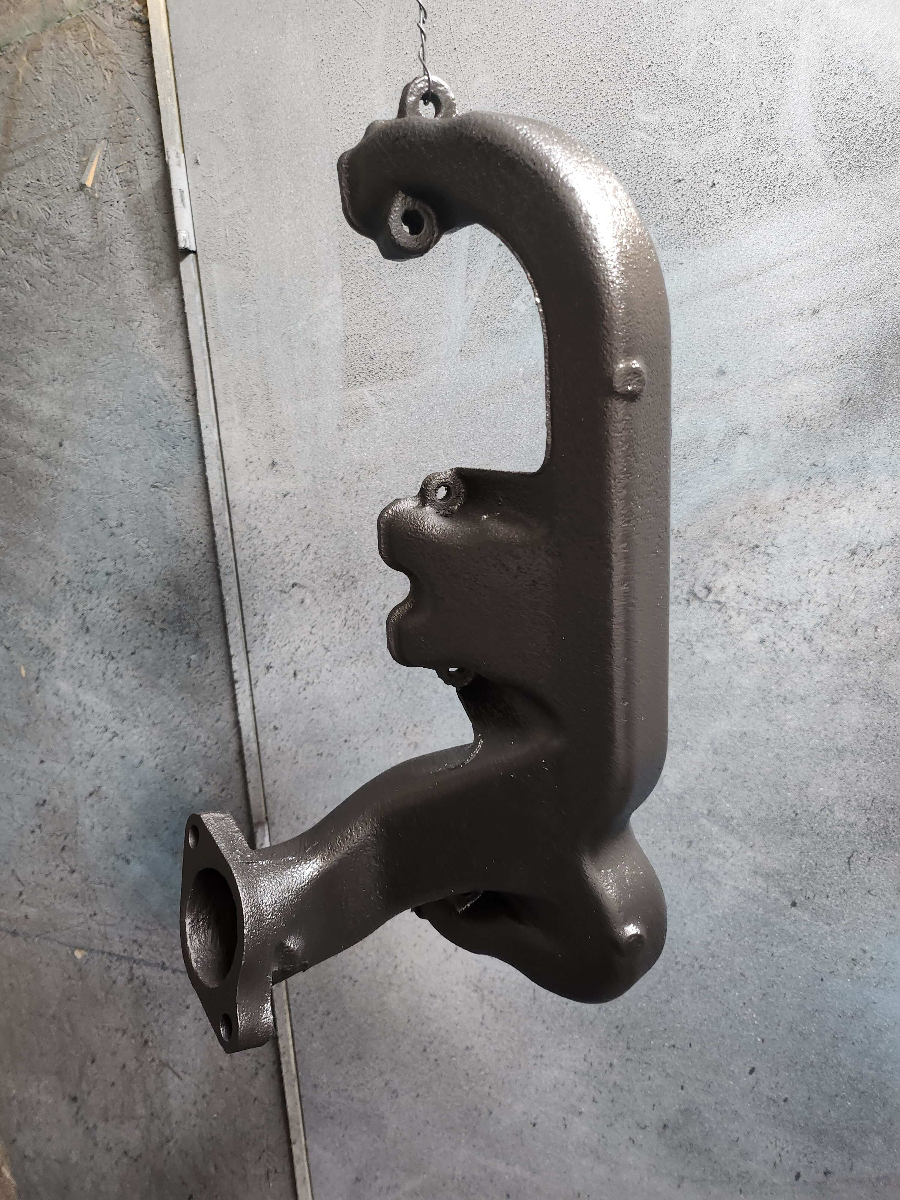

well found the first one woman wanted 750 would not come down at all so searched for about 2 hours was coming to the end of the swap meet about 6 to go found a pair guy wanted 850 for the set. walked to the second to last space there it was guy asking 350 offer 300 took it and ran, was sweating it for a bit. got home blasted it acid and nikel phosphate dip dried it and painted ready to install tomorrow. Grandson will be here in the morning should have the motor and trans install no problem, just have a little cleaning up underneath and ship it. ground the aluminum head away last night a good fat quarter inch was taken
at its deepest point. Sits just flush with no binding without a gasket.
