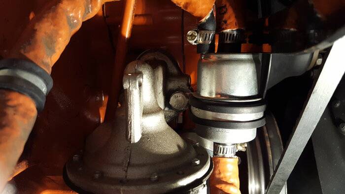

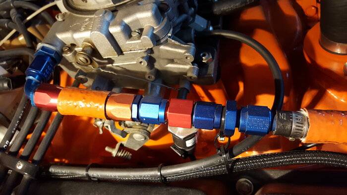

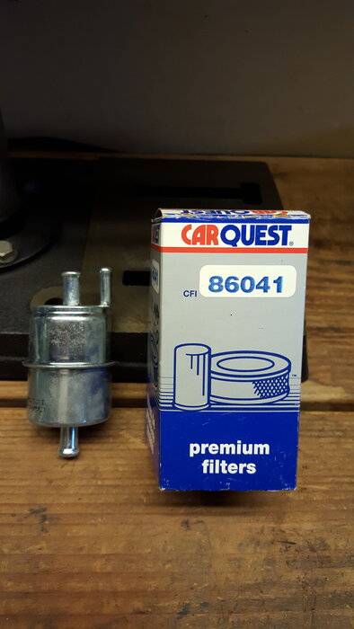

I cured my vapor lock problem, but kept my mechanical fuel pump. My setup starts with the installation of a fuel pick up from Mancini Racing, that allows a 3/8" supply line and a 1/4" return line. Stainless lines from Inline Tube connect between the tank and a vapor separator fuel filter from a GM application. Earl's Supply insulation covers the fuel lines near the motor, and a 3/8" thick phenolic spacer is under the carb.
