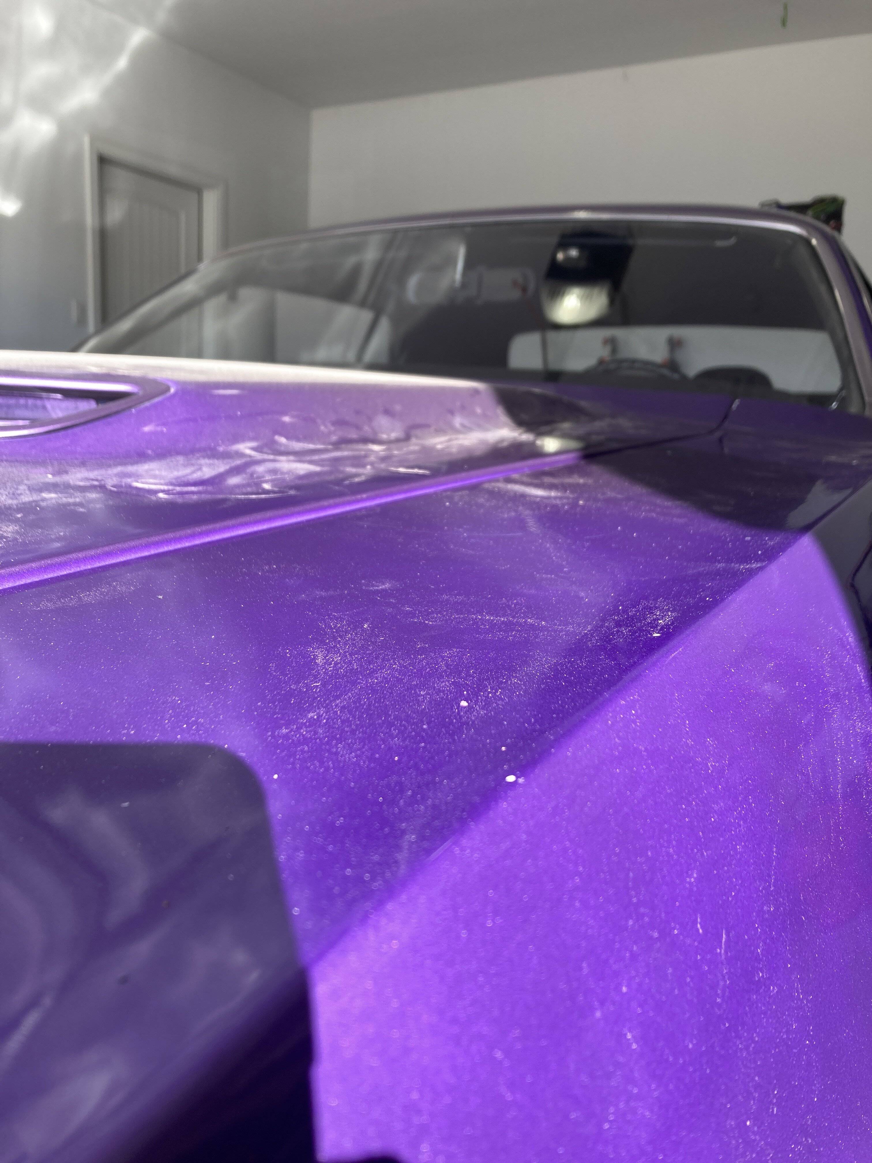

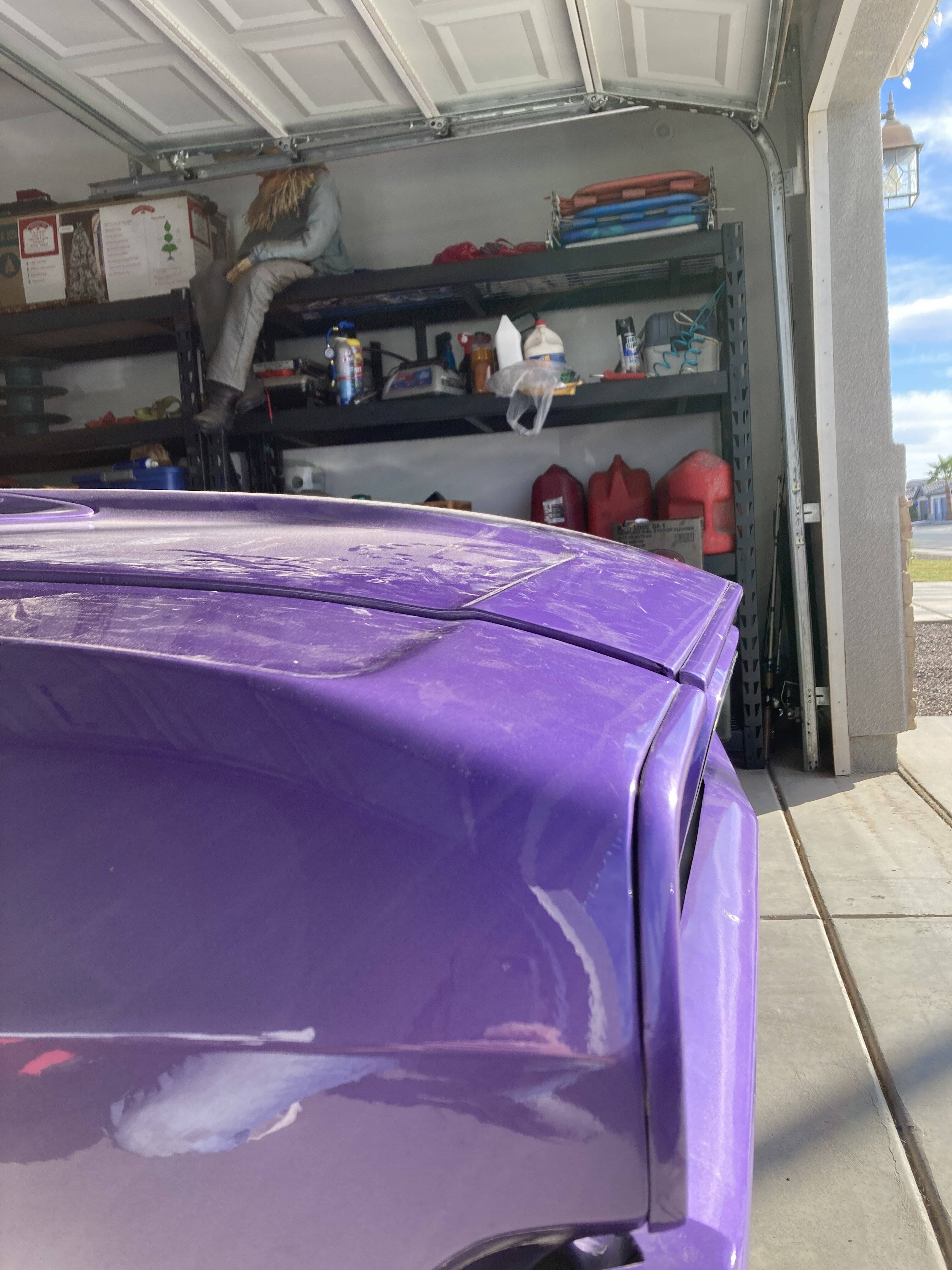

I have aligned my doors to the quarters and my fenders to the doors. The hood has been adjusted to the fenders. The issue I have is that when I close the hood, the front of the hood sits up about 3/8” on both sides. The back of the hood sits where it should. I suspect that the hood might possibly be hitting the radiator which is aftermarket. The previous owner had modified radiator support to fit 26” radiator rather than using the bracket. The radiator cap sits above the radiator support maybe about 1/2 to 1”. I know it’s hitting something because the front of the hood isn’t even touching the bumpers. There is currently no shim between the inner fenders and the fenders themselves. Is it possible to shim the fenders that high without moving the body lines that far? I was thinking about just shimming front halves of the fenders to sit at the right height. What’s your guys thoughts?

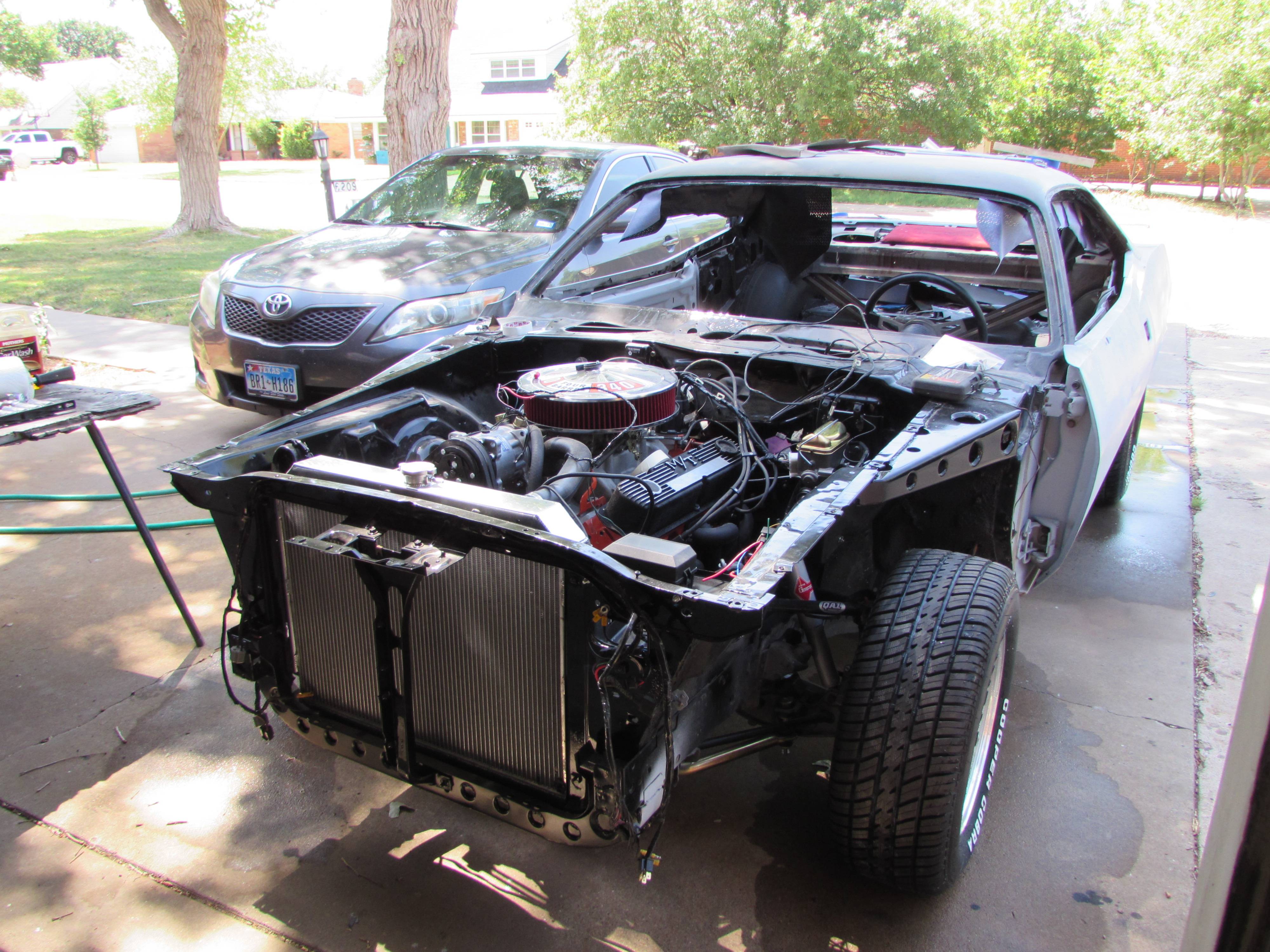

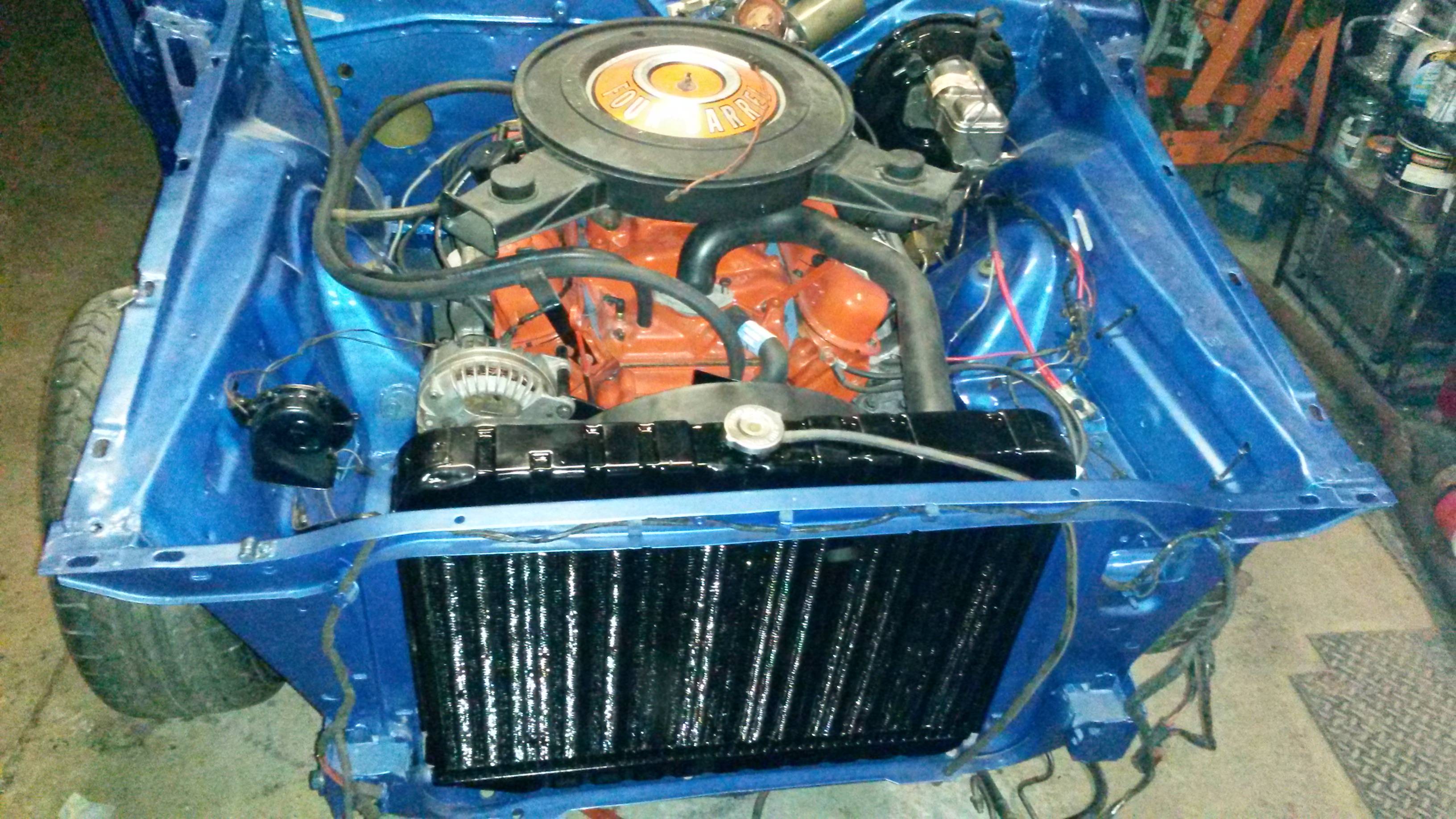

My aluminum radiator sits a solid inch above the core support and the stock twin scoop hood fits fine. This is the best picture I have showing the height of the radiator.

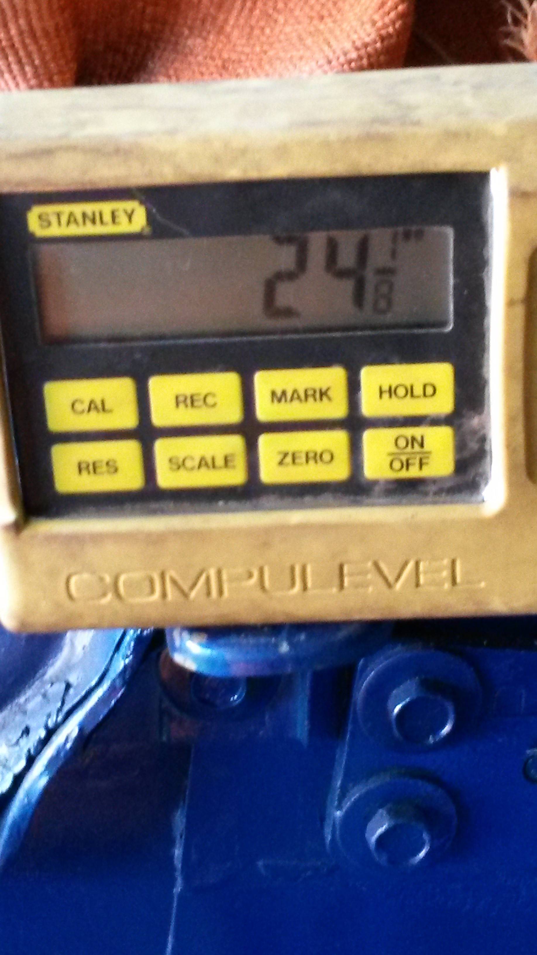

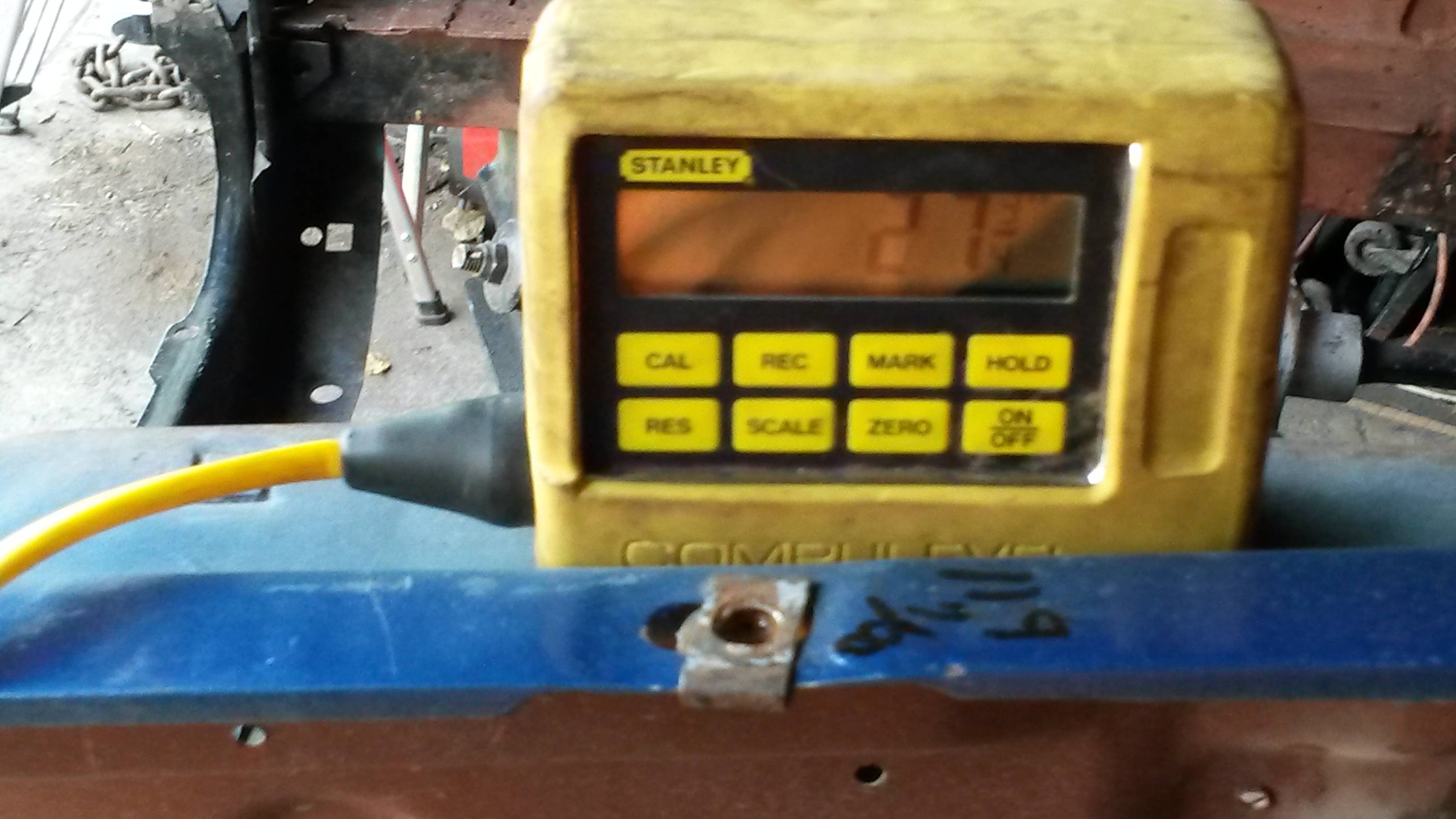

This might be a help.
The measurements are with in an 1/8.
Something simple hood latch?

Can you push the front corners down to the fender? When you push down on one side what does the other side do?
Cory
Mar 27, 2016
25
Yeah I can push each side down and the other side rises. When I let off pressure, they return to 3/16” gap on both sides.

I second that on checking your latch and adjust as necessary. Also check your front bumpers and adjust the screws on them as necessary.
Cory
Mar 27, 2016
25
That was it. My latch was too high and the bumpers were too low. It’s not perfect, but it is way better. It’s about an 1/8” high now on both sides rather than 3/8”. Now I have a starting point to adjust at. Thanks for the help guys.
