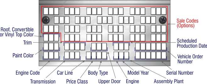

I tried decoding my friend's fender tag on his 71 Challenger convertible and there's some ambiguity.
See attached. He does not have the broadcast sheet unfortunately.

You won't likely find any historical data on Vehicle Order Numbers, such as the K40000. The details of the special order are on the broadcast sheet and window sticker.
Y39 simply means it was a special order (by a specific customer) rather than ordered (and optioned) by the dealership hoping to find a buyer.
What items are you specifically looking to identify its color? The top? the body? the interior? the stripes? This body code plate lists several colors.

What are your specific questions? Any items that you think are ambiguous or uncertain of?
The tag has all indications of being the original tag and not a reproduction tag. I have images of Challenger other fender tags from September 1970 (1971 Model Year) and many of the misalignment issues on the posted JH27H1B166122 fender tag are also present on them.
The 999 paint code could be any color, even another manufacturer's color. You should be able to find the color somewhere hidden on the car.

K Von is special order or special order police. Both Y39 and a special order police with Y35.
Interesting that the VON number is an even 40,000.
999 is quite uncommon. Sure would like to see a broadcast or build sheet for JH27H1B166122
