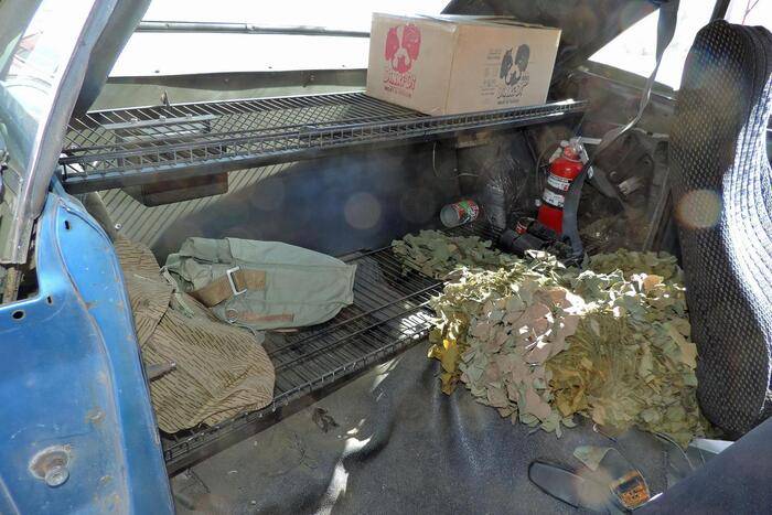

I use one in my 81 dodge van. Installed behind the captn seat.
My dad used to have one in his car, in the driver side foot well, On the kick panel, it was a small canister. I asked him one day, why in such a bad spot!
He said
1) it's handy,
2) it's in sight (in a moment of panic one could forget a lot of things.
3) but most importantly, the can is in the same place as in a C-130, so no need to remember the location of the extinguisher.

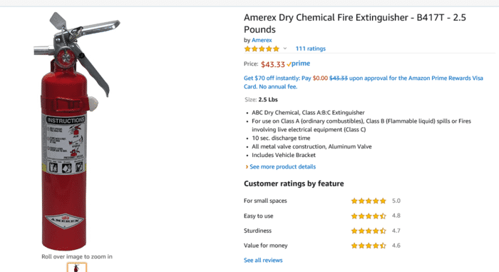

I just bought one of these...….keeping it in the box and putting behind the driver seat for quick access (I made sure I can open the box flaps easily in case of emergency).....since it's in the box it won't roll around to much (I hope)......afraid if I put it in the trunk I won't get at it in time (fumbling for trunk key)...….it says it covers class A,B and C
If I have a rear seat passenger, I'll just temporarily put it in trunk

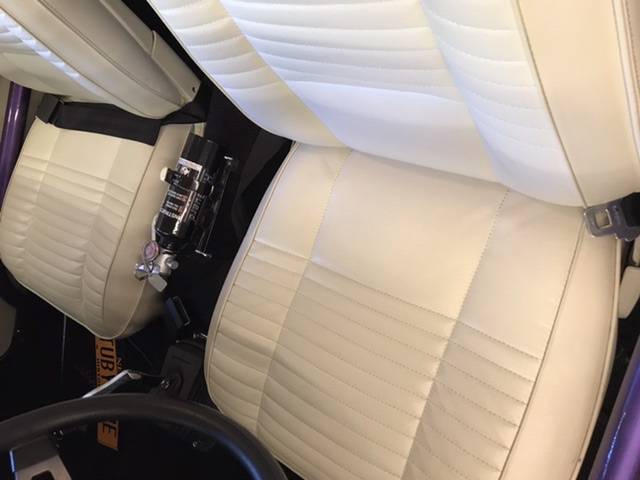

Mount it to the trans tunnel. Most come with screw on brackets. If you are going to have one, just like anything else you need to do a few drills on what to do when you need it. Stress does funny things to people, that is the purpose of doing fire drills, escape plans for you and family ( you have one don't you?) in case of a fire or ???. Years ago I was working in a pit cutting the exhaust from an import car when I burned a plastic fuel line. As the fuel was draining out of the line into the pit,that was now burning and spreading because of the burning gas, I grabbed the big fire extinguisher that we had in the pit and couldn't get the safety pin to come out. I didn't realize that I was holding the grip so tight that the safety pin was jammed and wouldn't move until I relaxed my grip. Never forget that one. Keeping it in the box is like keeping your gun unloaded and in the safe when you need it. Just a thought. And get a bigger or another extra extinguisher. Better to have more than you need than the other way around., More expensive stuff like Halon won't fill your car full of white powder.
