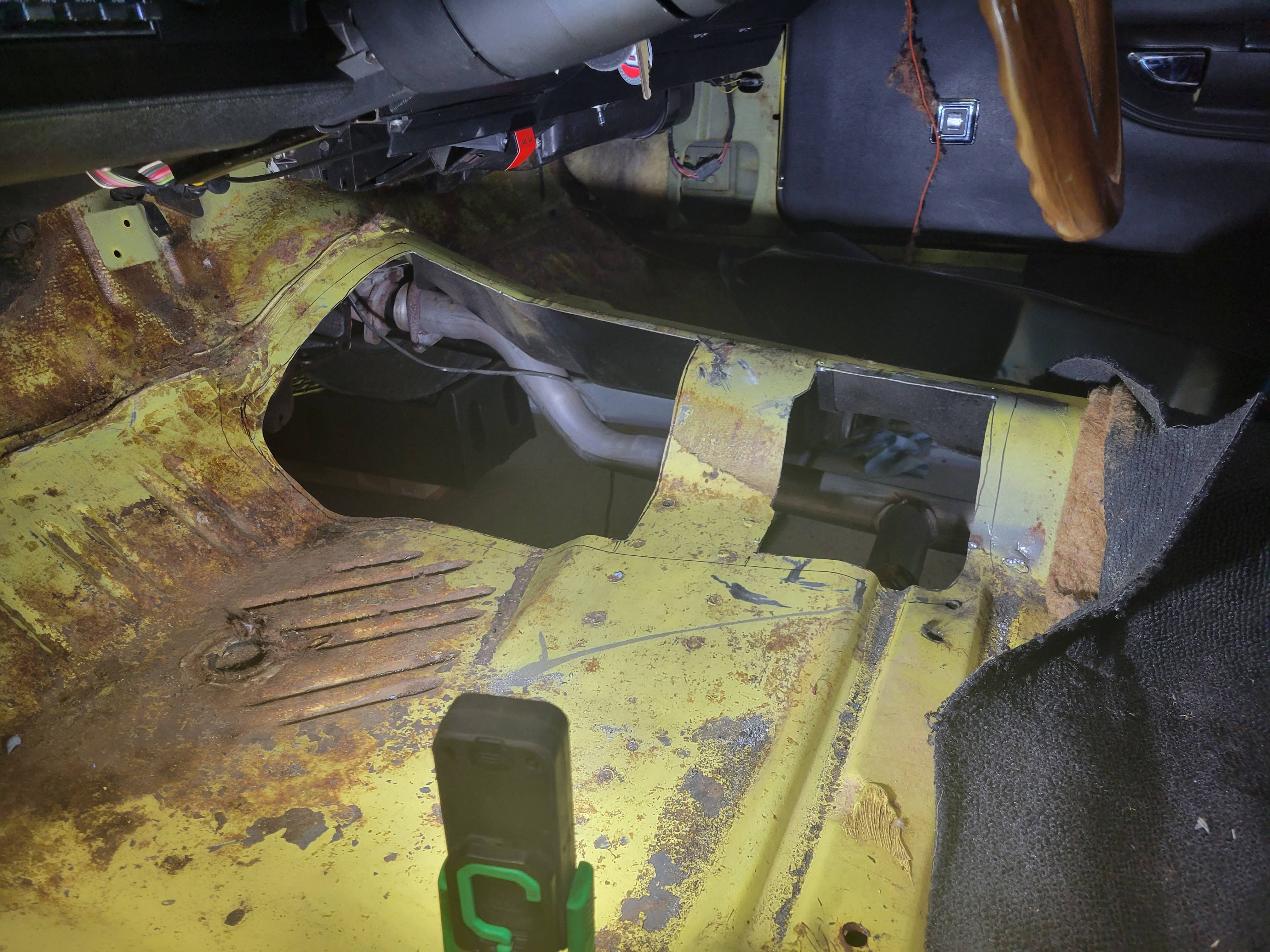

Thanks. I asked AP if they machined the case for E body installation. They replied stating not the case but the tail housing (and that SS does the same thing).
My Cuda is in metal work phase now. I'll mock it up with the trans to see exactly where I need to cut the floor. I'm converting from automatic to manual.
Mine is all the way up and it is 4.1 degrees down at the tail. Should be less than 3* is what I have read
I don't remember my numbers but with the hemi on stock mounts, tkx using the SST trans mount the have the 1/4" spacer lifting the trans up im within .75 of a degree and 0 vibration.
