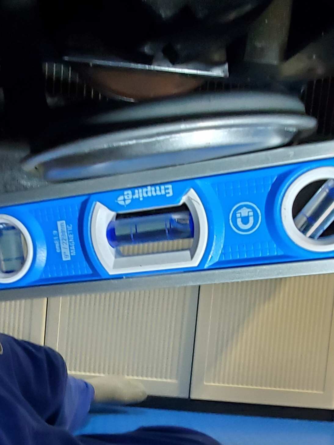

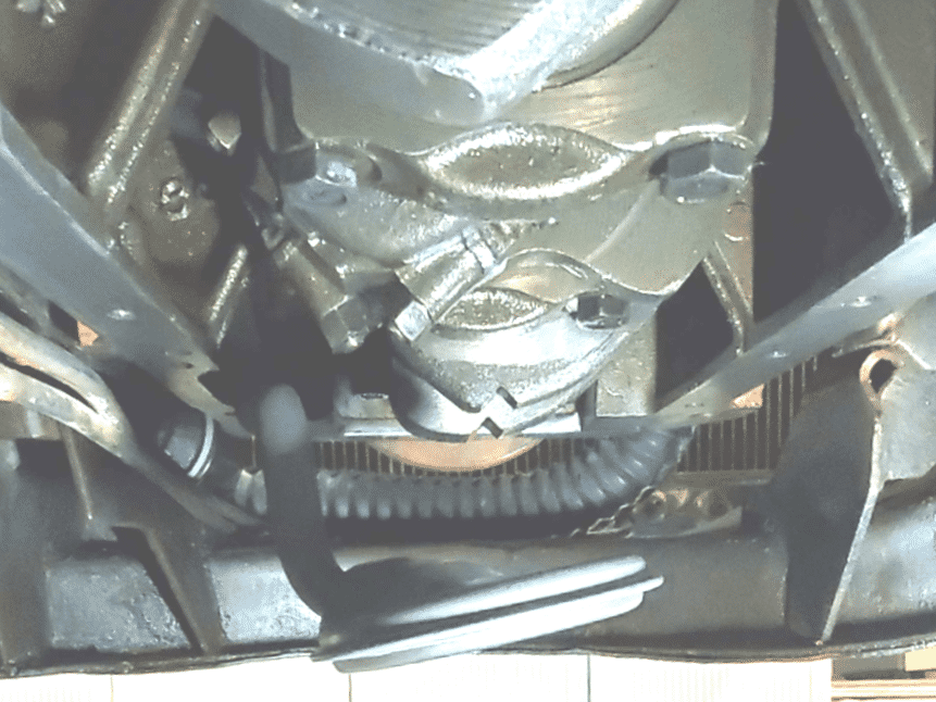

I just tried to test fit the tube and pan , looks like the tube is crooked , I have done it twice , any info on these , it's in the center of pan I think , hard to do on the ground.
7DCUDA383A
Sep 11, 2024
171
44
60 Miles West of STL
Is it reasonably level with the block rail at "any" point of a thread revolution?
The longest point from the rail is 4.25 in and the shortest is 3.5 , I know it says the tube can make contact at the bottom of pan but the part that sucks is like an inch of the bottom of pan .
Daves69
Feb 4, 2014
345
116
ChiWest
I wouldn't use that pickup as is. Bending the bottom to conform might breach the screen and allow too large of particle into the pump and lock it up.
I might try bending the tube a bit out of the engine. I'm not suggesting you try that though.
Maybe someone else has dealt with this and will chime in.
