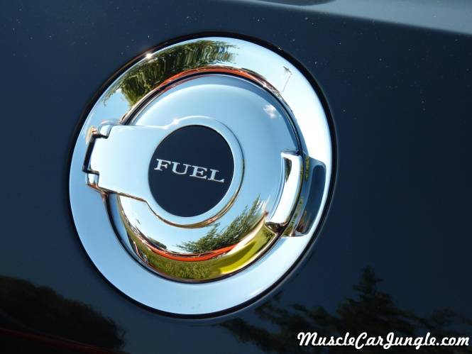

I suppose you could use a challenger tank & fill tube & work it into the 1/4 panel or are you just thinking of center rear hidden by the licence plate ?

Will need the section of the Challenger quarter panel That the cap mounts to, to be grafted to the Cuda quarter. The Challenger has a hard bodyline and a lot of curve to the panel that the Cuda does not have. Almost flat ( convex as opposed to concave on the Challenger) on the Cuda. The body line ridge stiffens the panel and adds some impact protection to the cap/ filler area where the cap extends from the panel. I guess you can photo shop what it might look like. Anything can be done with metal...

Anything can be done but I would do it with a Photo Shop program first to see how it might look. Actual racing fuel caps were usually flush mounted to the top of the fender like the Charger, Corvette etc... You might want to graft a Charger or modern Challenger filler cap instead of a 70-71 Challenger type that stick out on top of the fender.

Yup, I'm aware of the challenges etc, just hoping to find examples of it being done if any. I think the hard line on the challengers make the raised cap seem not so intrusive, but on a Cuda with the soft curve, it might look like a wart. Been thinking and looking and it seem the newer style would work better. What sparked this was seeing a 69 barracuda with one, then a day later seeing a flip to off of Mazda of all things. Has a gentle curve and sits flush. Again, it's just crazy neurons firing....

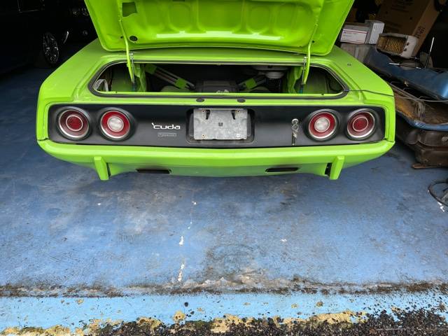

I put one on my Cuda but its over the original filler behind the license plate
I was going to ask you the other day when you mentioned it on another thread, but do you have a picture you could share? Little details like that or the recessed indicators are the kind of things that really set a car off for me. I have several things I want to subtley change on mine.

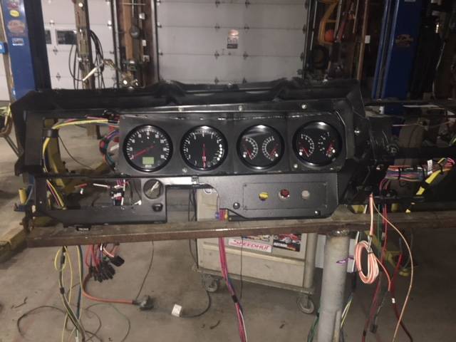

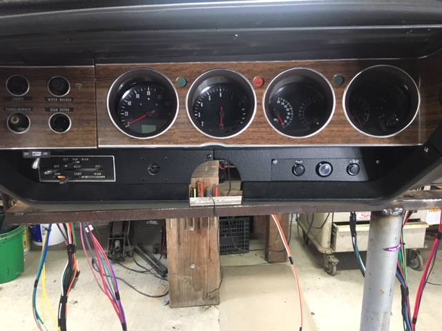

I will go out and get a picture. This car has a ton of "small details" which is why it took me 14 years to get it done, I kept coming up with new "cool" things to do... I insisted in building my own instrument cluster but I wanted it to look somewhat like a stock rally dash; this turned into a long effort with several false starts (read failure). I was finally able to build the cluster using Speedhut gauges and I really like the result. If I were going to do it today, I would probably just buy a Dakota Digital set up.

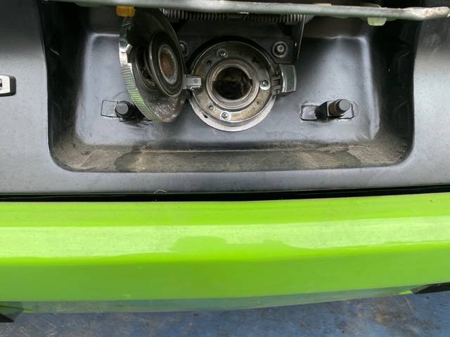

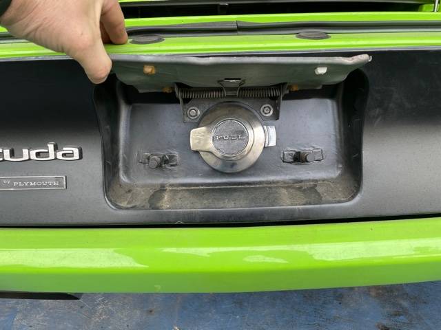

As promised here are some pictures of my flip lock
View attachment 78447View attachment 78448

Thanks. I used a Charger flip top, a Challenger one is probably going to be too thick where as the Charger or even an A body Cuda one is a lot slimmer and will live behind the license plate bracket.
In order to get mine to work, I did have to open up the hole in the cap a little (very little actually), I think made up a pattern so I could ID the factory screw holes for the Cuda, then transferred them over to the cap so I could use the original screw holes on the Cuda. Its actually pretty straightforward. While I did alter a lot on this car, for this deal you would not have to, the cap can sit right over the top of the factory Cuda filler tube and use the original screws.
