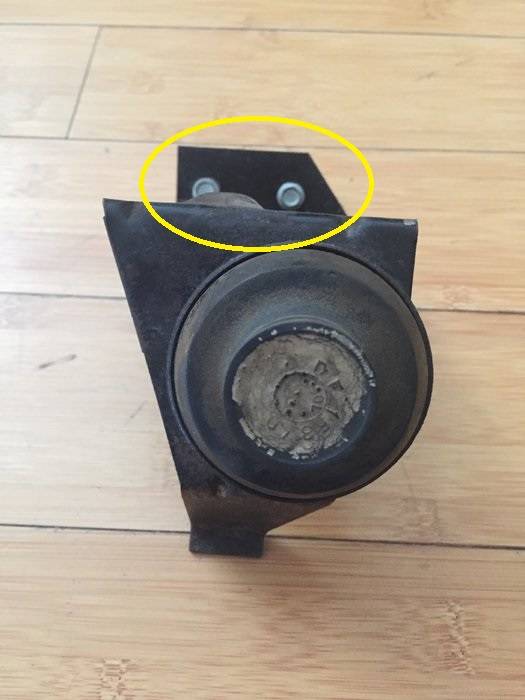

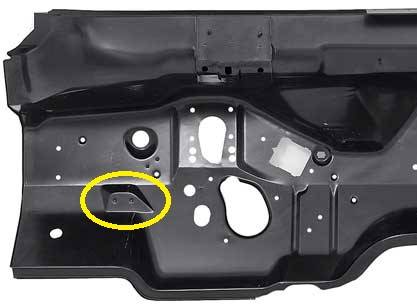

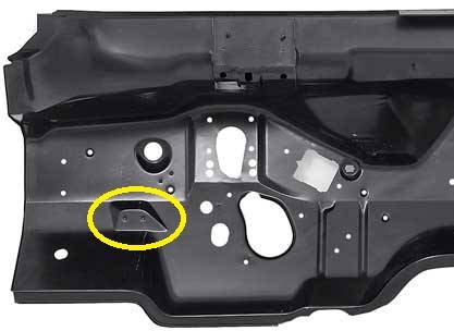

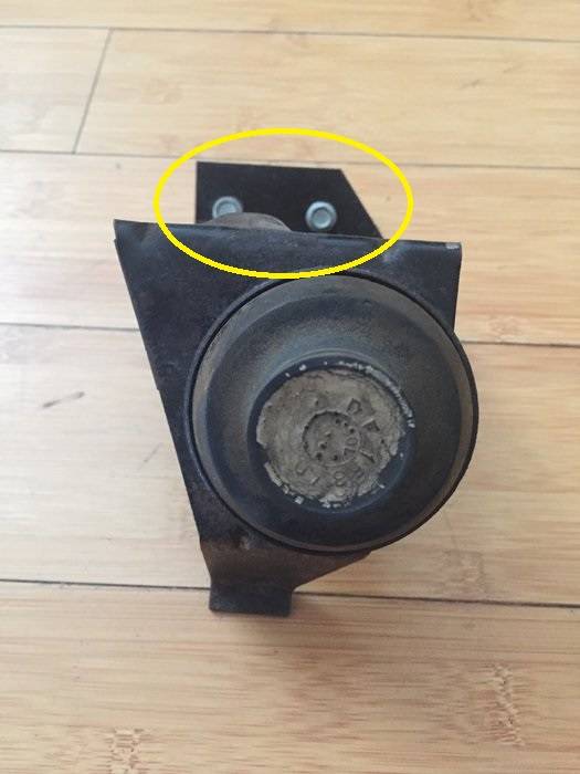

I believe the firewall metal had the dimples for the foot pump mounting bolts and drilled out, as needed. The inner fender covered that area from view in the engine bay.
Jim
