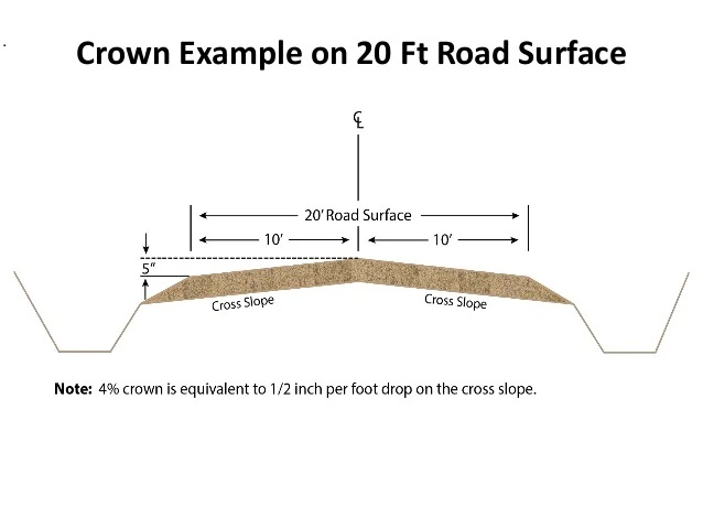

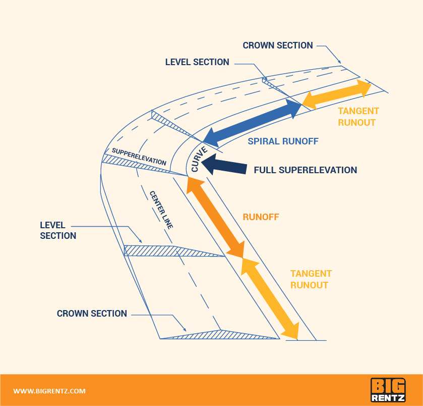

I have to agree with XCUDAME on the toe. I have moved roads and bridges. One had a super built in. I'll show a couple examples.
Way back( when nylon tires were thing. thumped y thump down the road you go. Anybody that had them knows.) someone that rebuilt cars explain the reason why a car is aligned the way they are. it is to compassionate for the crown in the road for water run off. I would question him why no toe. He might have reason. Try it it might be ok.
On the 1/4 mile track 0 toe is faster. If I recall right.
