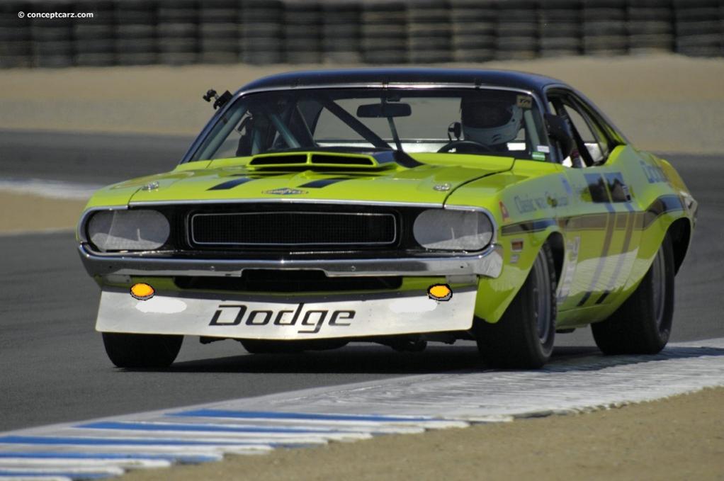

Been looking for somebody who reproduces the front spoiler used on the Trans Am cars with no luck. The 2 piece repros are not enough for me. I heard there might be somebody in So Cal but can't find anything on the internet.
Also considering a front chin splitter which seems an improvement from just a spoiler. Found one video from Lengendary Cars who custom built a 200mph Cuda. Anyone with any info?

Your wanting a Sam Posey-Trans-Am style right? I've been sort of looking for that too. Couldn't find anyone? Doesn't look all that hard to make though?

the 'cuda has a different front valance. It would block the parking lights/turn signals on a challenger. AND it has a different profile. Hellooooooooo!

I was thinking of something fender to fender but under the valance so as to not block turn signals. Also considering a spiltter. If you go to Utube and look up 200mph Cuda, Legendary Motorcar built a splitter that looks possible to copy, they have plenty of pics of their build. tried to copy one here but couldn't

possible but I have to be careful my front valance is fiberglass, wouldn't take the stress. Underneath it and I could add back bracing. Really thinking about the splitter. looks simple enough, made a cardboard prototype.

This new post is very promising, something I have thought about. For me the downside would be labor, as I have no place to work and limited skills. Also found that Sandy's but wondered if it was too small to be effective for racing.
The splitter on the Legendary Cuda looks so easy to copy, must work they went 200mph+

When I got my car the shippers wrecked a lot of stuff, the front valance being one of them. ( long story) It wasen't that bad so I just hid it with a licence plate bracket. My car was from CA so it didn't have one. So if I was going to do one it's not so bad as the front valance needs replacing anyhow. The front spoiler should be easy to make it's just a flat "plate " more or less. It's the brackets that suport it that would take a little bit to get right. I would use small stainless button head cap screws so they look like rivits?
I just can't decide if I really would like it enough to have a go at making one.
