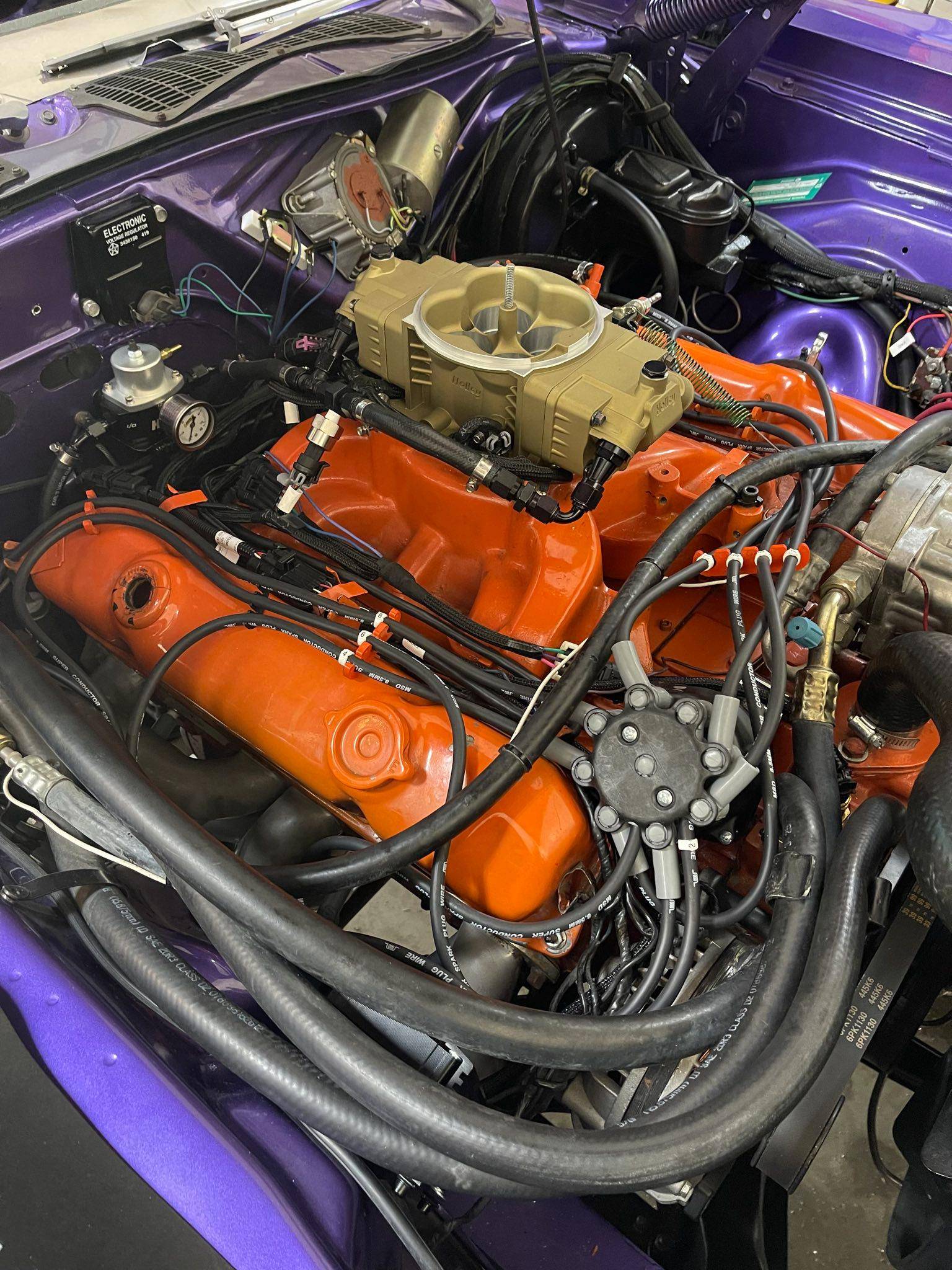

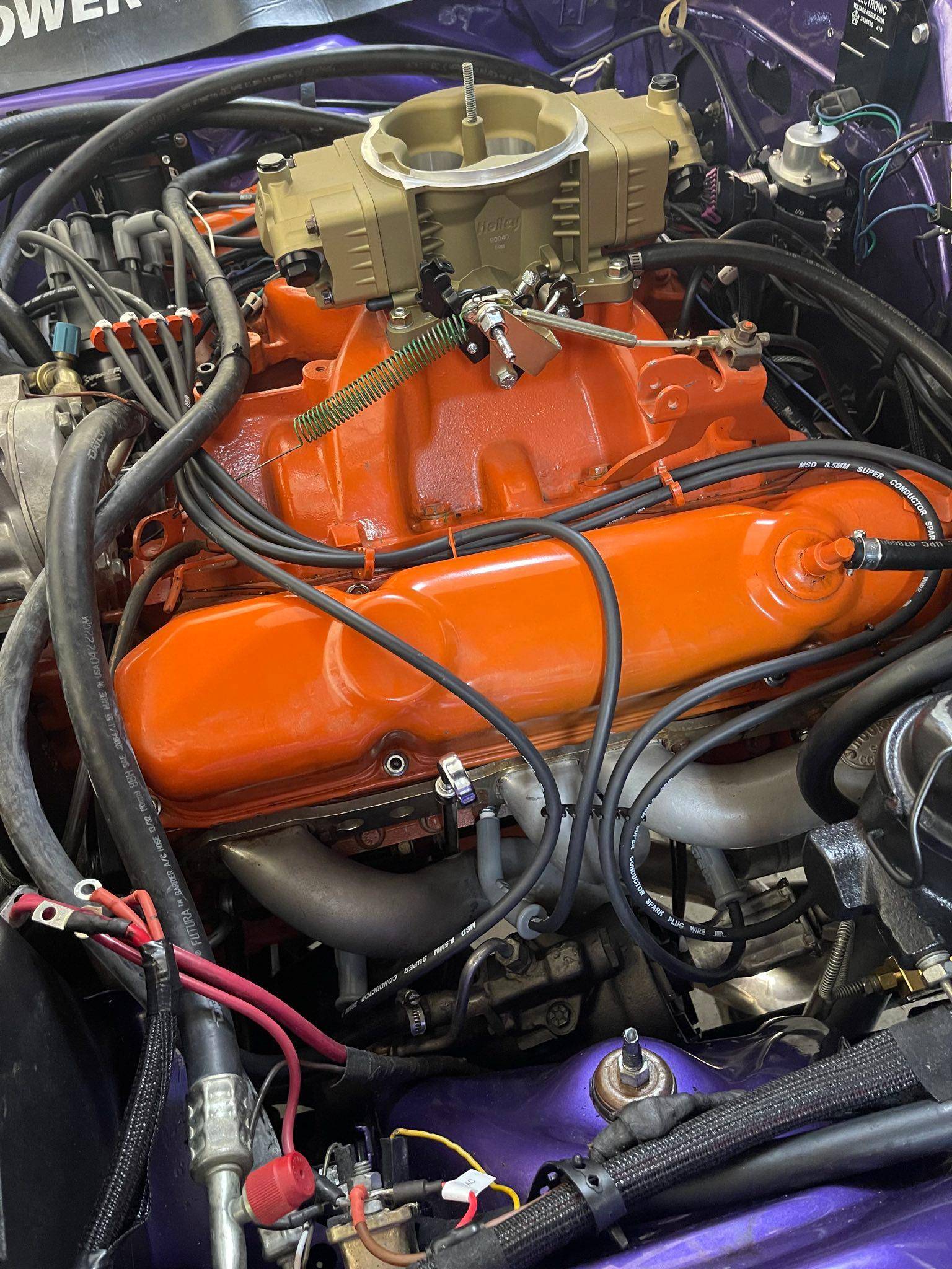

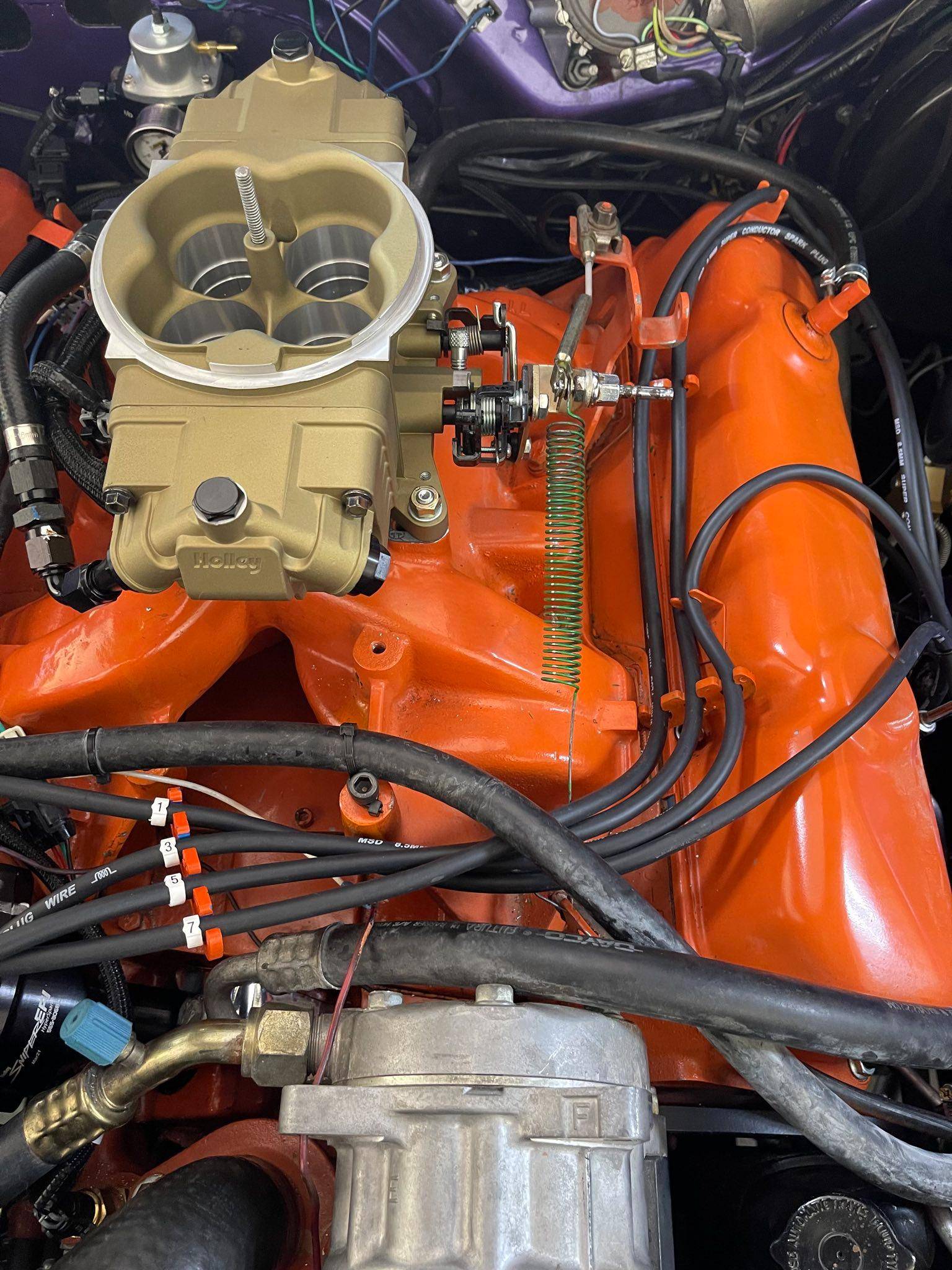

The EFI setup I purchased and installed is the Holley Terminator X Stealth 4150. Not MPFI but a throttle body which allows you to use your existing manifold, either dual-plane or single-plane, and keep the original look of a traditional carburetor. The biggest plus of the Terminator X versus the Sniper is that the computer is separate on the Terminator X while the Holley Sniper system has the computer built into the throttle body. Hot engine compartments do not play well with electronics so I mounted my Terminator X computer under the dash. With a Sniper system, that is not an option.
Also, going to EFI is way more expensive than it appears. The entire fuel system should be upgraded and include an in-tank EFI pump in a properly configured tank. The fuel supply line at 3/8" ID and a return line at no less than 5/16" ID are necessary to maximize the benefits of a pressurized fuel system. This essentially eliminates fuel percolation a.k.a. vapor lock. Additionally, the electrical system should be addressed with "clean" power for the electronics. And last, but not least, timing control via the EFI system is one of the greatest benefits of a modern EFI. That potentially requires a new distributor and a quality ignition system (high output box and a performance coil).
This is one of the best projects I have ever done to my Cuda and gave me fast starts, unbelievable throttle response, superior drivability, and ease of tuning.
Good luck with whatever choice you make.
