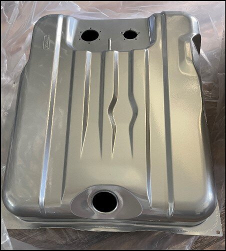

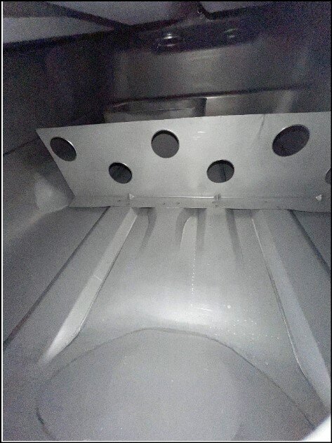

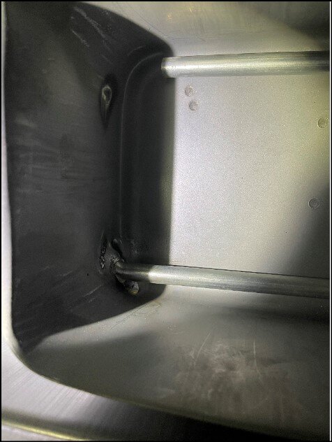

Holley uses Tanks, Inc. for their tank kits. You can save money ordering the Tanks, Inc. tank, pump, and sending unit.
I purchased mine from EFI Systems Pro and requested the floatless sending unit (9" length) which does not have an arm or ball-float.
Pictures are of the Tanks, Inc. EFI Barracuda tank (comes powder-coated silver) with internal baffle and sump with tubes.
