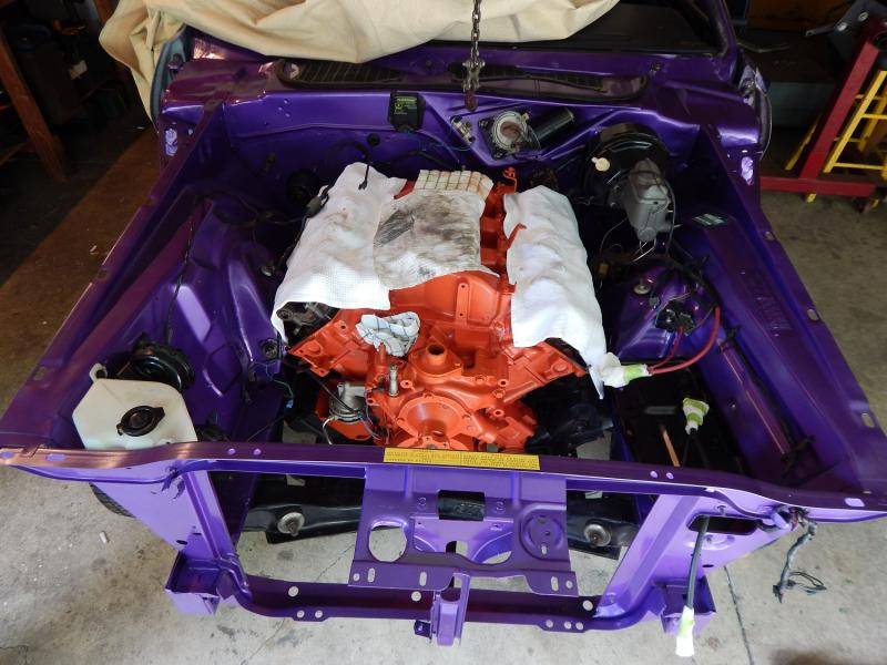

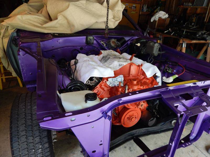

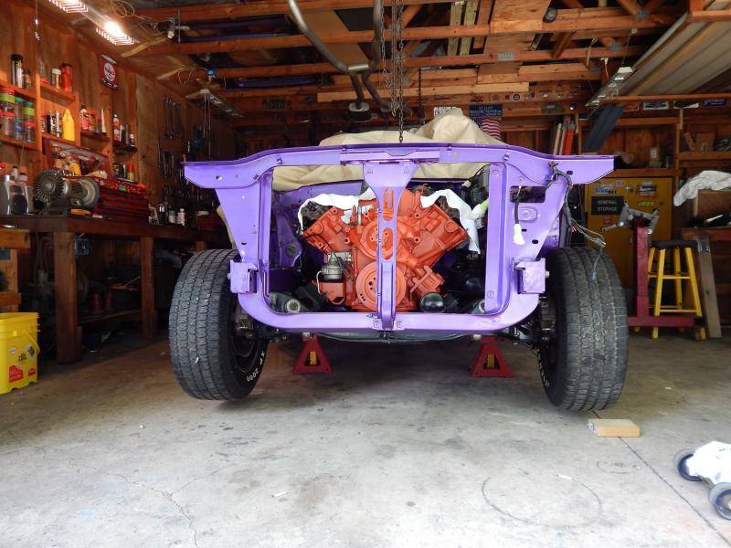

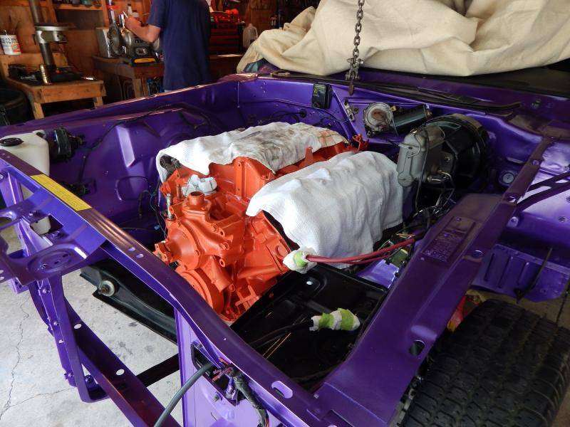

DSCN8861.jpgDSCN8862.jpgDSCN8864.jpgDSCN8868.jpgMaking progress, had a little trouble at first but all is well. New Timing Chain in and the trany next. I should have this thing running by the Fall.
