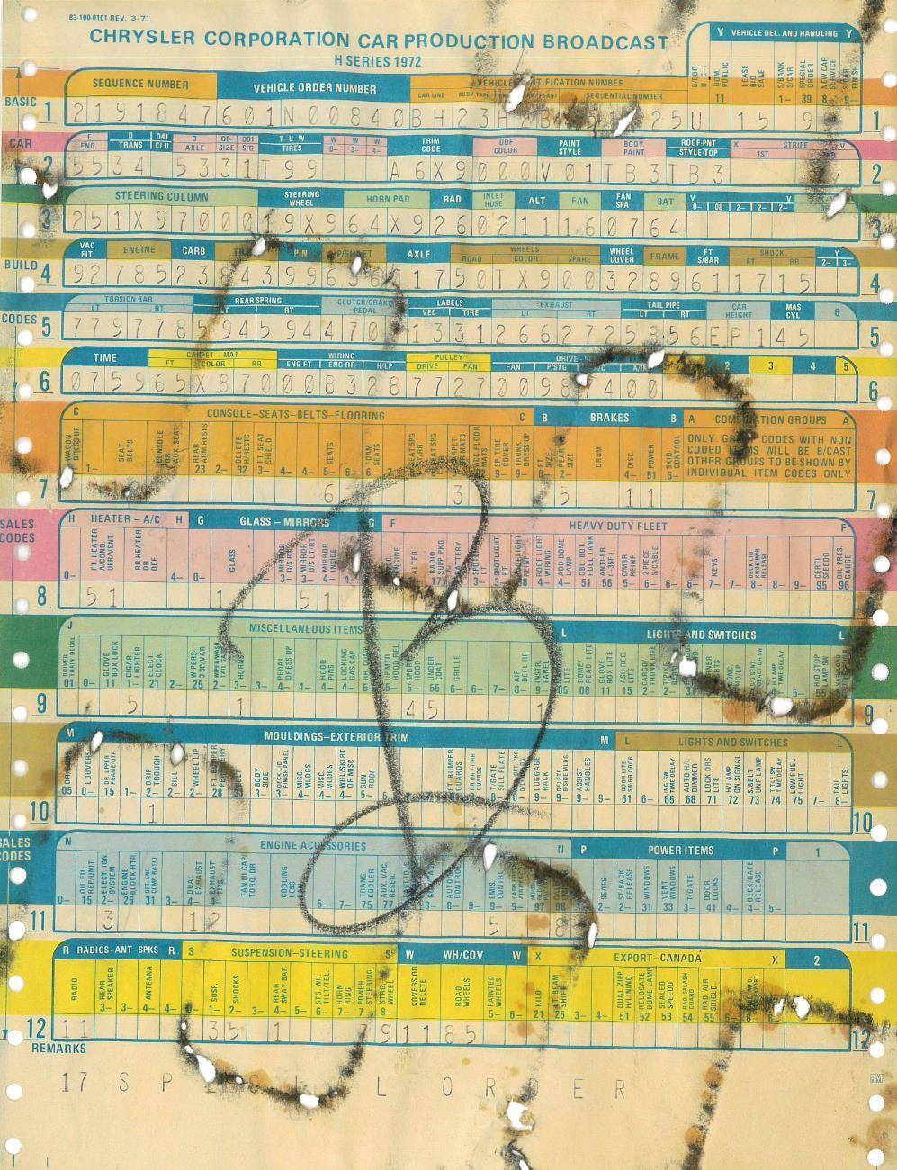

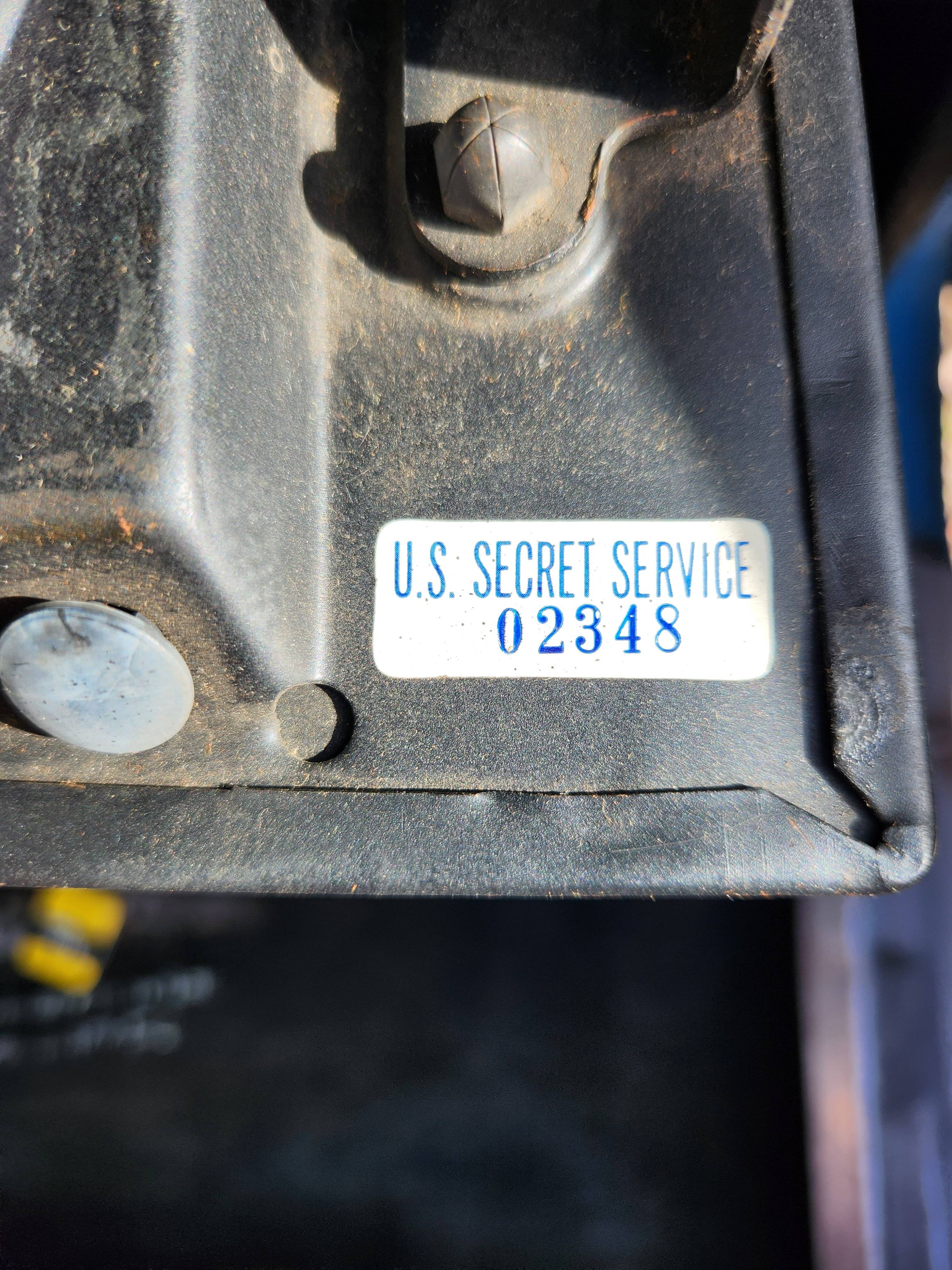

I have been trying to run this down for the last 6 months through other forums and through Dave Wise without success. I'm hoping another prospective will help. When I purchased the car, the owner told me that he had purchased the car from a government auction in St. Louis and that it was used by the Secret Service. It seemed like a fantastical tale, so just I smiled and nodded. However, some clues started adding up. First was a U.S. Secret Service sticker on the inside of the glove box door. When I pulled the back seat and found the broadcast sheet, it had a few oddities. N95 California emissions for a Missouri car. Y39 special order, T99 for special tires, 17 SPECIAL ORDER on the bottom of the broadcast sheet, and an N to begin the VON. All I've gotten so far is "could have just been an auction inventory sticker", "it's unique" and "it's a special car". Back then the Secret Service was part of the Treasury. Has anyone ever heard of one of these being used for government purposes?

I have not heard of the SS using these cars but that by no means is reason to believe it didn't happen.
Let's hope someone can shed some insight on the N00840 VON.

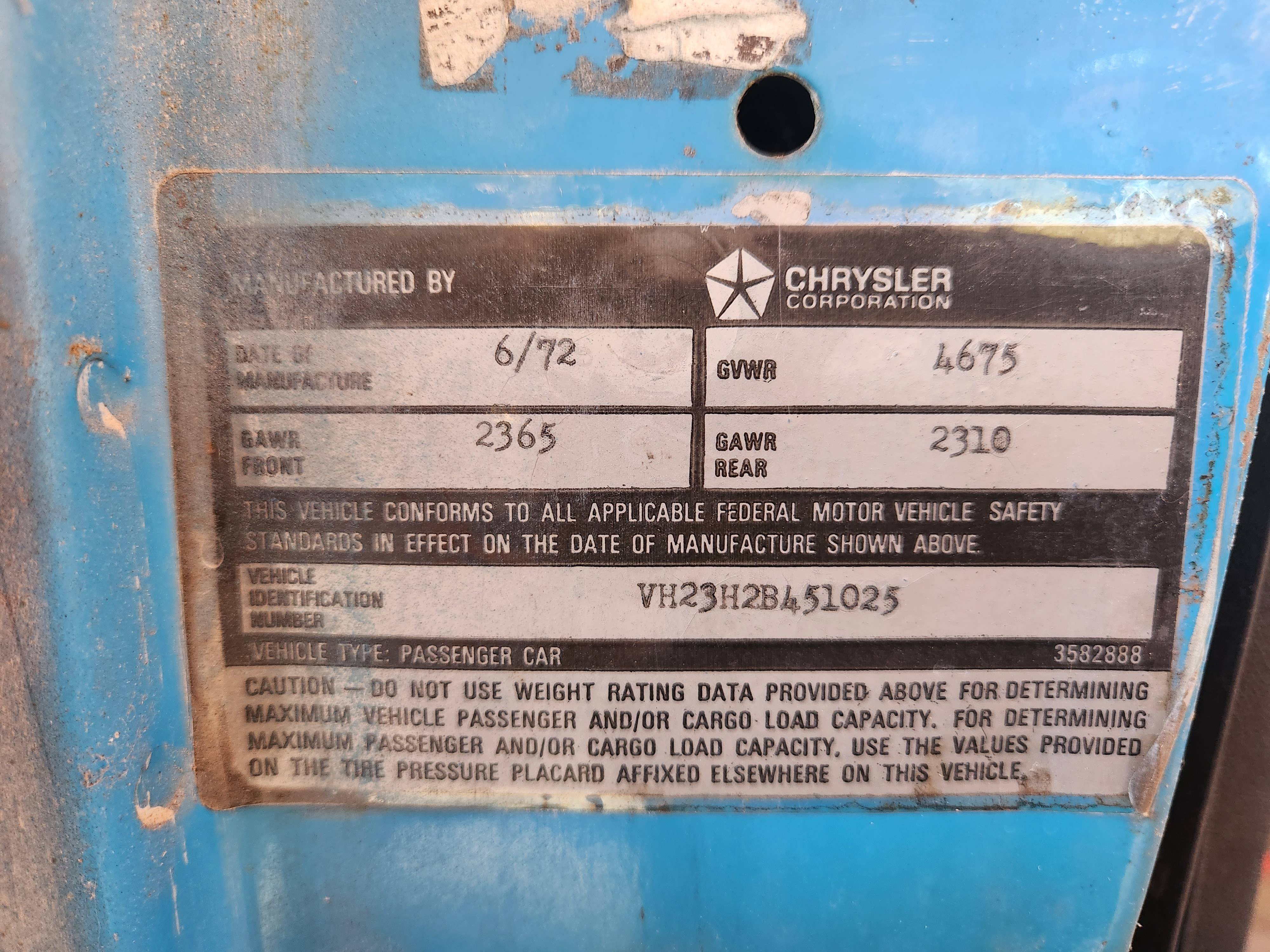

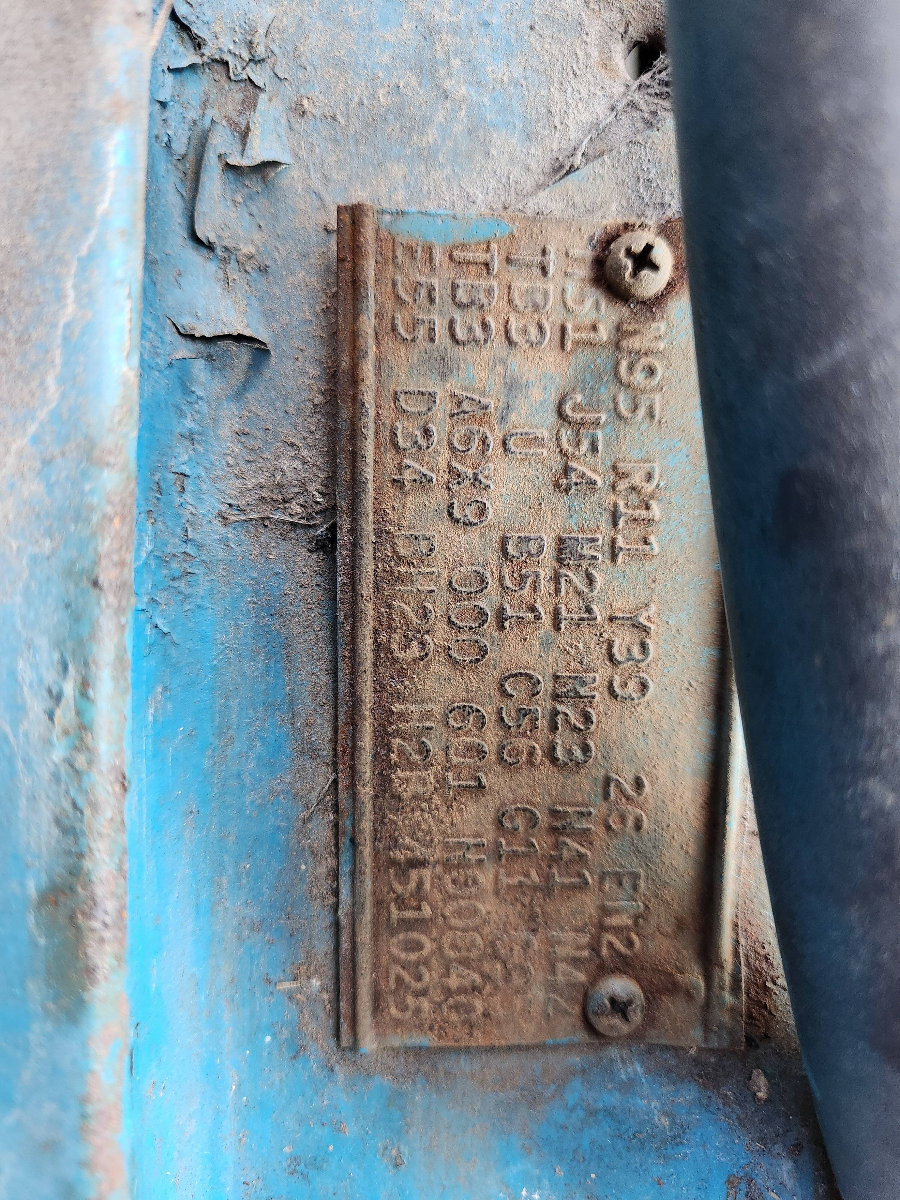

How does the fender tag compare to the build sheet? Anything odd there?
Does the door sticker reflect the same?

At the very least, there was some government object with this sticker on it, and when it started to peal off, someone stuck it on the inside of the glove box. But that's not much a story or conspiracy, I'm afraid. :)
I've transferred a few "property stickers" over the years. Not to my car, but other fun places.

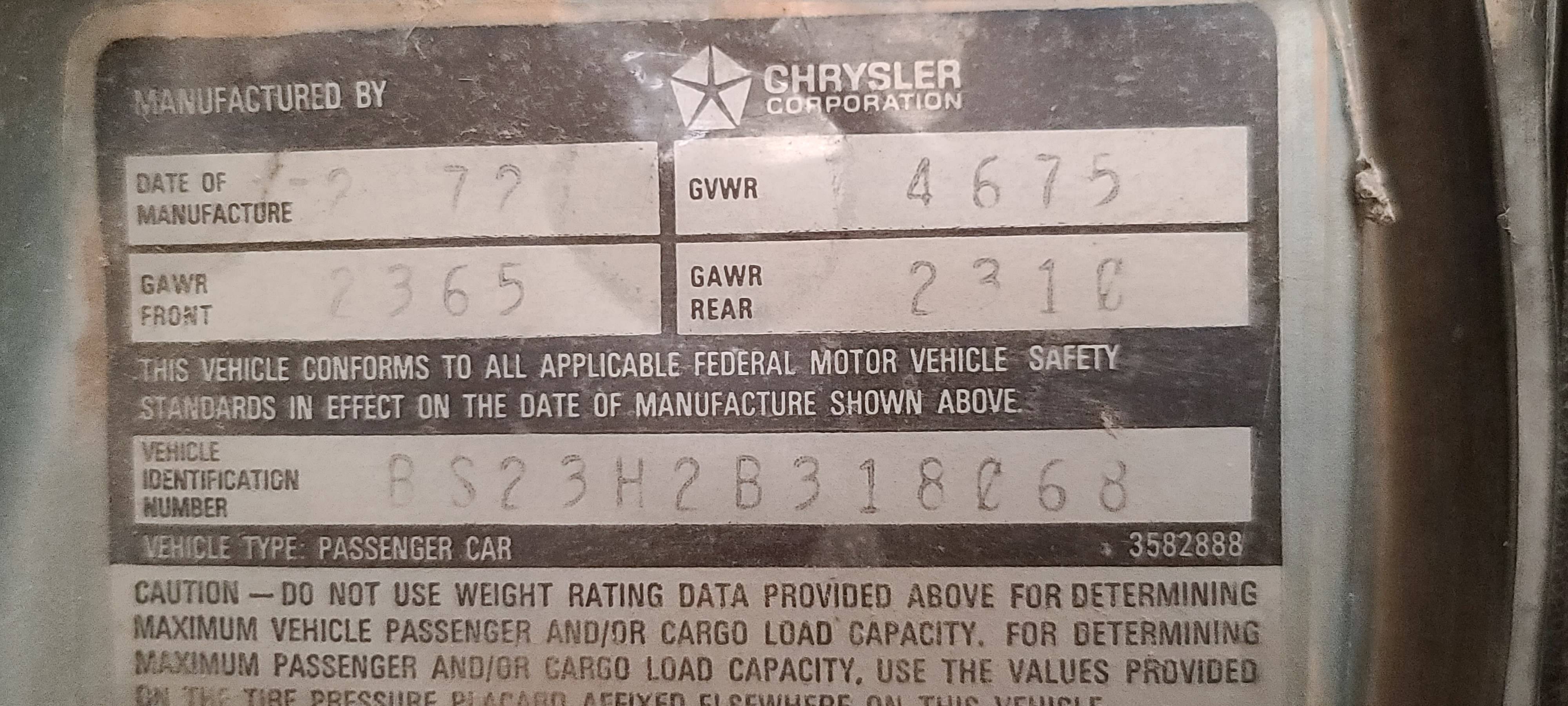

Thanks. I actually joined e-bodies.org right after I purchased the car. There is a full thread over there. Lots of good information, but unfortunately no conclusion. I was hoping maybe some experts that are only on this forum might chime in. Attached is a picture of the fender tag and door tag. You can see they don't match, but I think that was a factory error. Cowl and core support numbers match fender tag and dash VIN. I'll get it out of the garage this weekend for more photos, but you may just have to document it if any of your hunts take you through St. Louis.

Cool typo on that door sticker. A "Vee" versus a "Bee" almost sounds as if it was dictated to a typist, which seems dangerously error-prone.
I have not seen an example using a slash on the date this decal. Always a hyphen, if I recall correctly.
The typed font looks smaller than others I've seen this era. Here's a image of a repop.
I'm not sure its anything to worry about. Possibly it was replaced somewhere during its life by a dealer, or something.
