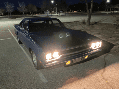

I installed (4) of the new Holley retro-bright LEDs, 5.75". I fabricated a Y adapter wiring harness so I have (4) low or (4) high, they are bright but have a wider dispersion compared to a standard headlight bulb. So no issues for oncoming traffic. Note they are pricey but go right into the Mopar headlight buckets no mods or cutting needed..
