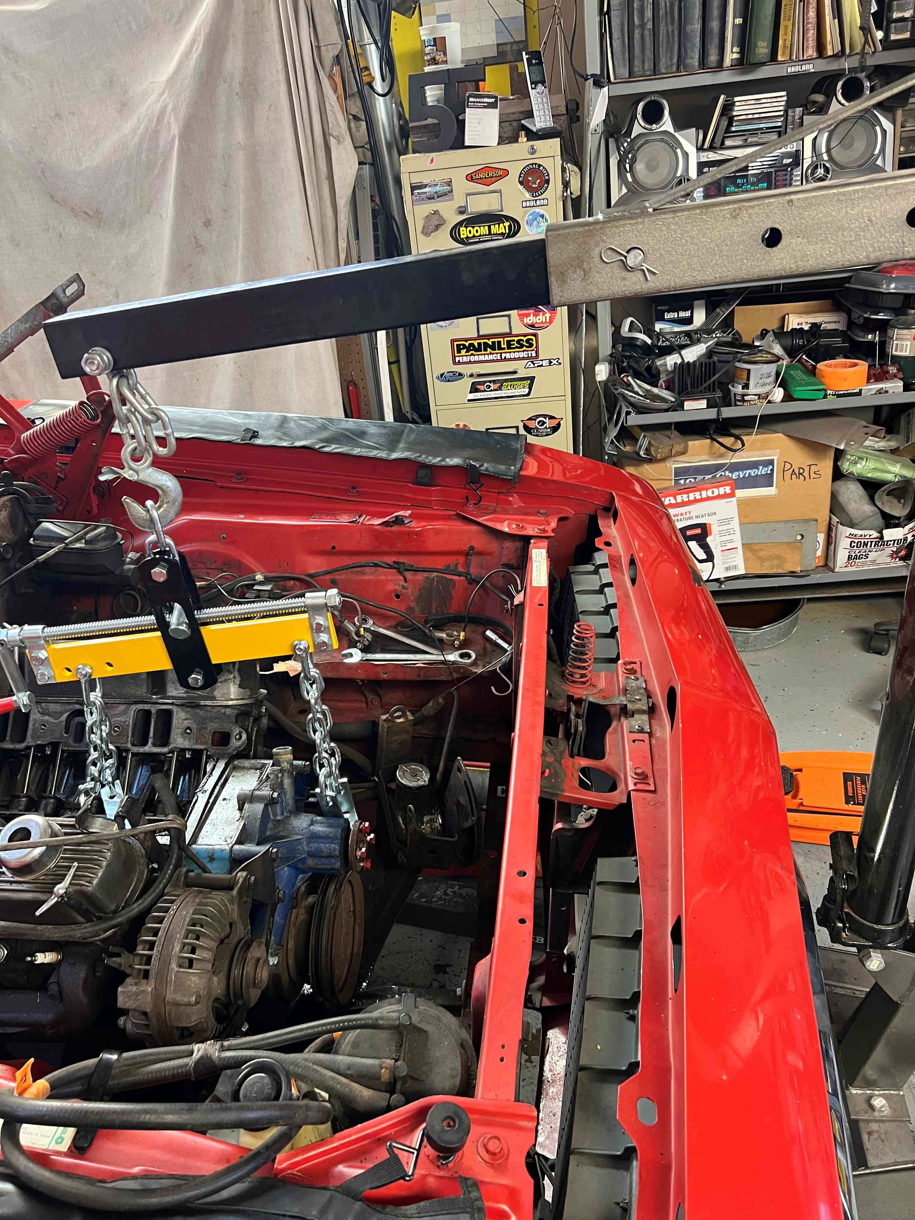

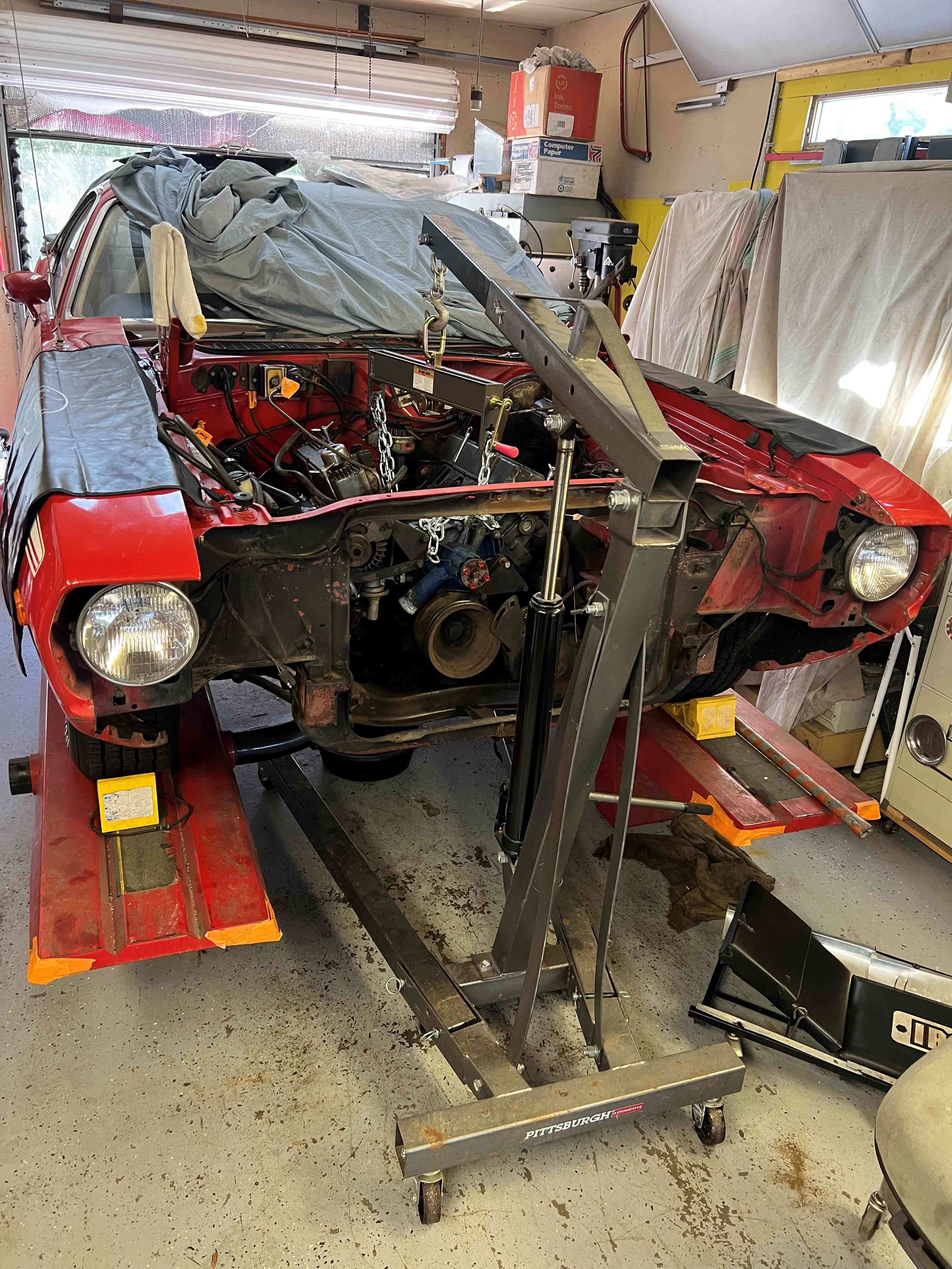

The Cam looks good from what I can see with the intake removed. I ran into a problem trying to use a HF 1 Ton lift.
it wouldn't reach far enough into to pull it up and out. I ended up buying a leveler that was a little longer and I removed the front end.
looks like I can reach now. I am doing the engine pull off Kwik lift ramps makes it easy work under it removing things. I think I'll have to lower the ramps on to blocks so the 1 Ton can roll under the lift tube. It looks like I have enough room to clear the radiator frame to pull the engine over it.

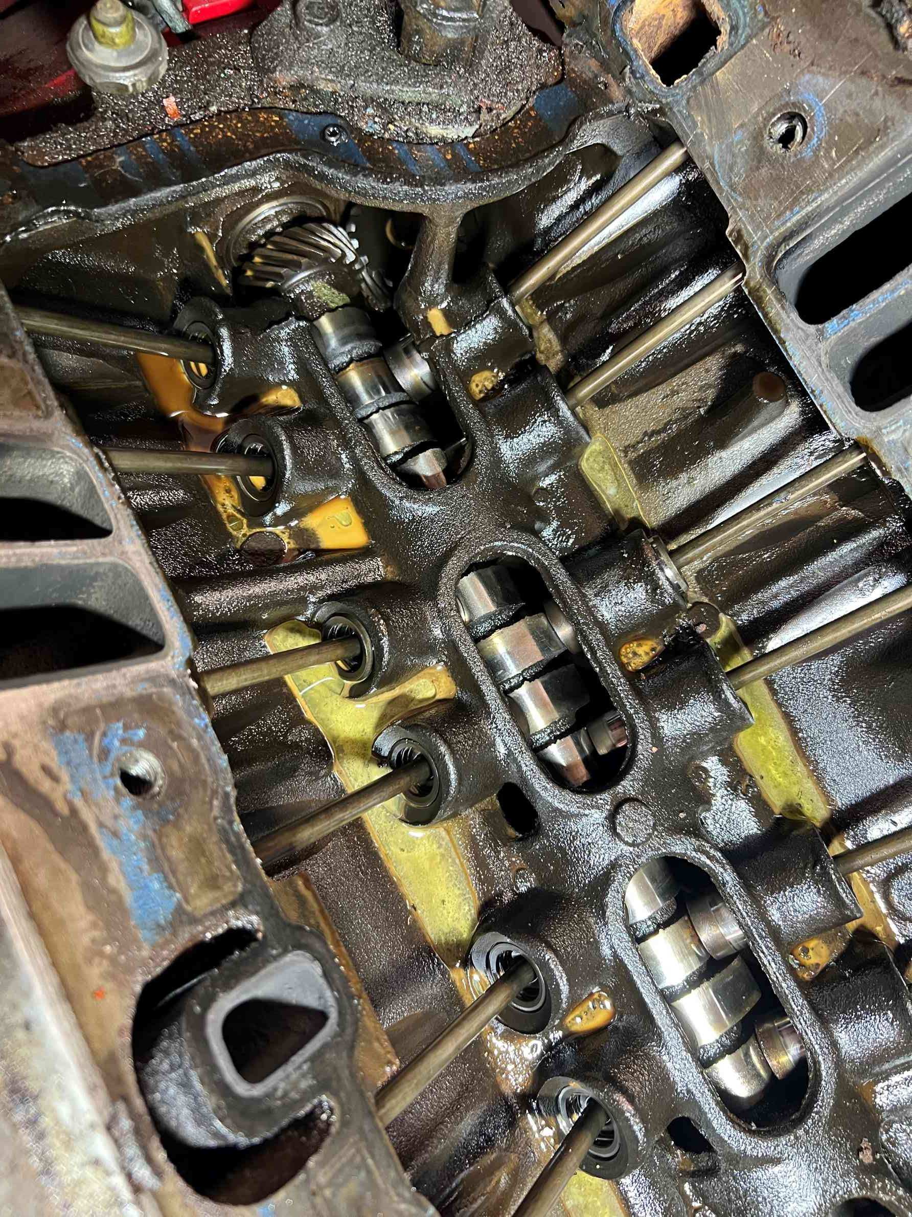

Looks like I may need to replace timing chain and gears? What do you guy's think?
Thanks!
Yeah for sure. Cloyes billet are nice ones. Hate to say but my Edelbrock one stretched after about 2 years. You can also fit the chain tensioner from the 5.9 motor under an la motor with some clearancing under the timing cover. A new camshaft thrust plate would also warrant replacing as you are going to have it down anyway. New water pump cheap insurance too.

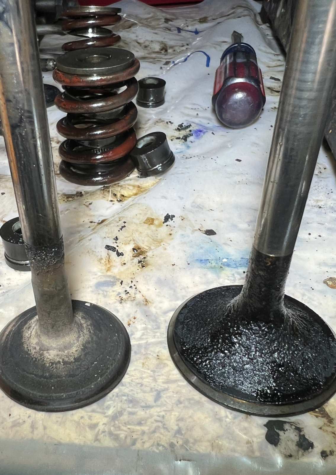

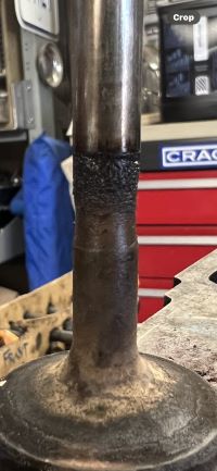

Man the more I look at the more I find. Pulling a few valves and this one looks bad. So you replace all valves if you have a bad one correct? This #1 cylinder exhaust valve looks ready to separate.

Believe it or not, some exhaust valves had a reduced diameter near the head. How does it compare to other exhaust valves? How's the wear in the cylinder head valve guides and seats?

I've cleaned out water passages on a stand with a pressure washer, but the motor was all still together. I didn't have the risk of wetting the inside of the motor, so I don't think I'd do it while it is as far apart as you have it. Rake as much of the rust out as you can, with a bent coat hanger and keep flushing it until it's clear. Don't forget the 2 freeze plugs in the back of the block! You definitely need a new chain! I have had just as good of luck with and Edelbrock timing set as I have with Cloyes. Personally, I would be leery of using a tensioner with a double roller chain. I know people who have, and the edges of the double roller chain dug into the plastic on the tensioner and there went the plastic thru the motor. That's just me though, and others may have had better luck and no problems. I'd get the heads checked at a machine shop and maybe a valve job. Clean the oil pickup really good while it's apart, and don't forget to put a new gasket between the oil pump and the main cap when going back together. Sorry you had the troubles, but you'll get it fixed up in no time!

Thanks Xcudame! My brother in-law said he ground the valves to have a triple seat. They look ok but I was going to
do a lap valve job on them to clean up. I need to pull the rest of them yet I will compare them for sure. The Valve is not sliding smooth in or out on that one so it may need to take the heads in. I'll know more once I have the rest of them out. Thanks.
