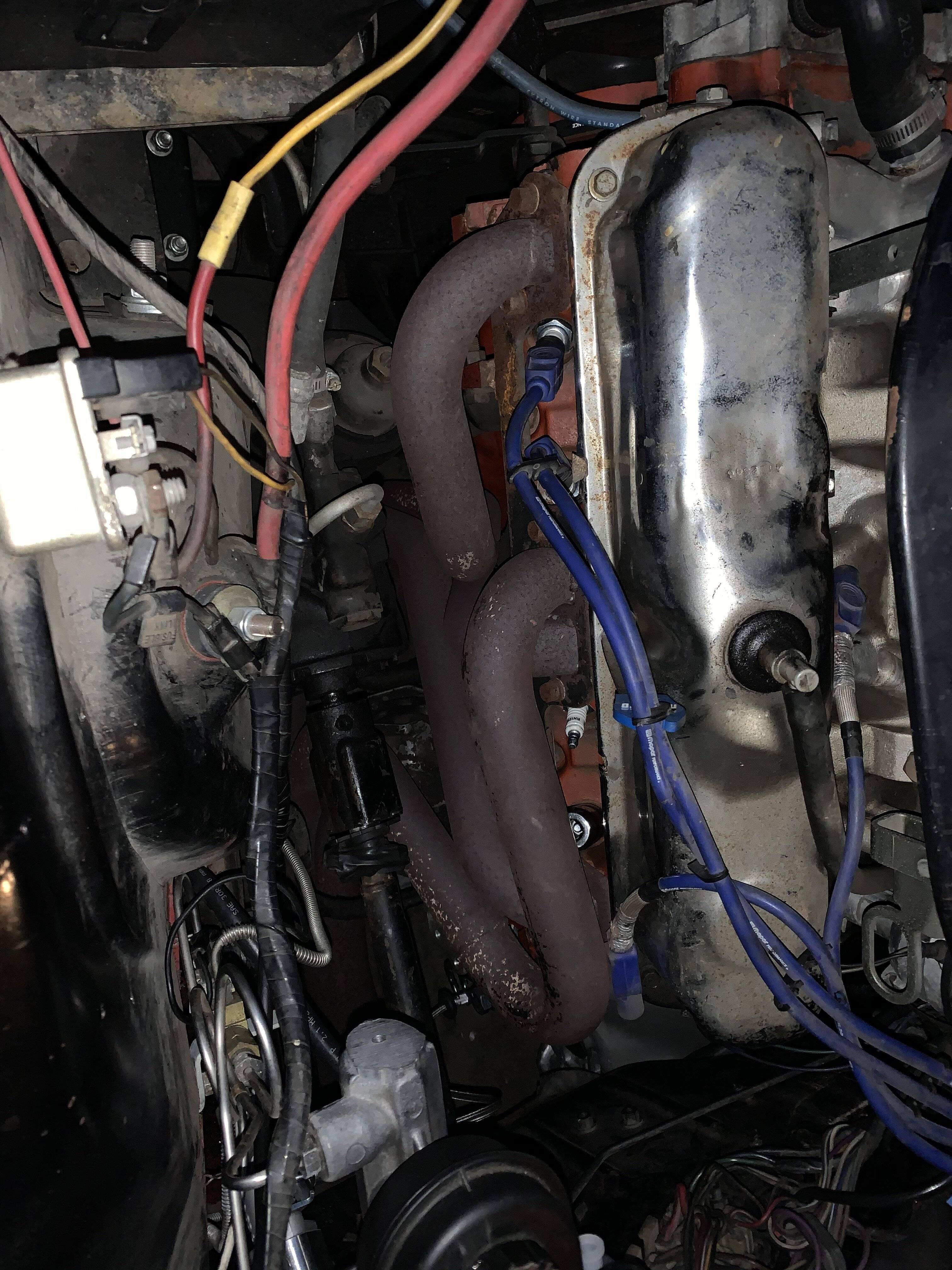

Hedman has a fix for the tight fit on the drivers side # 78538 Dave C at hedman fixed me up. everyone have a great christmas and new year!!
gave me lots of room now !! I'll post a photo later :)
