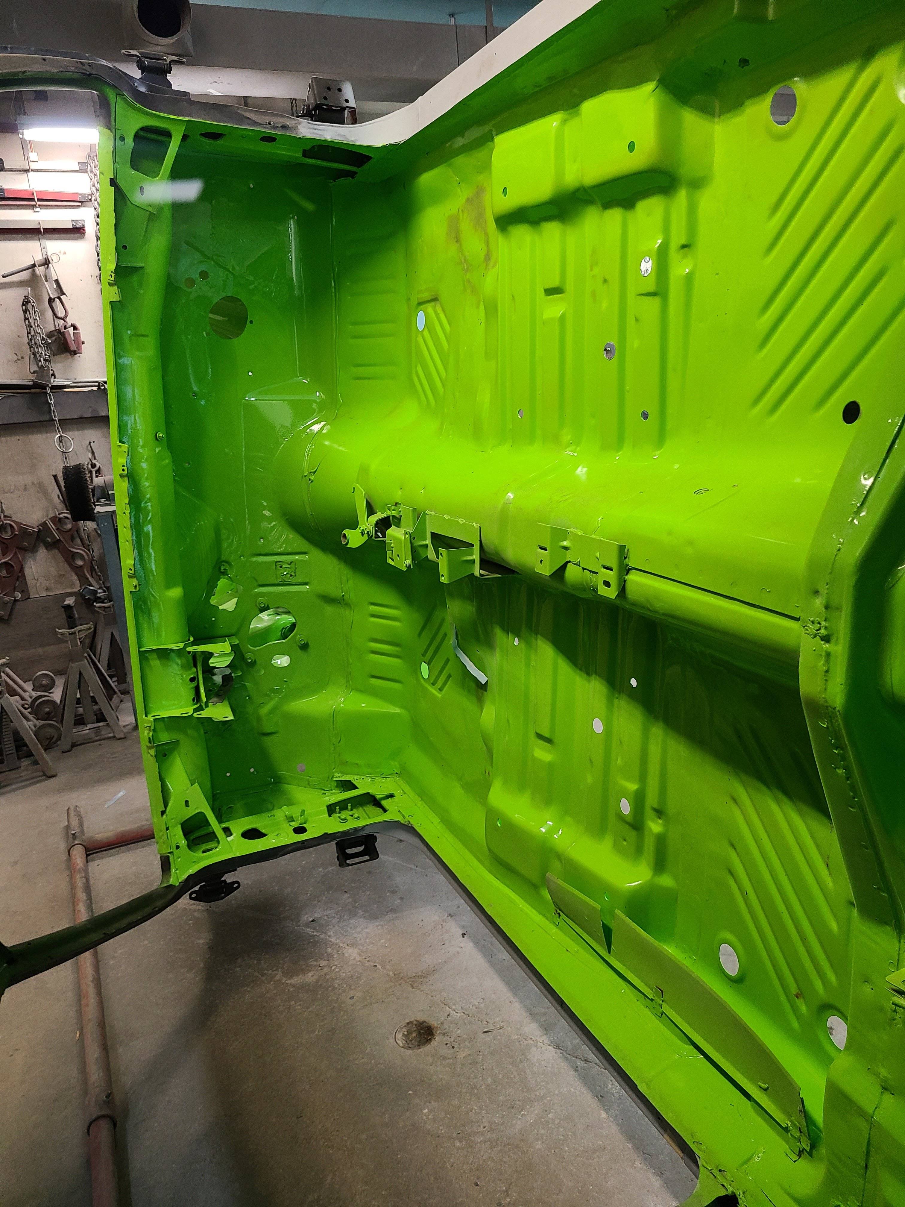

At the body shop
moparlee
Jul 25, 2011
3,158
1,381
Mid Michigan
Welcome to the site from Michigan!

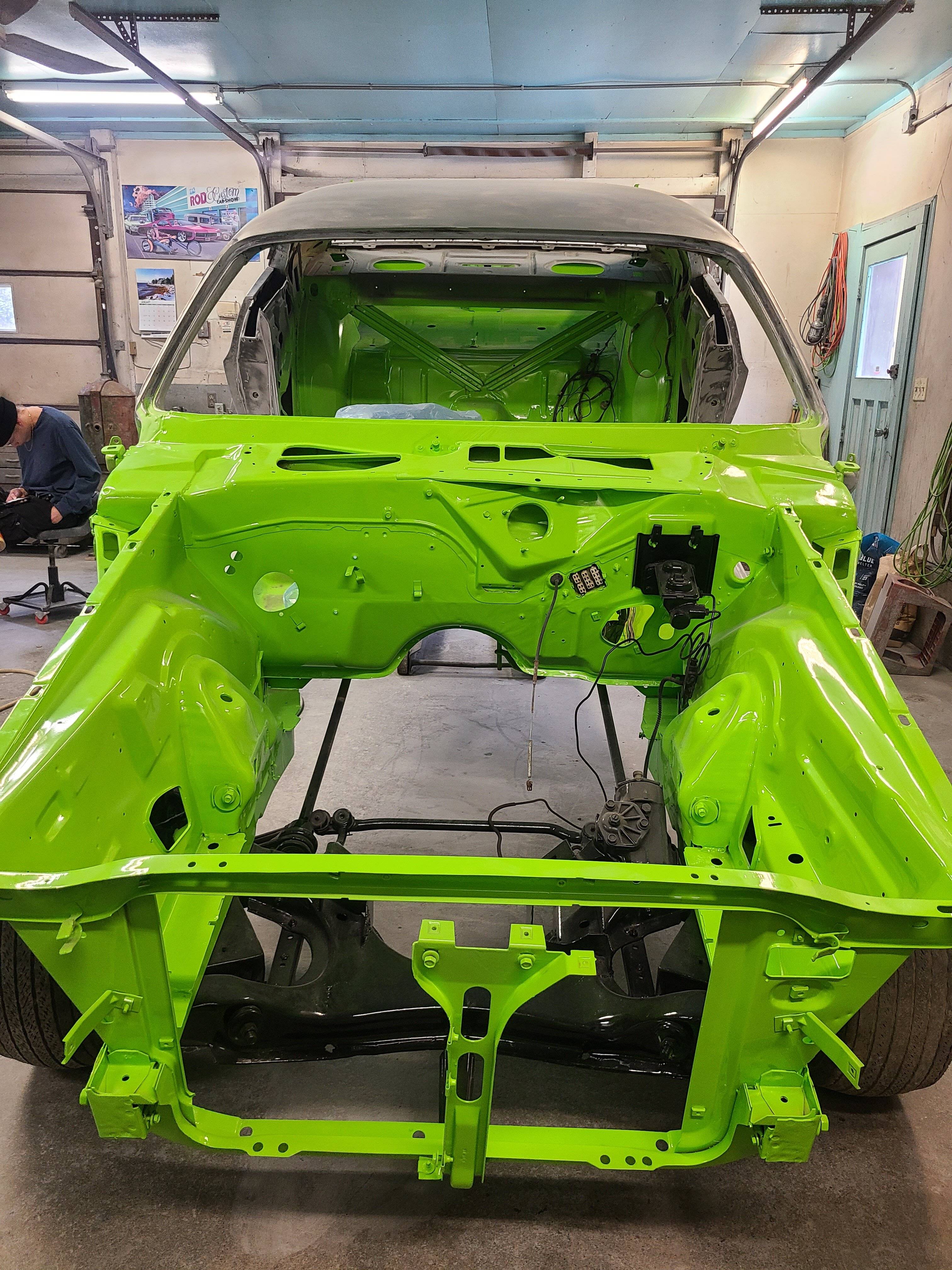

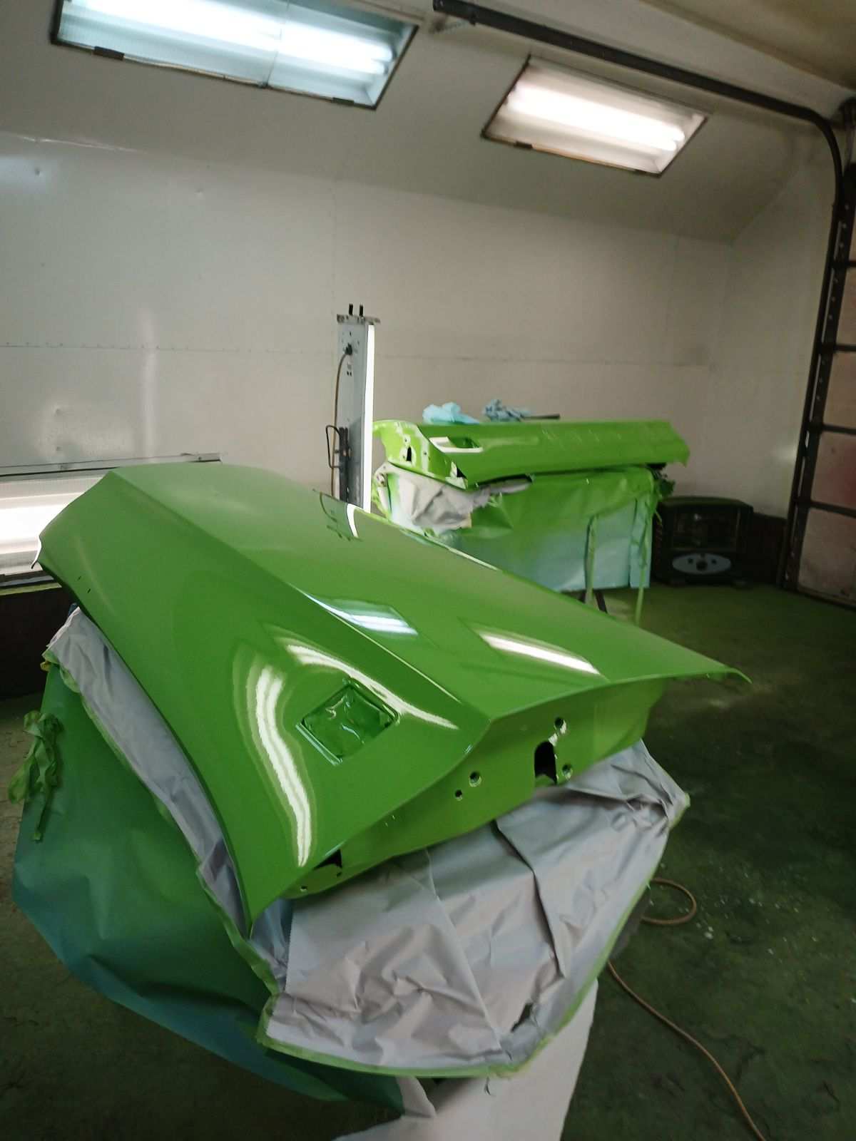

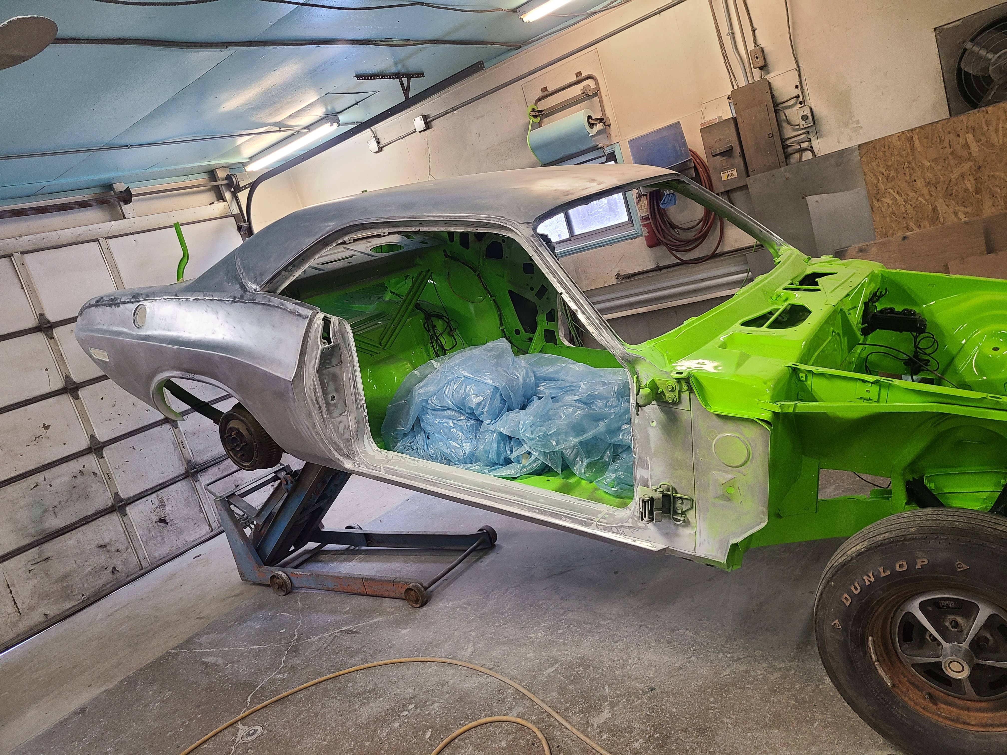

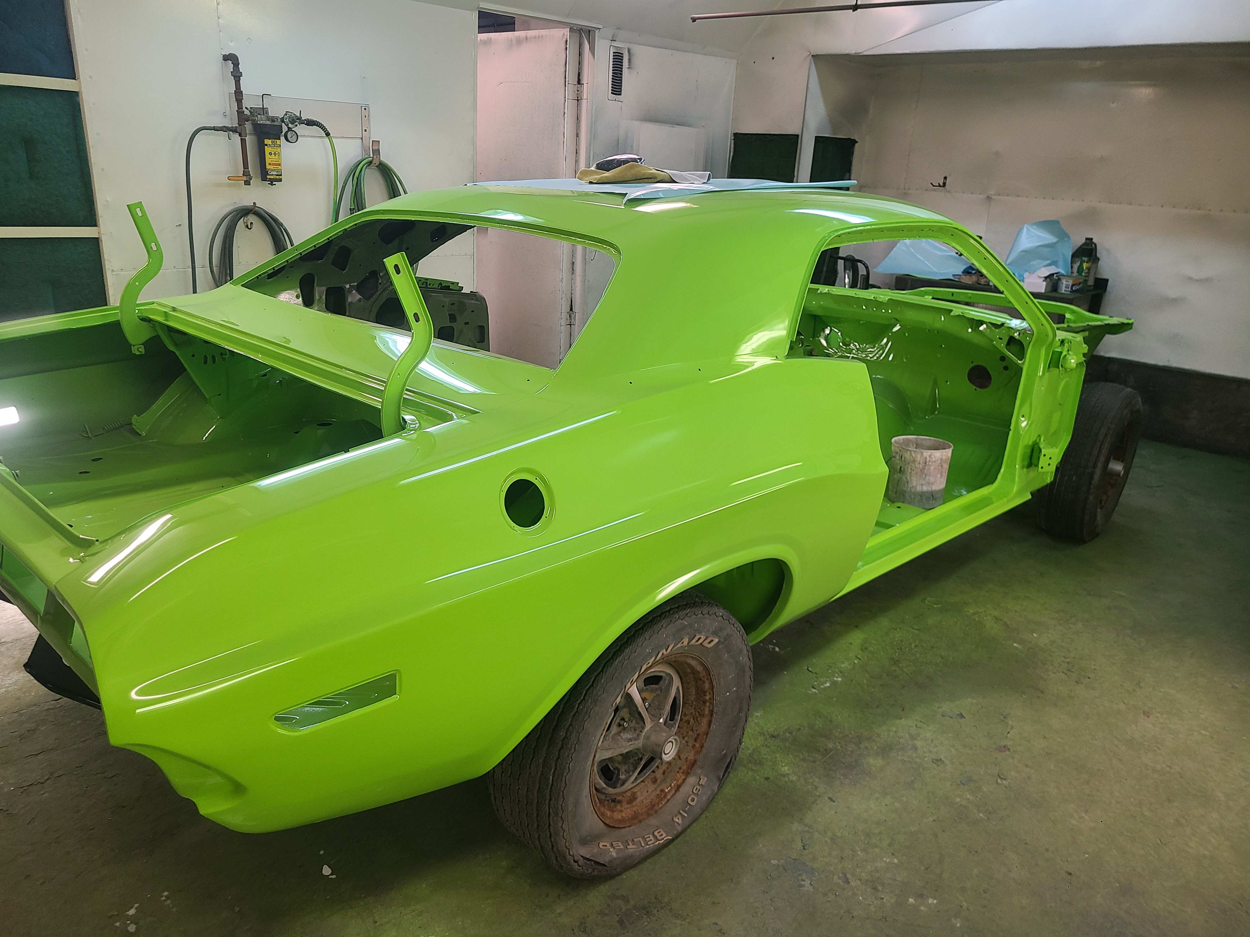

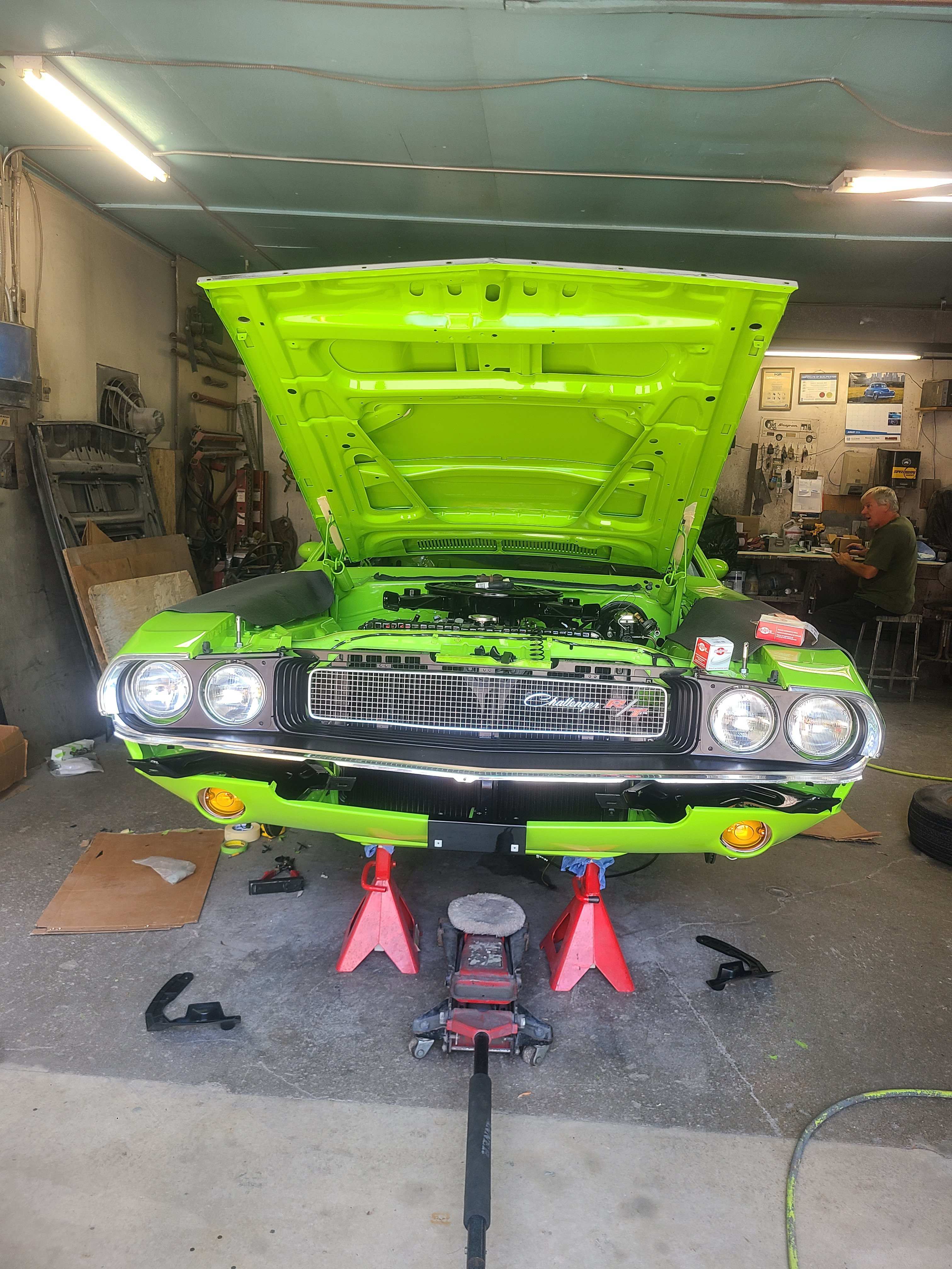

Your Challenger is looking great :thumbsup:. Are you going to be doing the final assembly?
Detroit_v71
Mar 17, 2022
41
18
London

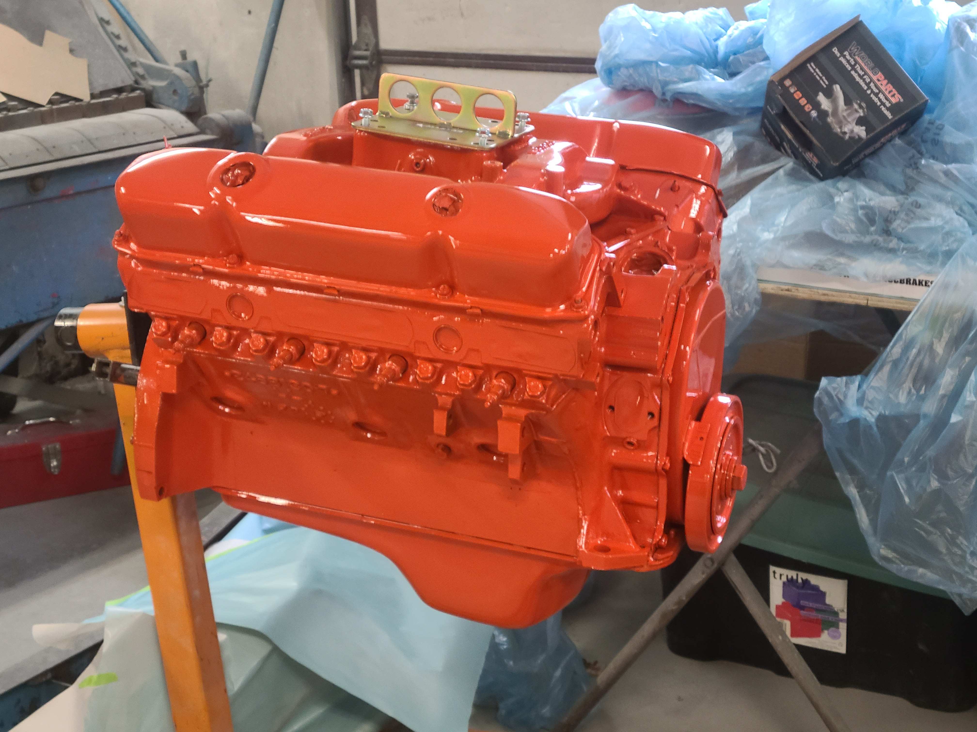

Thanks, No I will not be putting together my father in law is restoring it. I will be building the engine with my son though and putting it in

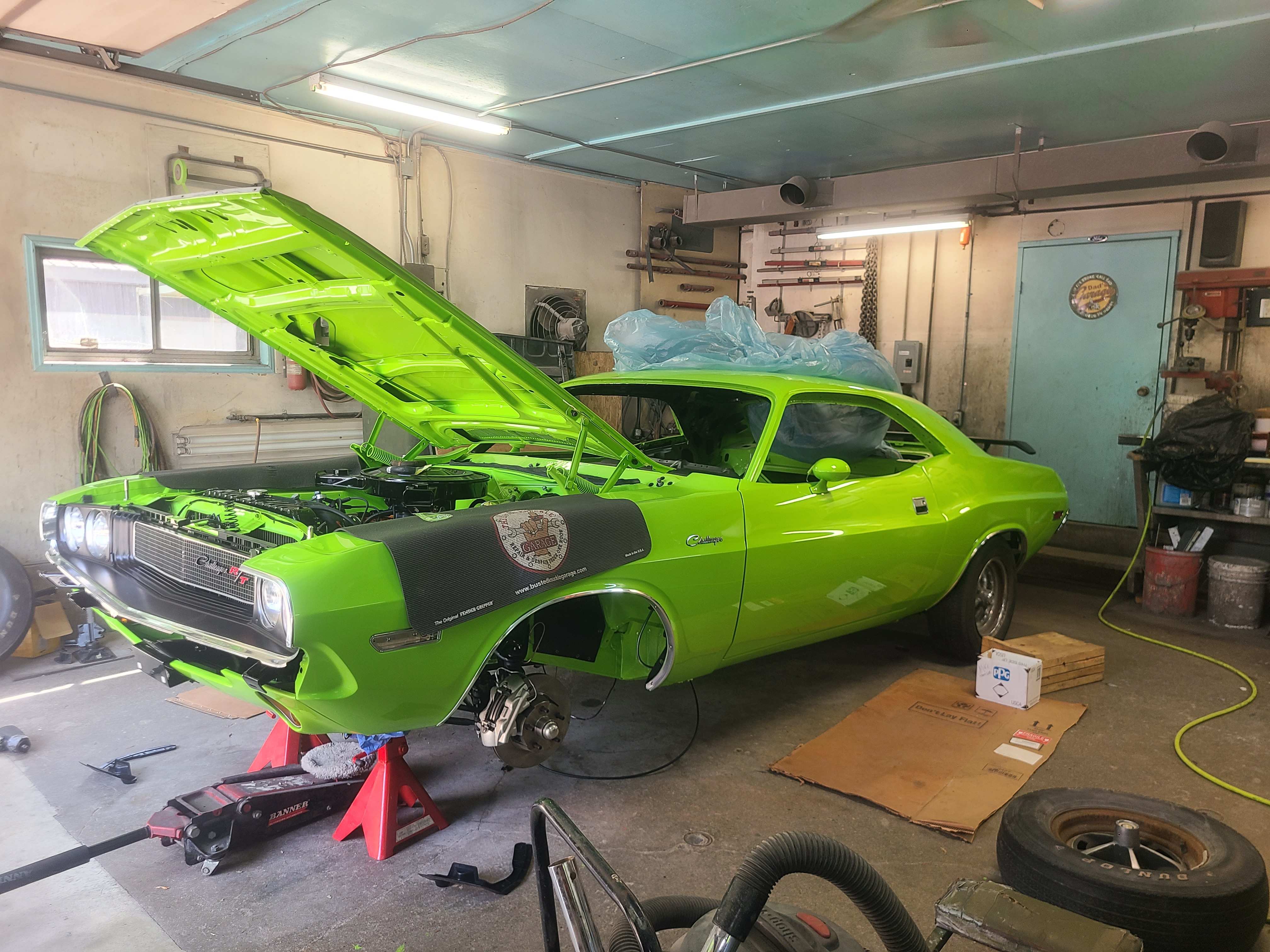

Check out Golden Star, I bought their 70-71 R/T hood replacement and it is great both fit and finish.
Xcudame
May 27, 2023
1,887
1,397
Southeast Arizona

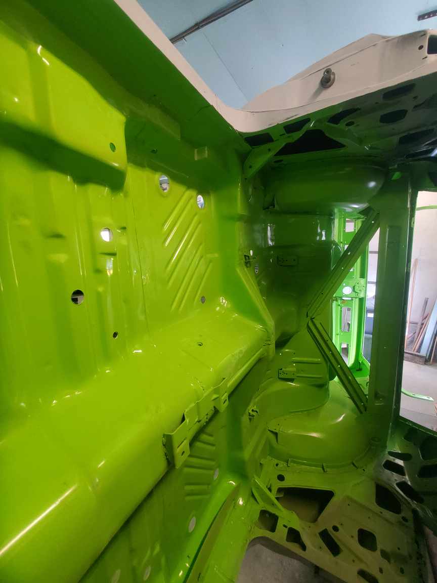

Welcome to the site! Nice looking Challenger! Be sure to paint the front on either side of the radiator flat black. This was done by the factory by some poor guy standing in a pit and spaying from below at about a 45 degree angle. Otherwise that bright green will show through the grille.

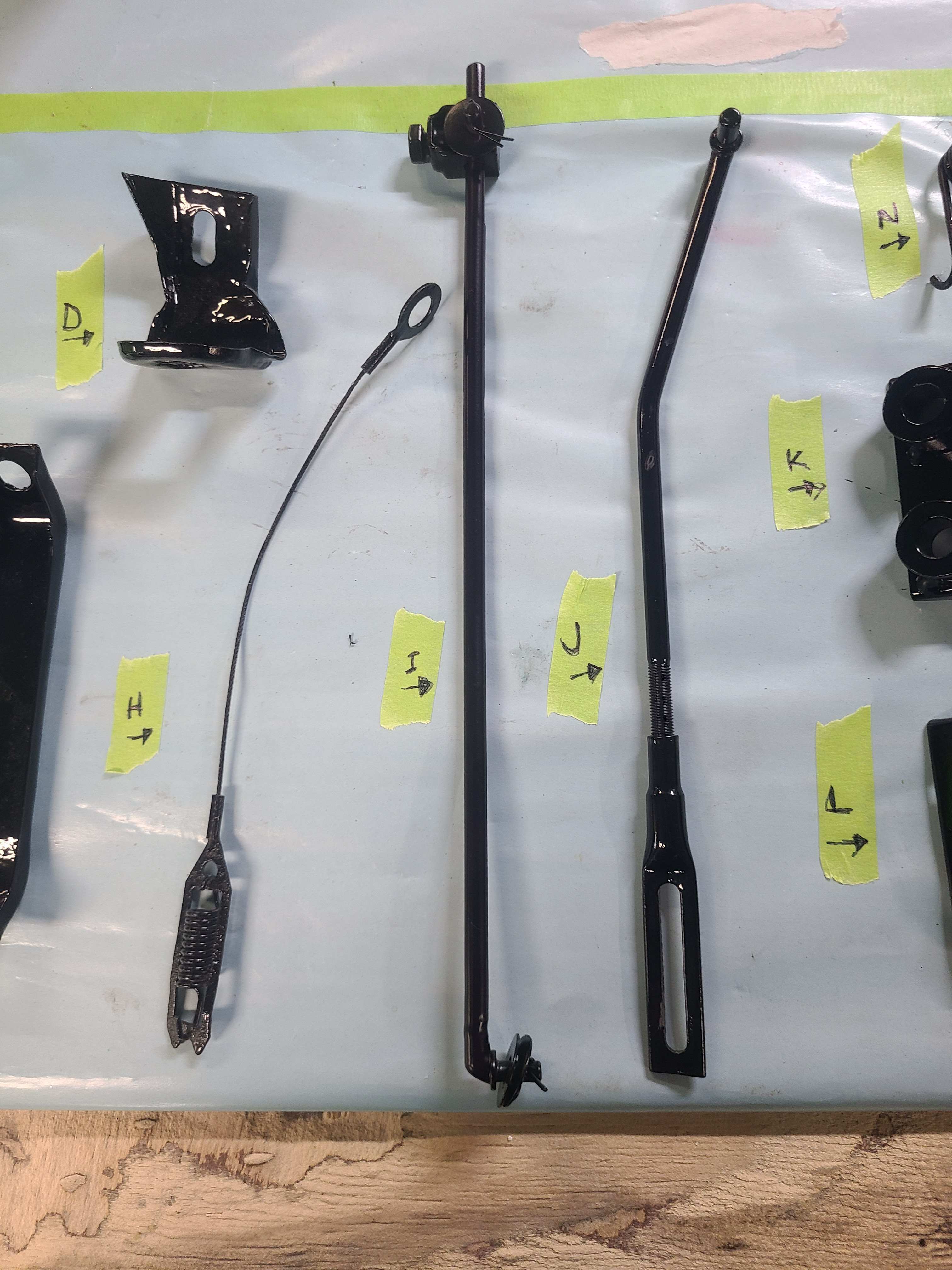

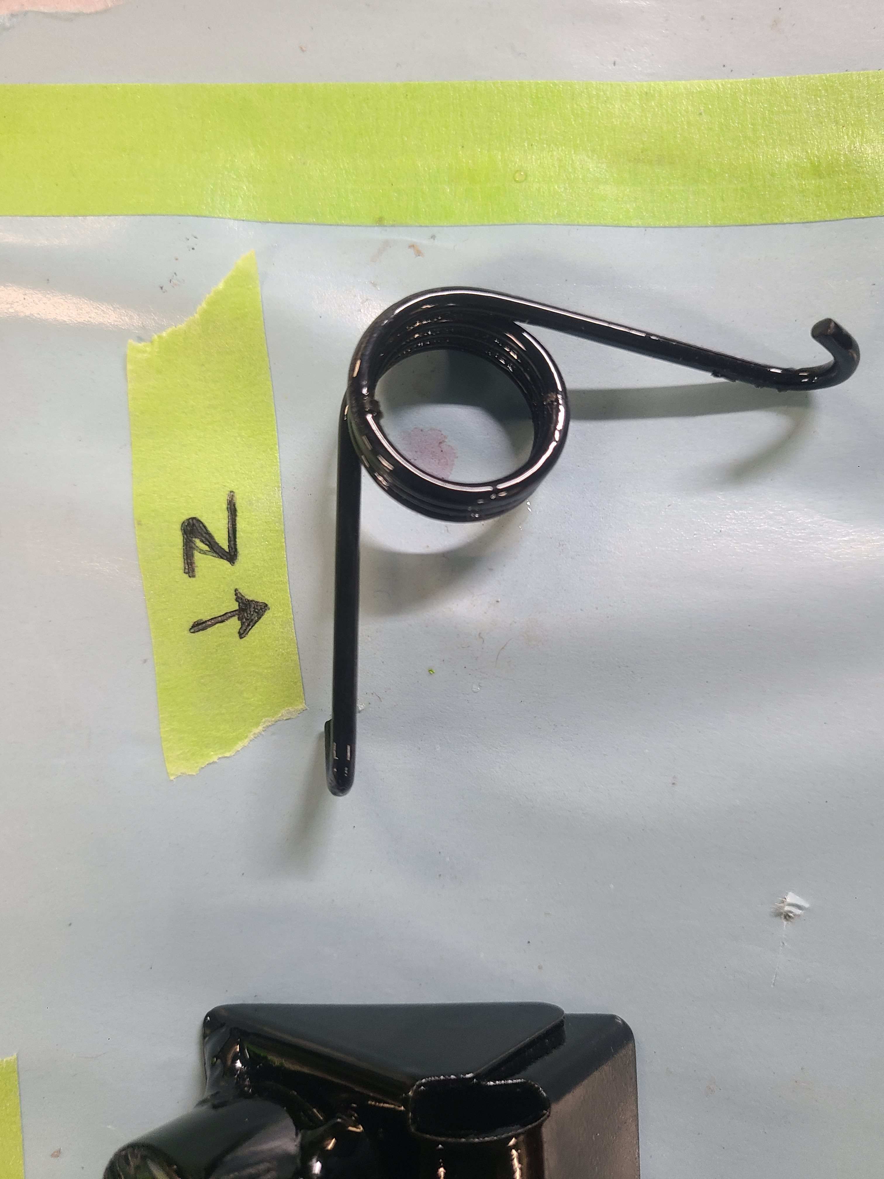

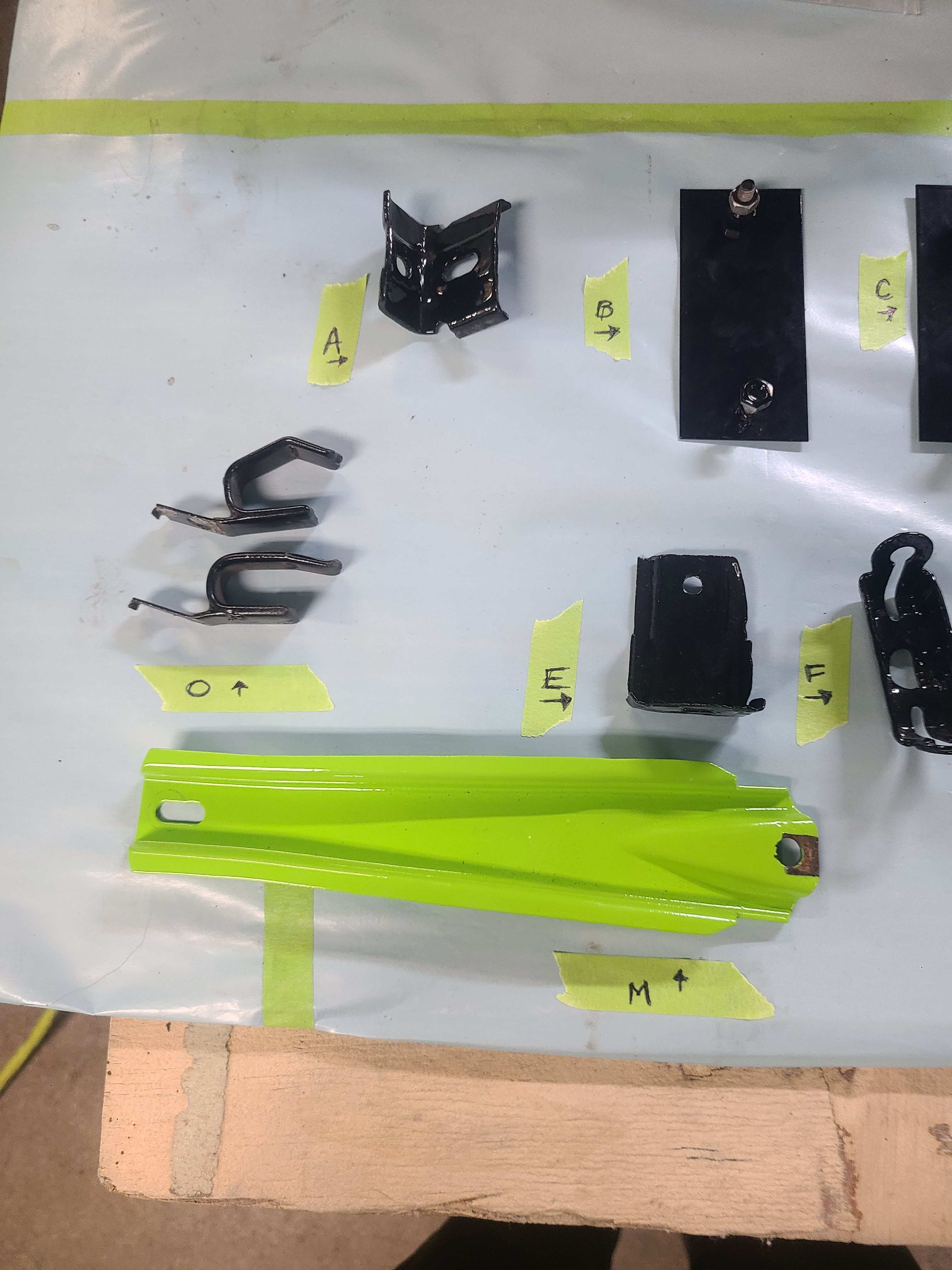

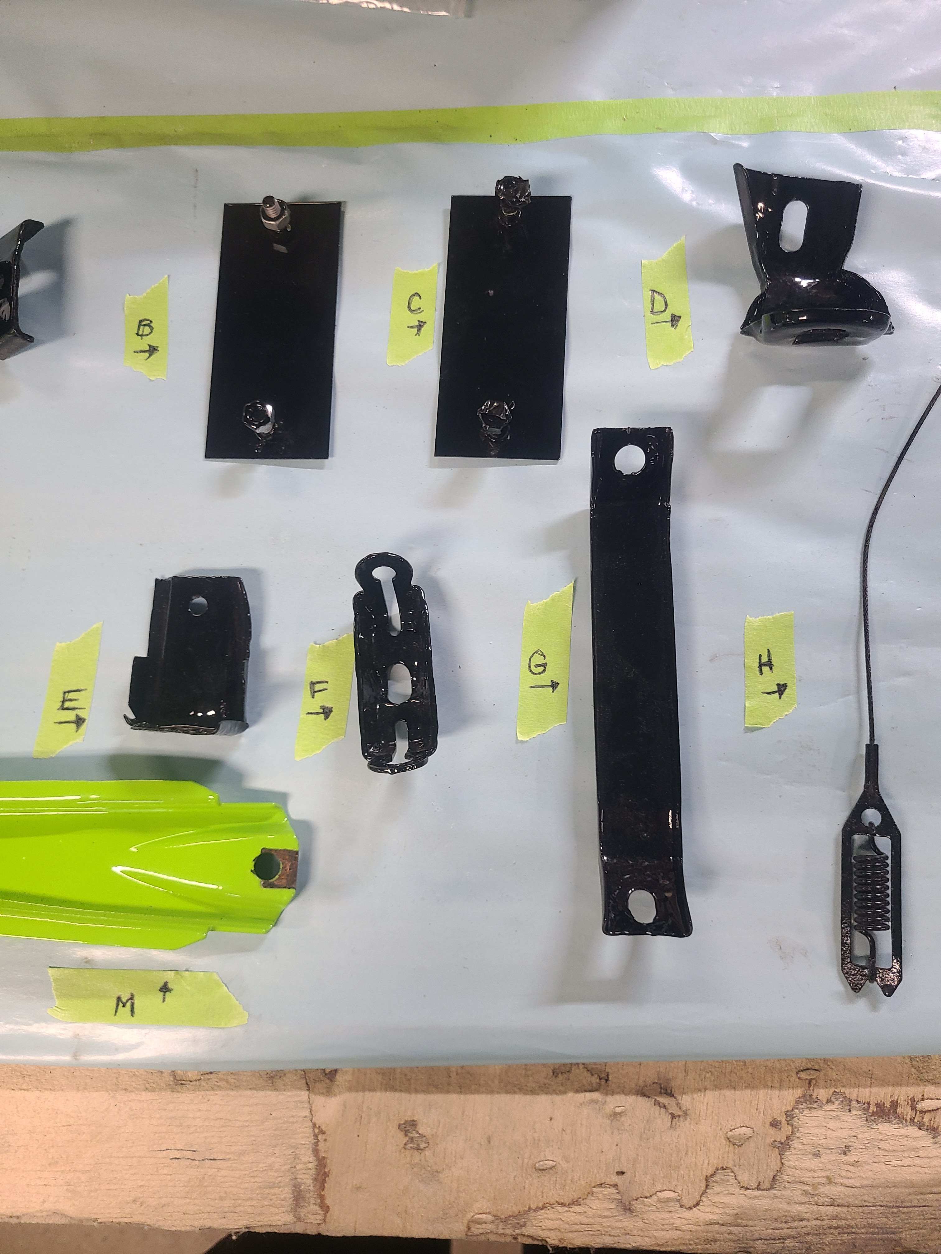

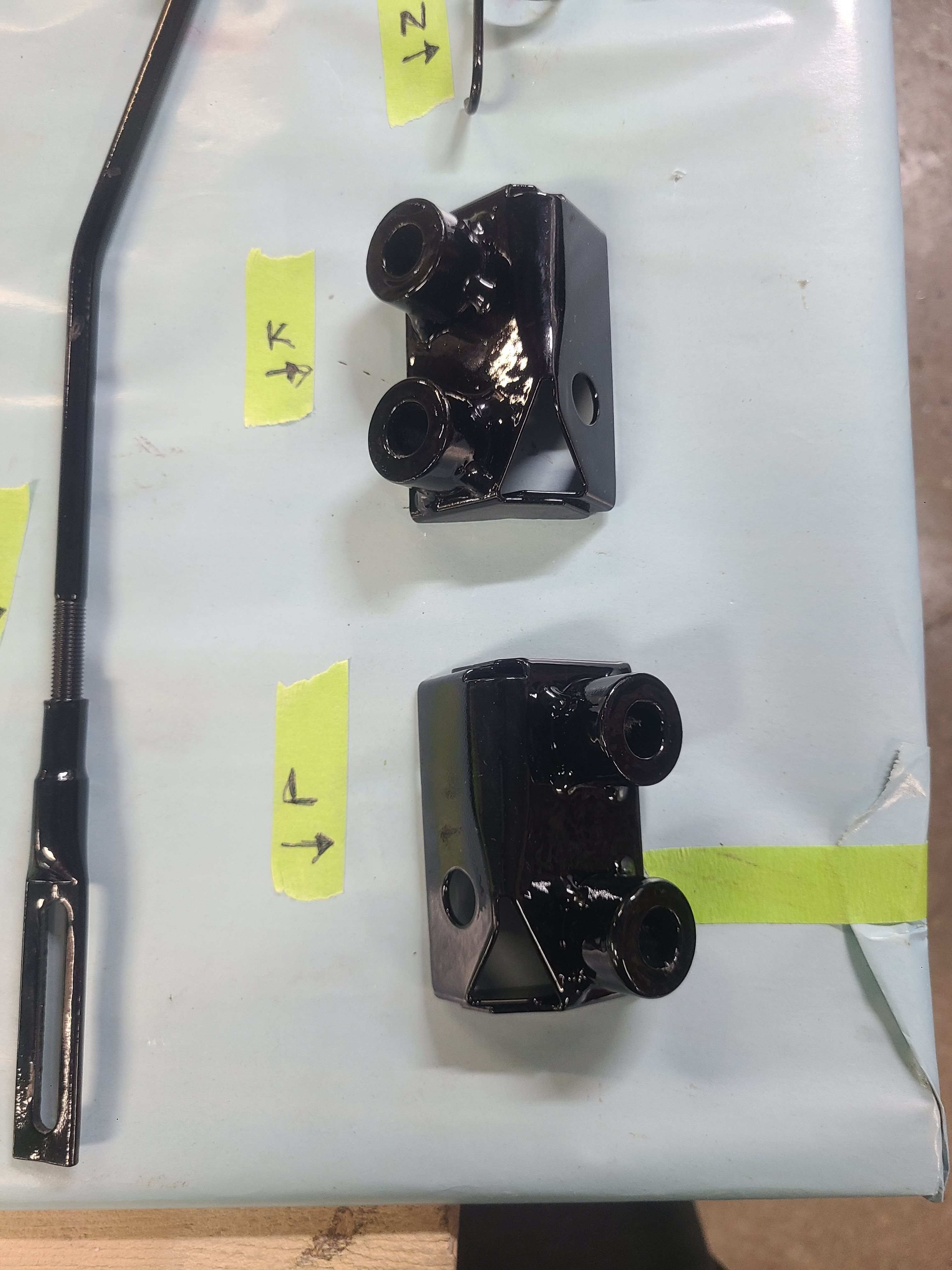

Hello everyone I am looking for some help for were some parts go. Any info would ge great. Thanks in advance
Challenger RTA
Oct 28, 2018
3,650
1,935
PA Flood city
Here's a start.B and C L and R rear muffler hanger go down through the trunk.D is L and R cowl to fender. F parking brake cable. G battery bracket support under tray. H For rear of front brake drum self adjuster. I and J for throttle kick down linkage. maybe both. N automatic shifter spring . A E O K and L not sure. I could stand corrected on some.
