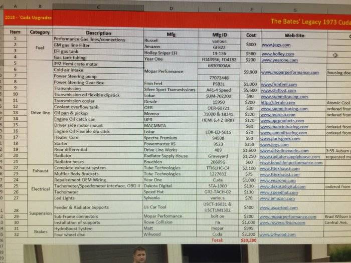

Here is everything I have done for the swap. Zoom in. Lol.

Certainly there is but I like warranties and peace of mind that's why I buy new when possible. The motor is the second one from Chrysler. The first one at 168 miles blew a hole in #2 cylinder and I had not given it hell yet. Chrysler sent me a new one free. Try that elsewhere. Lol. Plus I'm done so the list is all imcompassing and no additional costs that I see. the last thing I'll do is give her some fresh paint. Mechanicals first then cosmetics is my motto.
Avalanche
Sep 1, 2011
589
81
Massachusetts

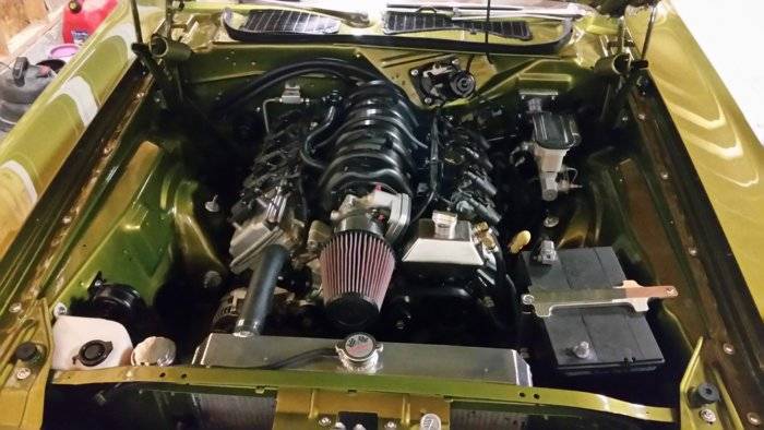

I didn't know the car was together. Just thought you were gathering parts. That's a great list since it covers everything. I will keep a copy for reference.
Any chance you can post a pict of the engine bay?

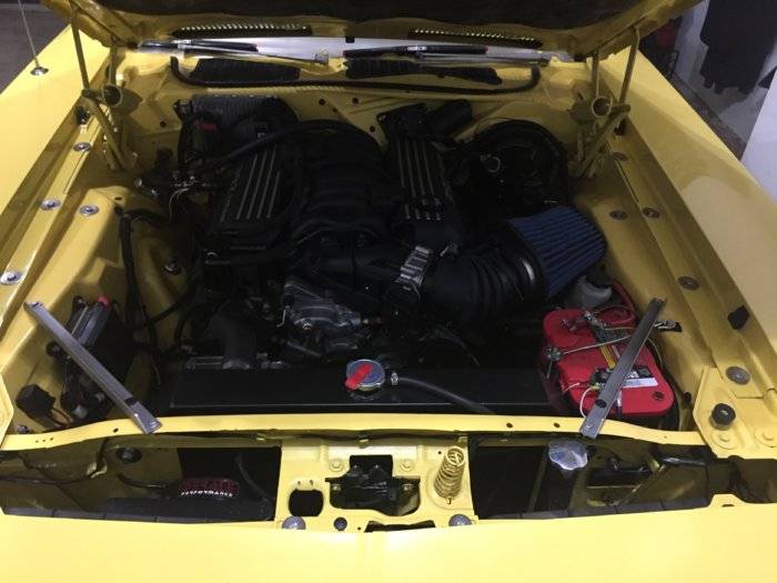

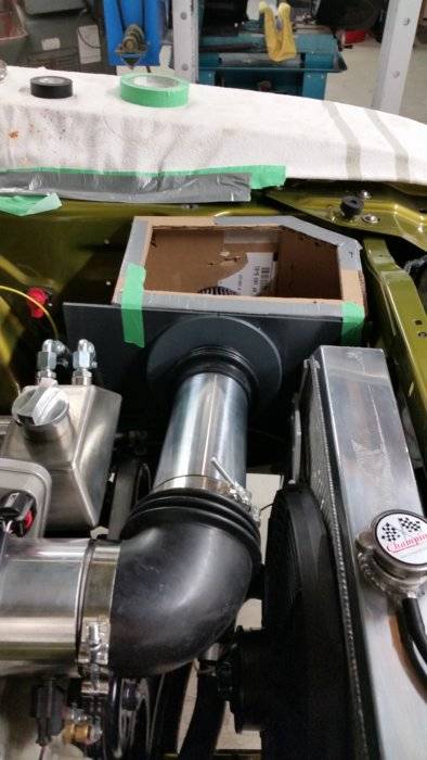

I put mine together on a very low budget. Purchased what I could not build myself. I may be able to give some advice .

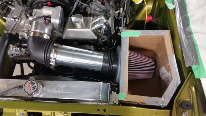

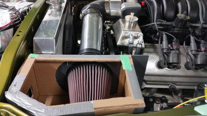

I like the fact that you were able to install the air cleaner in the front so you can keep your battery under the hood
Hubes71
Jan 26, 2019
34
22
Ontario, Canada
I'm actually in the middle of changing that. Battery is going in the trunk and I am building a air box to bring in cold air. I did have a plan to duct the air out the passenger side just behind the horns and put airbox behind headlight pot.
CMC
Oct 28, 2017
174
That sounds like it might require a bunch of metalwork cutting on the inner Fender and elsewhere. Very ambitious. Sure interested in seeing how to accomplish that placement
Hubes71
Jan 26, 2019
34
22
Ontario, Canada
Sorry for the confusion . I was going to do that but decided to remove the battery and build a box. If you wanted to keep the battery up front you could go with my original plan.
