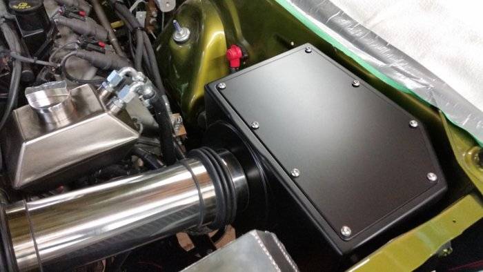

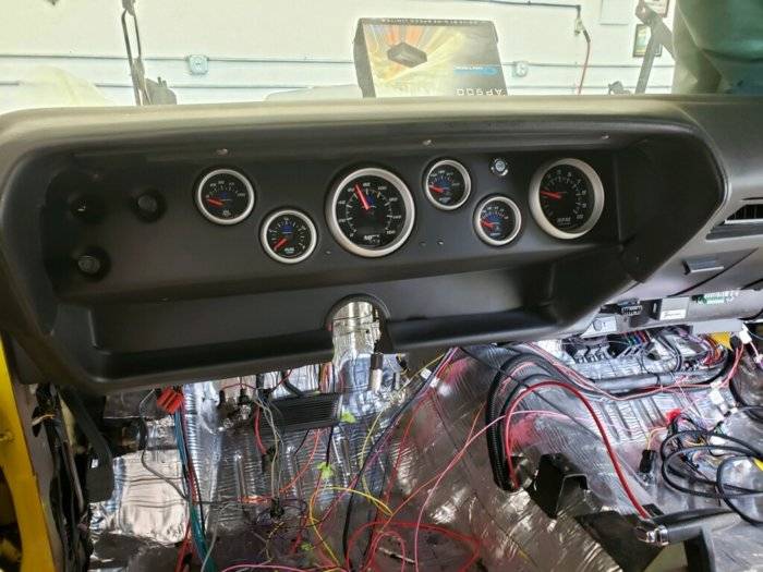

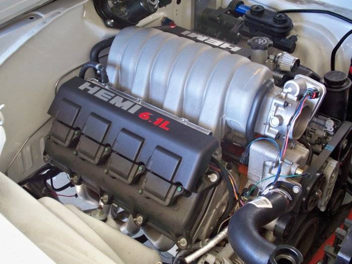

Here is how I did mine, apologize it is on my Demon not my cuda. But same set of problems. And I went Dakota dash and never looked back.

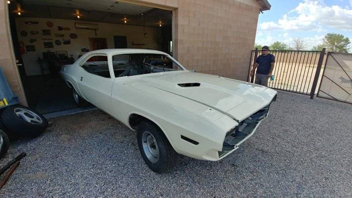

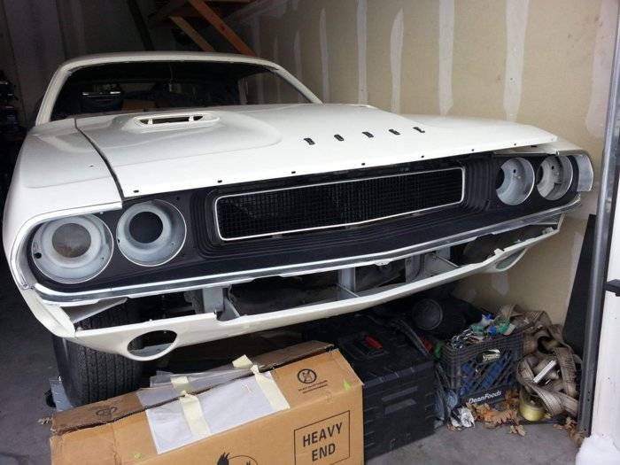

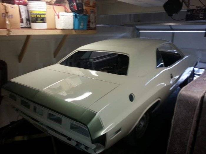

Been awhile since I've been on, but the Challenger paint and body is done! I picked up a 5.7 hemi from a 2006 Ram 1500 2wd. I've hear hotwire auto is the place to go for the harness and all, but what about accessories? Motor mounts? Thanks in advance!!
Hubes71
Jan 26, 2019
34
22
Ontario, Canada
Humm, where to start?
Hotwire will definitely supply you with a quality wiring harness and a straightforward and simple install to get your engine running quickly. This is how I started. Long term though it may not be answer if you plan on upgrading your engine to include headers, new cam, etc.
You will have no problem finding a lot of the other parts required just need to do a search and look for the best price. You will need a Milodon oil pan, engine mounts (TTI sells), Grand Cherokee manifolds or TTI headers ($$$$), some sort of electric fuel pump (I went with intank), drive by wire gas peddle, and I also recommend a Borgeson steering box for extra room and steering performance. I assume that you are going with an automatic transmission , as I went A833 , I am of no help. If you have any specific questions , I can offer up my two cents as you progress on your project.
By the way, love the white with green stripe, awesome .

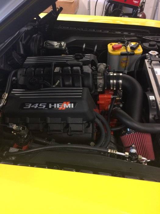

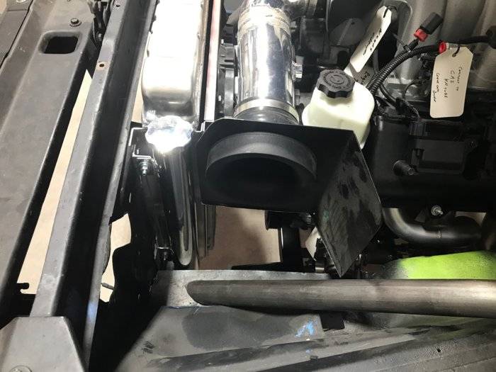

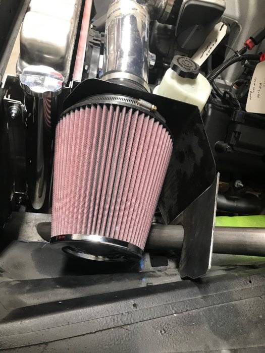

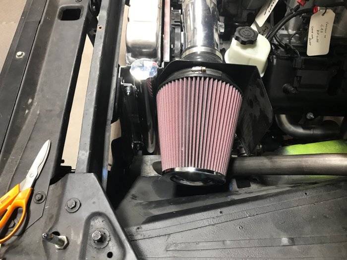

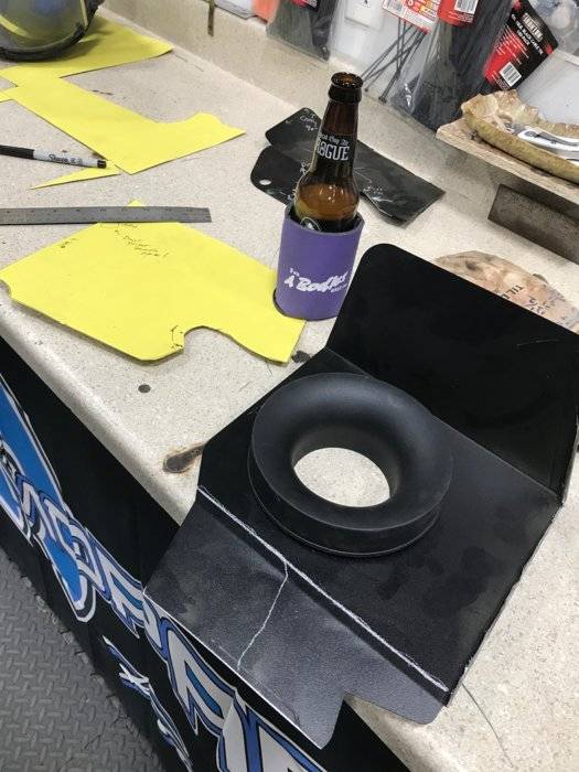

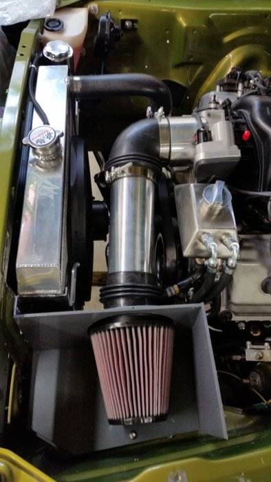

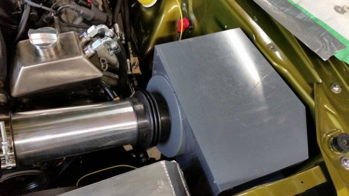

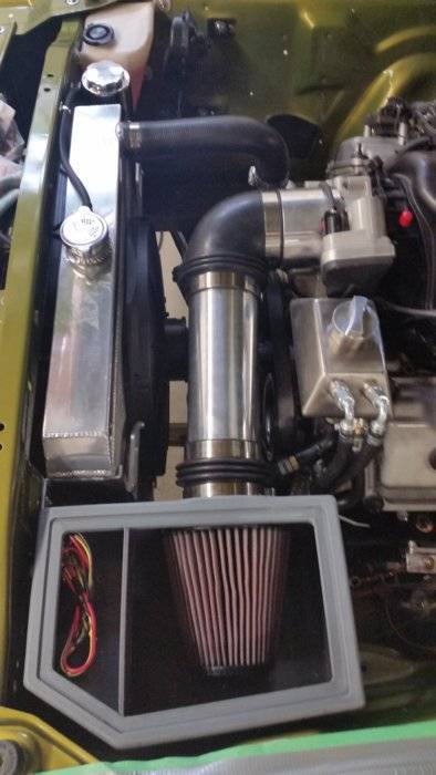

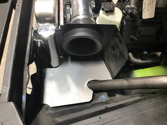

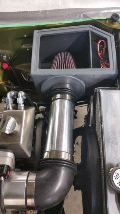

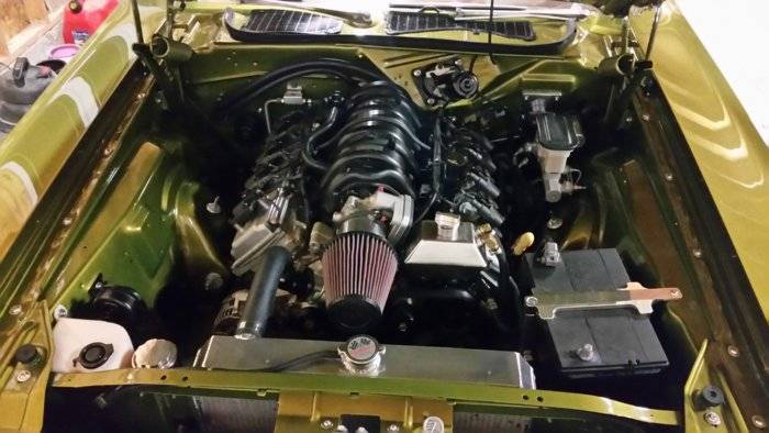

Here is my set up, I didn’t think it was necessary for me to build an air box. I wasn’t looking for a few extra HP, I just wanted it to look clean.

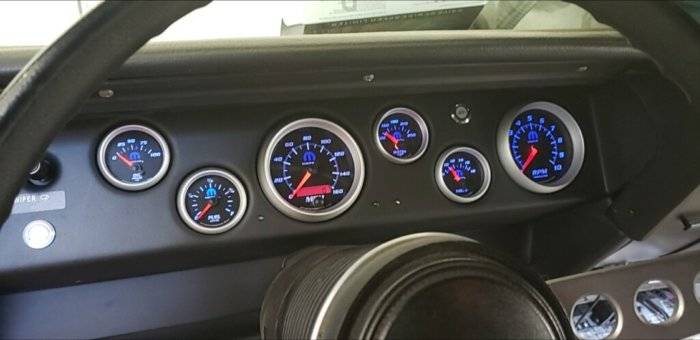

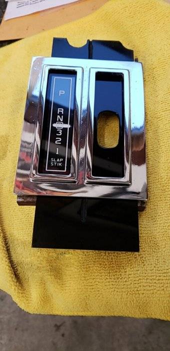

I went with hotwire also, tti for both the motor mounts and the headers, autometer MOPAR gauges. I built my in tank fuel pump gas tank but tanks inc makes a nice one.... If you have questions this forum is a good place to ask. The big question is what transmission are you going to go with? I tried both the 545 and the nag1 but you will have to cut and weld a new floor in, you can’t use either. Plus you are going to have to build some kind of shift linkage, but if you go with silver sport transmission everything bolts in. It only a 4 speed but it is a .70:1 OD where the nag1 is a .83:1 and the 545 is a .67:1. You even use the stock linkage with the SST. Also they make a plate for the slapstick that says 1 2 3 D instead of 1 2 D.
Here is the link: www.shiftsst.com
