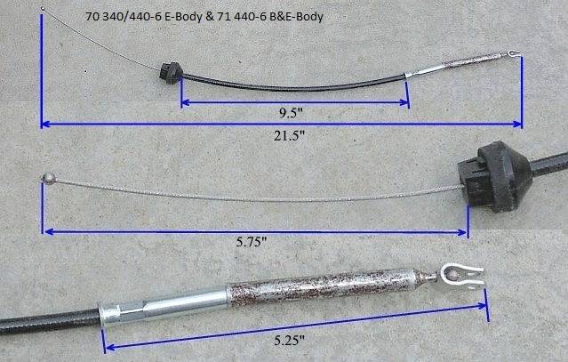

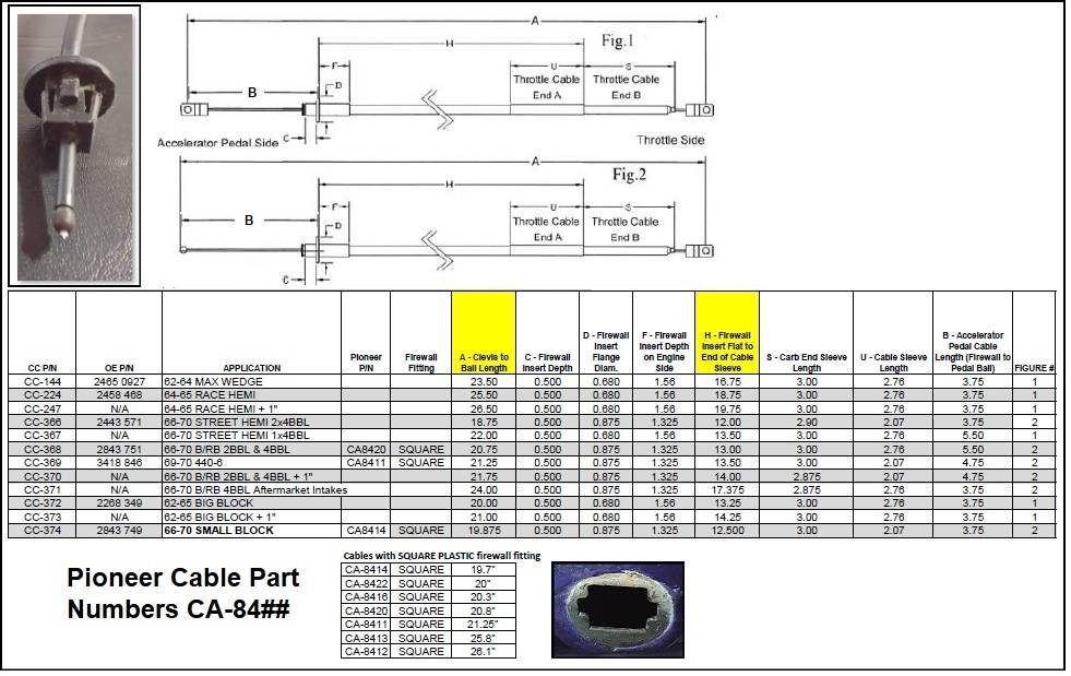

The Pioneer cables in this chart may help you determine which cable is needed for your application. The 340/440-6 cable is for reference and others who may need that info.
