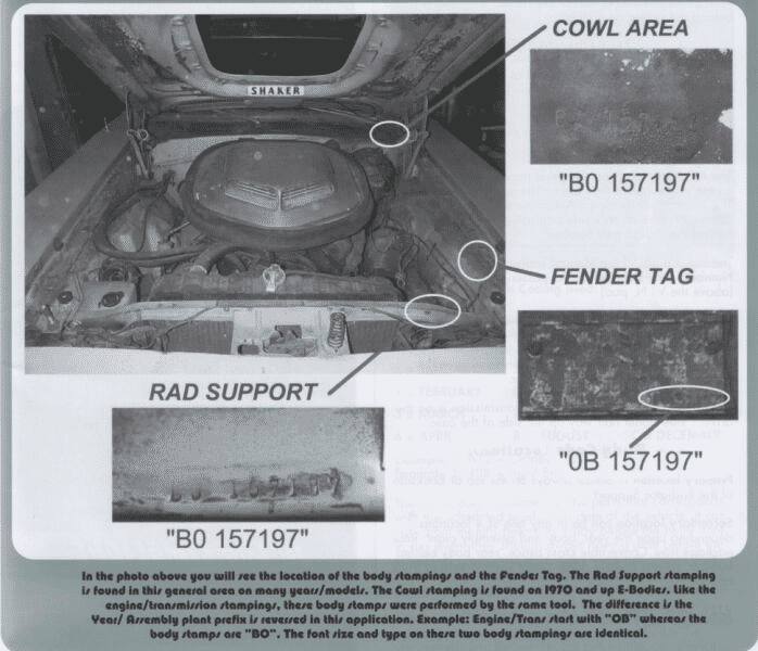

How about a visual on this!
Jan 24, 2019
340chalconvert Thank you for the pictures. I did not know where to look. I have the fender tag and the cowl numbers and radiator support numbers match.
Thank s everyone for helping!
