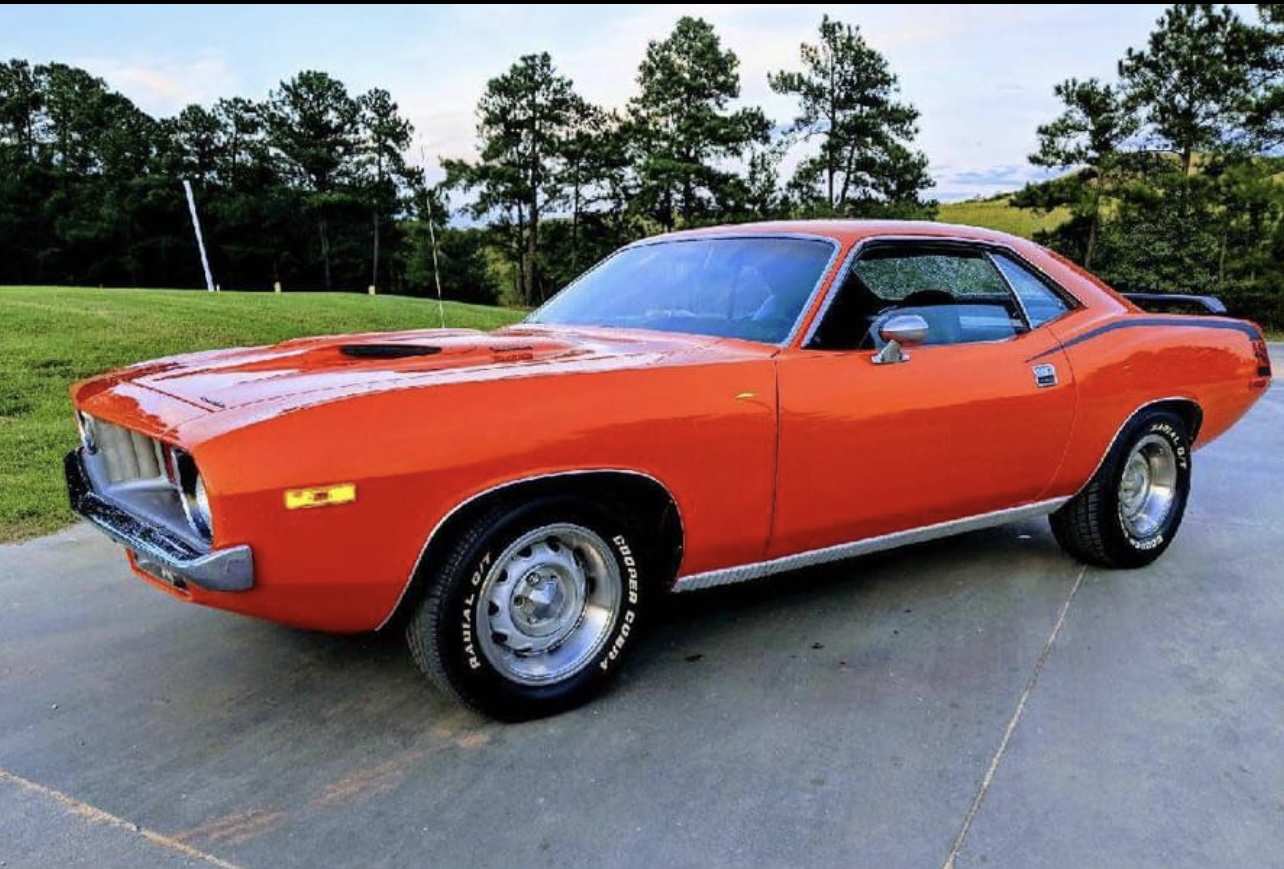

I have a 72 barracuda 440/727. Holley carb/Headers. Car runs great but I do get some backfire under de acceleration on the highway.
Is this normal if it’s performance tuned?
Would it e fuel or timing related.?
Thanks in Advance Guys…
