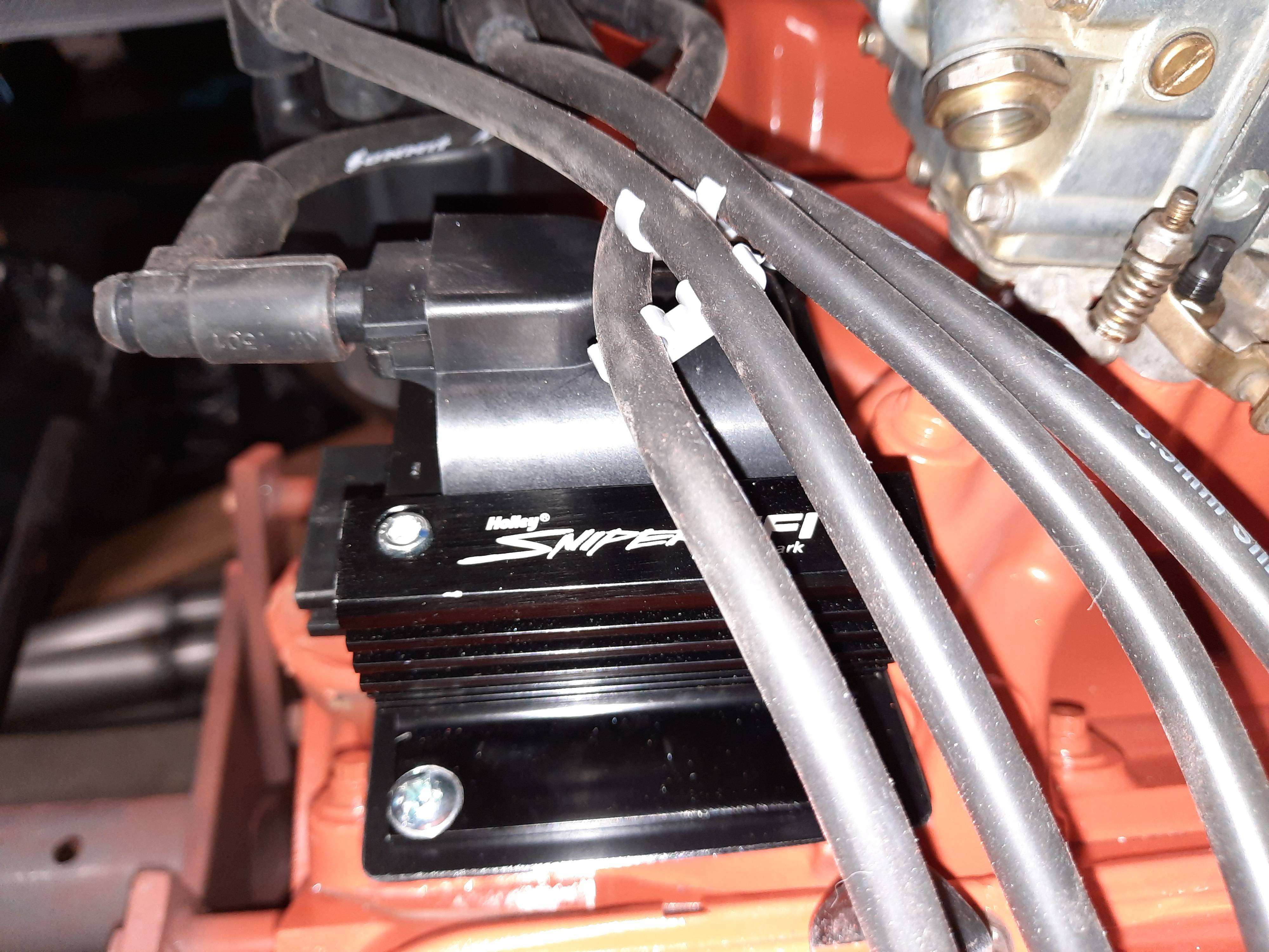

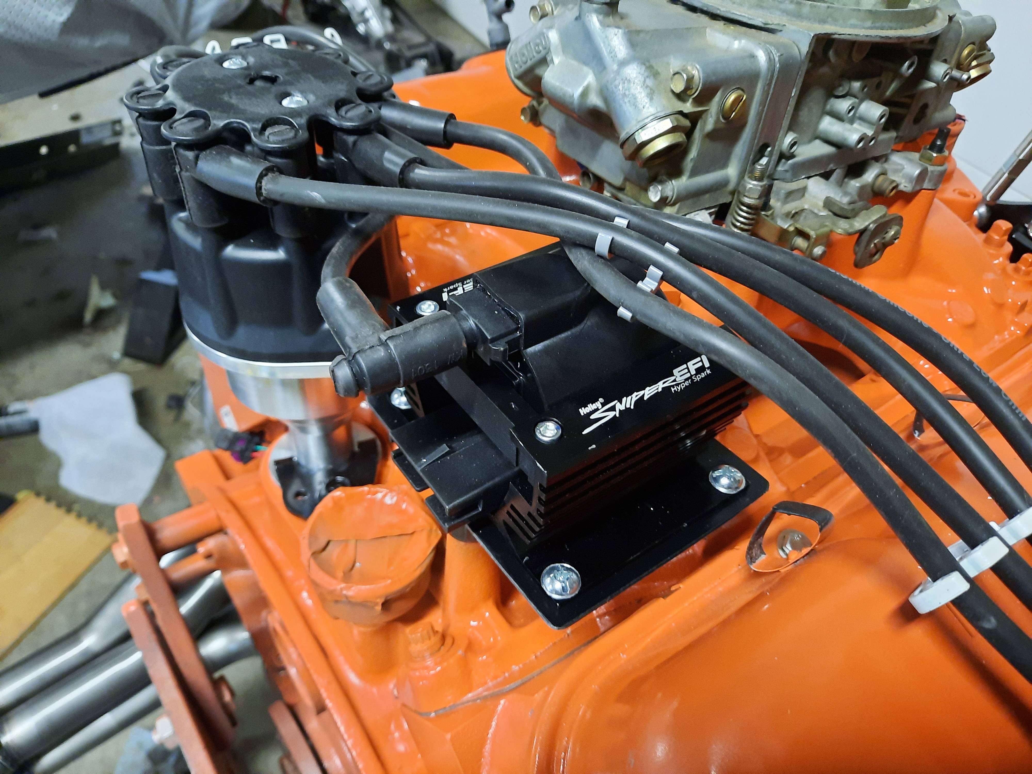

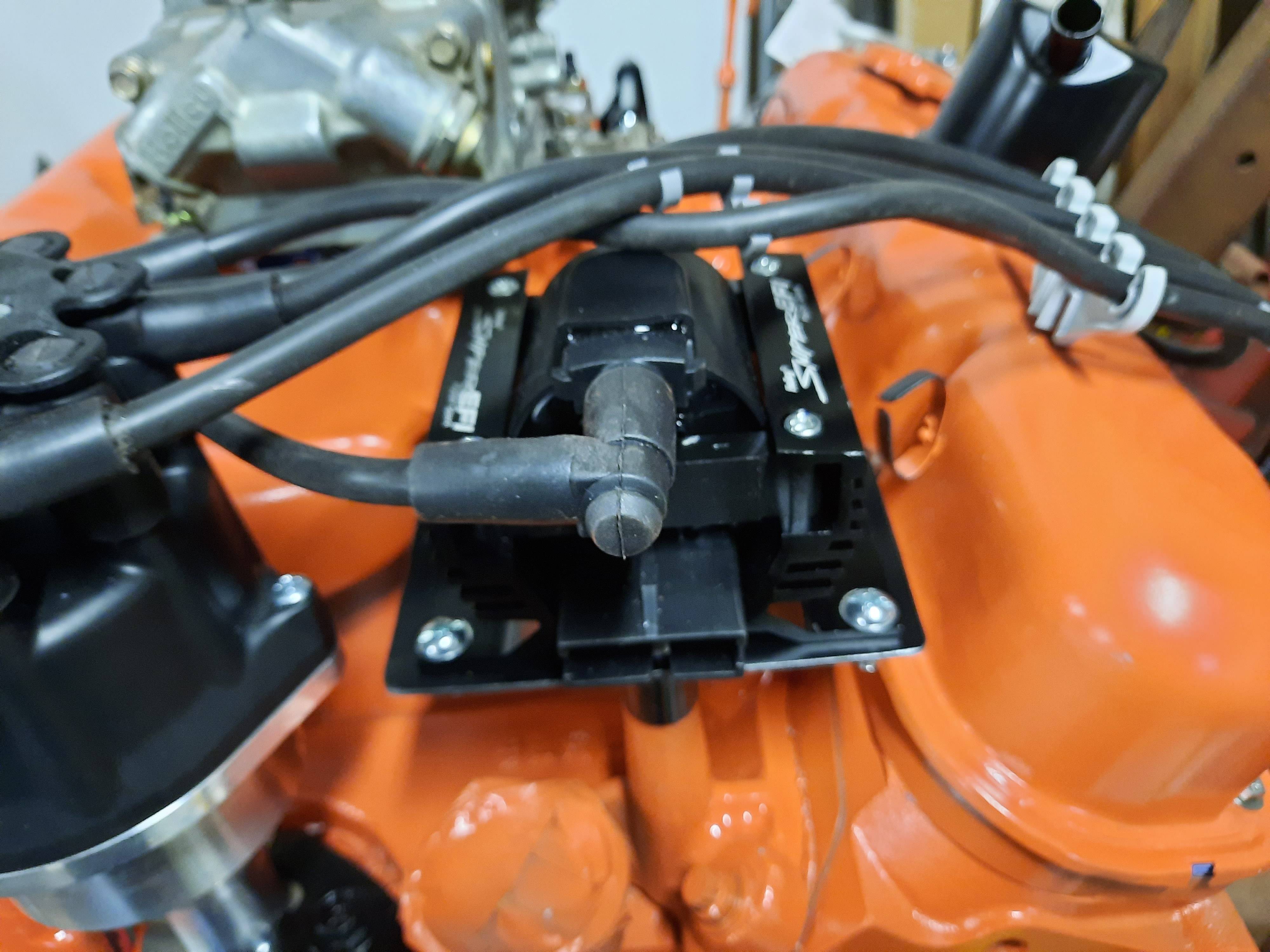

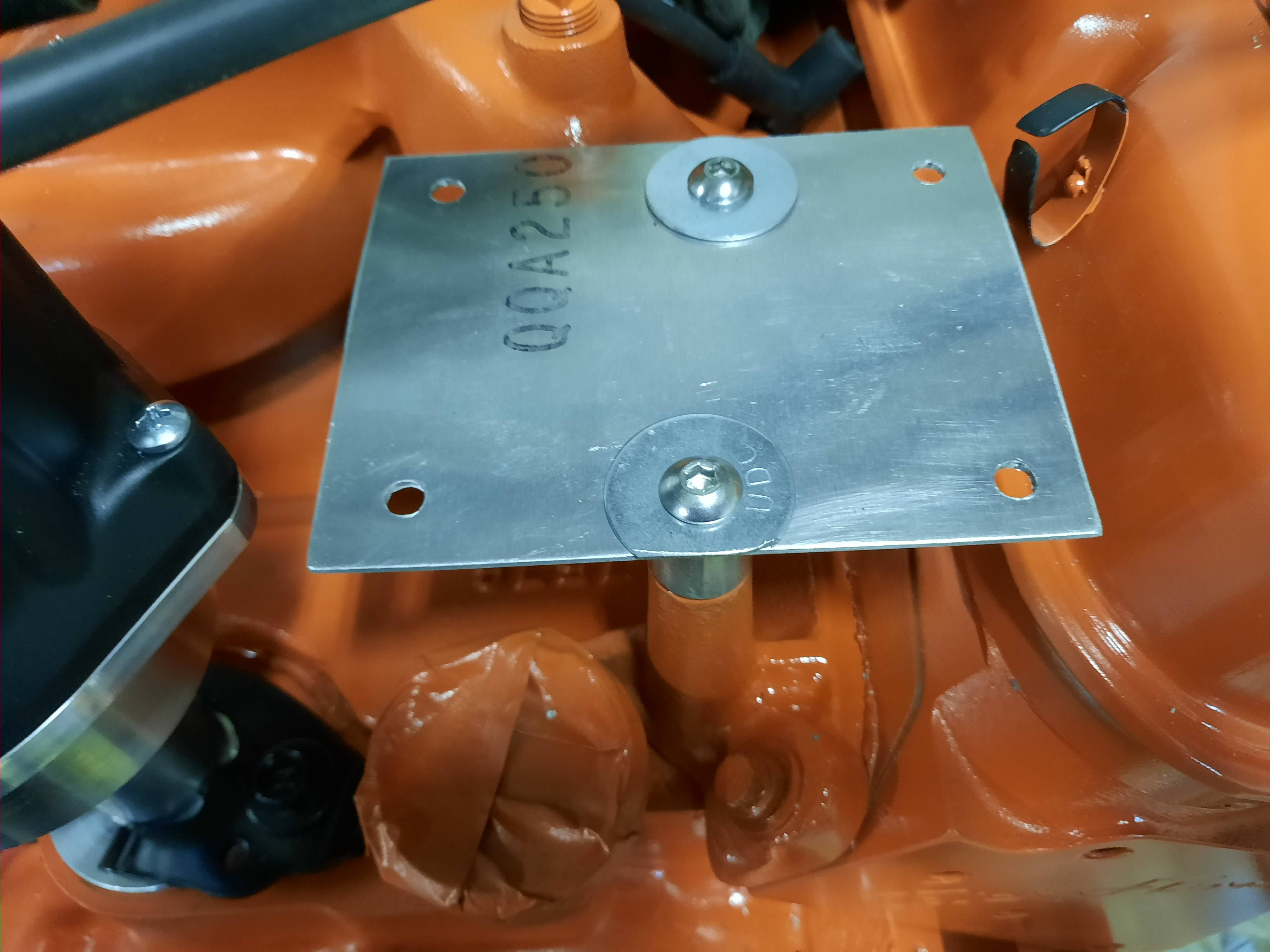

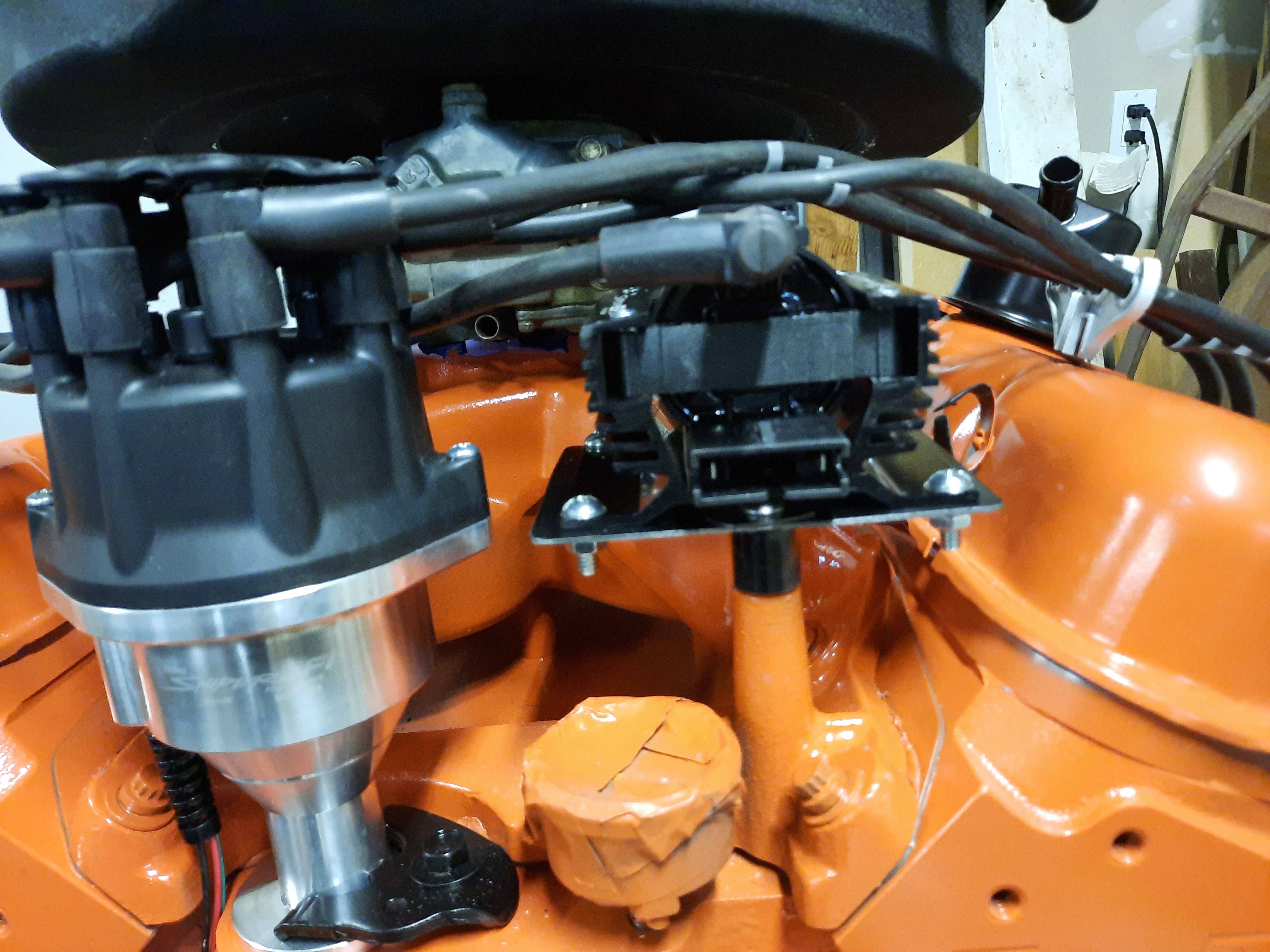

I was determined not to mount the coil to the firewall, so I spent a good part of the day fabbing a mount using the coil mounts on my RPM Air-Gap manifold.

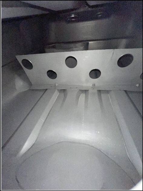

I noticed your tank has fewer holes in the baffle for anti-slosh. I saw that you ordered the Holley Sniper tank kit. I wonder if Tanks, Inc. (Holley's source vendor) followed what Holley spec'd for the baffle versus there own specs? Hmm.

Dr Eamer Nice installation of the coil
It is interesting that the fuel tanks are identical except for the number of holes in the baffle. How old is your fuel tank? I bought mine from eBay and the previous owner had bought it in the past but had never gone through with the project so perhaps mine is an older unit therefore older design.
I don't know why there needs to be any holes in the baffle at all because the sides of the baffle don't seal off any fuel so fuel is going to get to the front of the baffle anyway

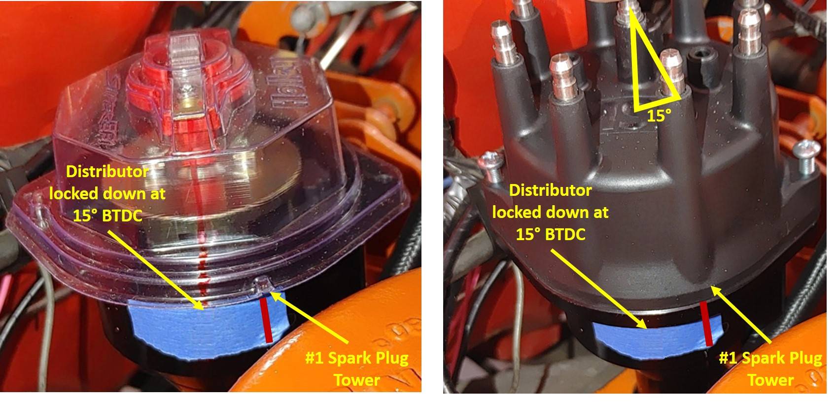

Re-watch the video at 02:05 (Note that his mark is made at the clear cap detent which is the #1 spark plug tower, not at the rotor tip location which is 15° BTDC:
This graphic should help everyone see how this works to lock down the distributor with a built-in 15° BTDC timing reference angle.
I just received my tank at the end of February.
The baffle prevents excessive foaming (aeration) of the fuel on acceleration/deceleration. The pump sump obviously keeps the pump submerged very well.

First check the timing using the Tuning -> System -> Static Timing and run the engine at 15 degrees BTDC to ensure the distributor is installed correctly. If the ignition is switched off the timing will automatically go back to the ignition curve in the program so if your timing light is acting up and you shut off the engine and then start it back up to do the 15 degrees procedure you will need to go back into Tuning -> System -> Static Timing and start over.

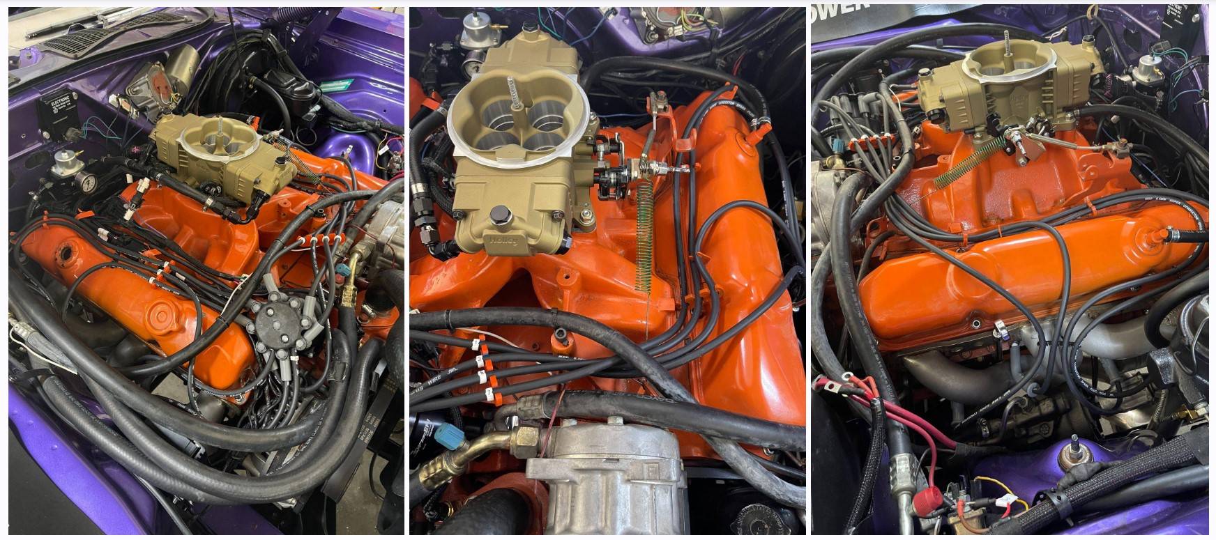

Following up on my Holley Terminator X Stealth 4150 installation. This project was a lot of work but has been the best tuning improvement ever for my Cuda. The timing control of the Hyperspark ignition and distributor worked perfectly from the start <<pun intended>>. Here is final result and throttle response is instantaneous. I will post a new thread with more installation pictures and some lessons learned very soon.
Very similar to how I mounted my coil on my LD340 manifold for my Hyperspark coil.
