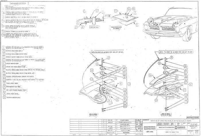

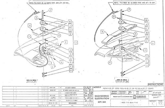

Pins are installed with hole fore and aft. The round portion of each clip faces outboard. In other words, each clip's round portion faces to the fender. Diagram is for both B (Barracuda) and J (Challenger) models.
