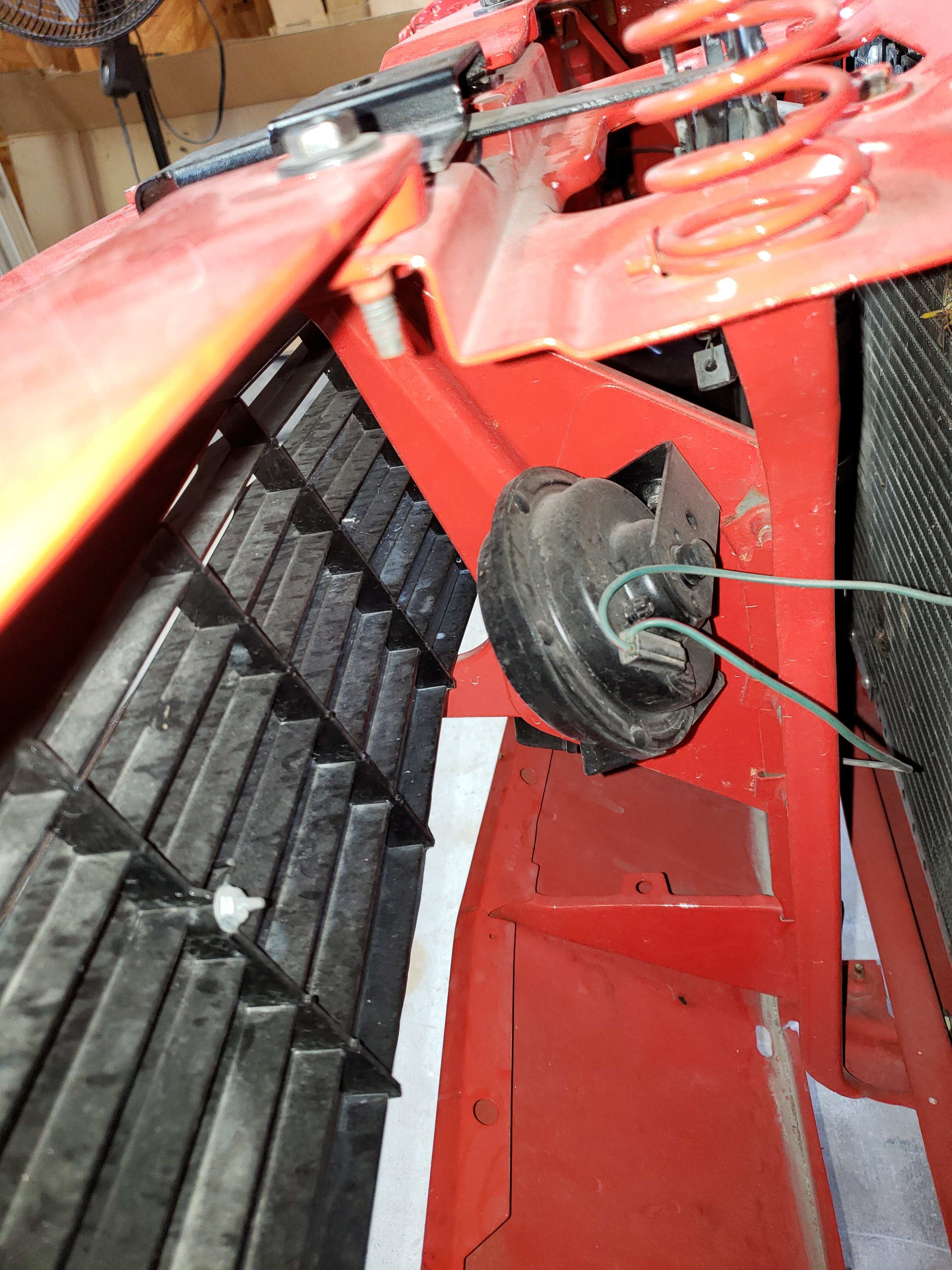

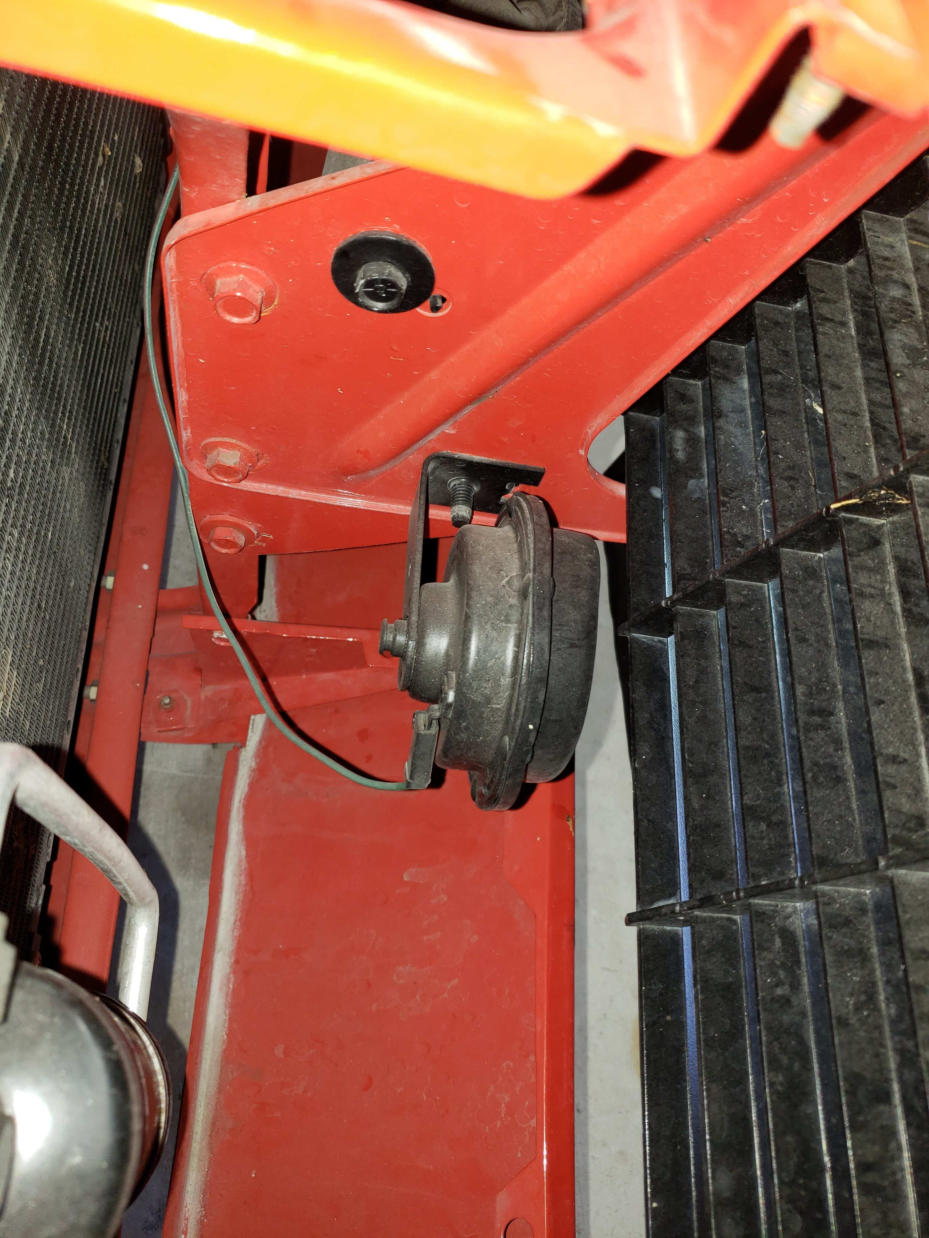

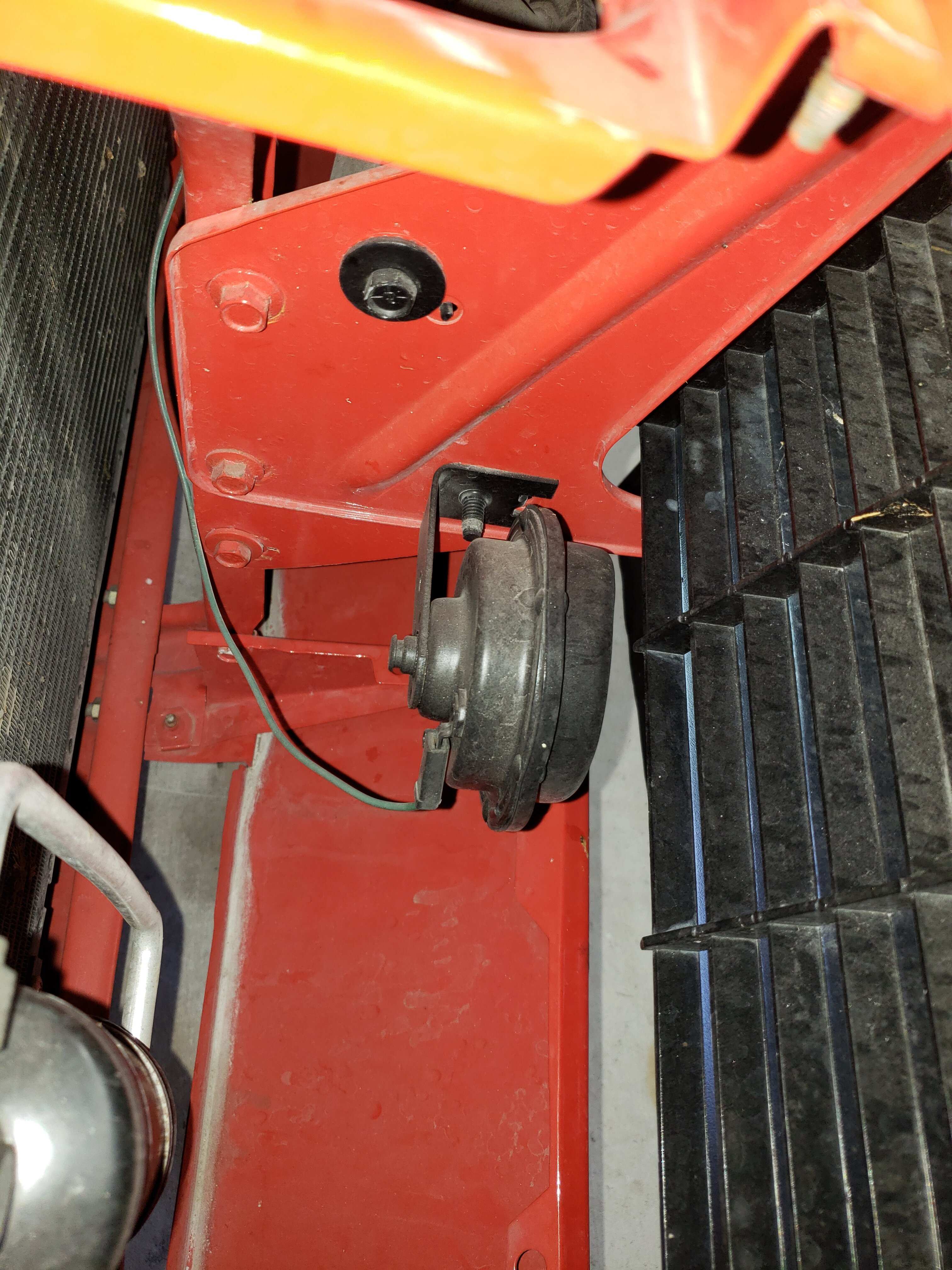

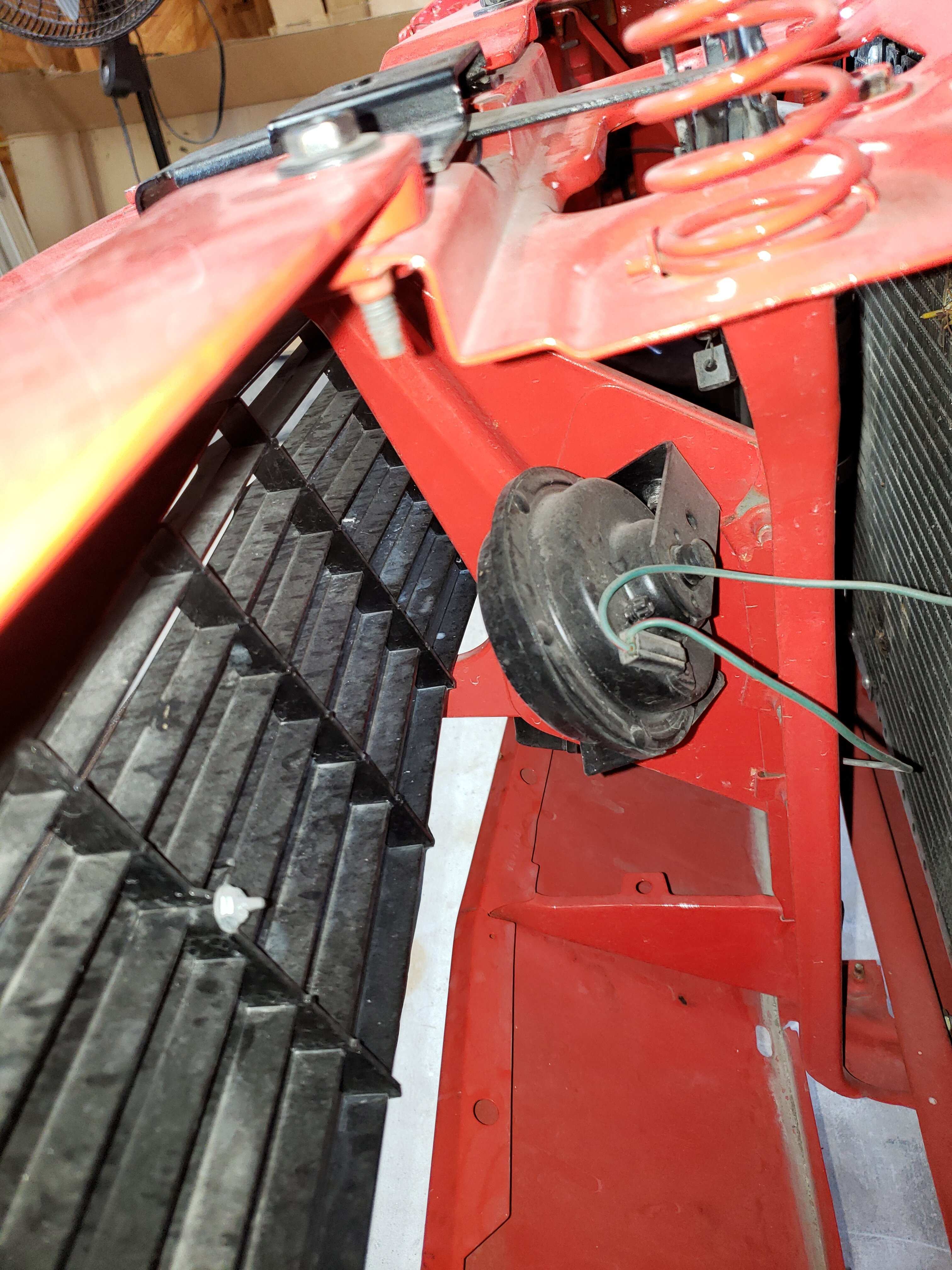

On my 72 challenger they are mounted on either side of the vertical support in front of the radiator.

On my 71 Cuda they are both mounted on hood panel latch as above, in front of radiator, and one horn is above the other. I'm pretty sure it is original installation because I've had the car almost 40 years. Although they could be placed on opposite sides.
