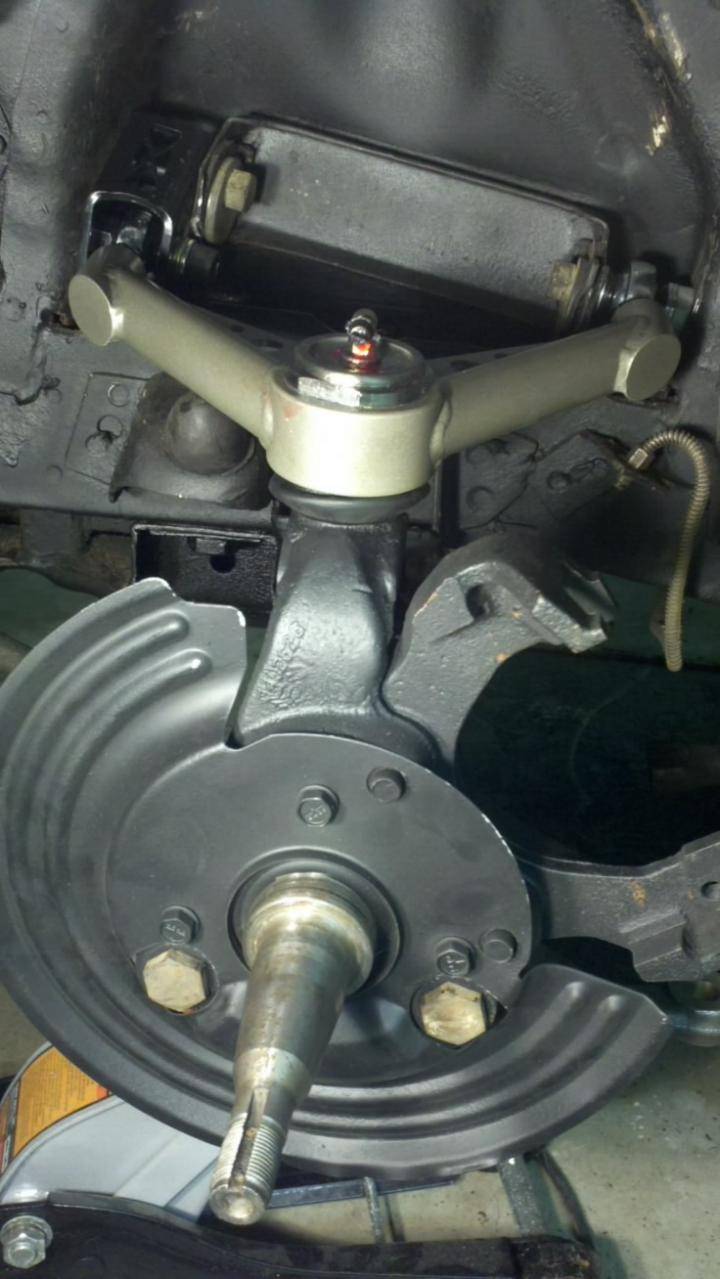

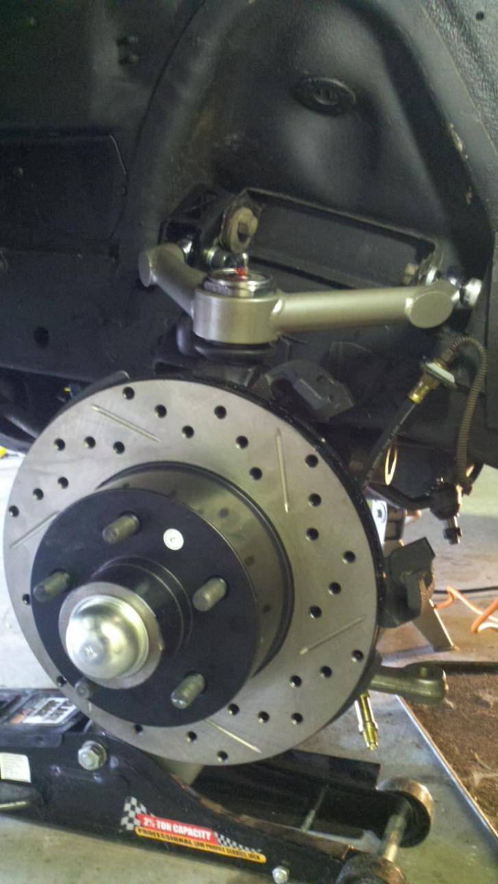

just hooked up the Hotchkis UCA's. Went together real nicely and is excellent quality. Cant wait to get the steering linkage & T-bars installed to get this thing on the ground!

Nice job! Nice and clean! They are a bit of work to set up as you have to disassemble them to make adjustments. But worth it in the end.

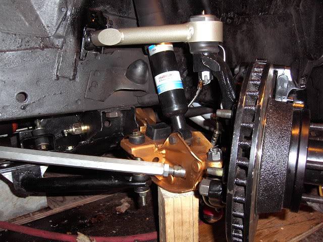

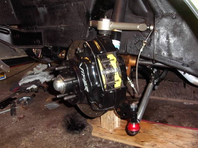

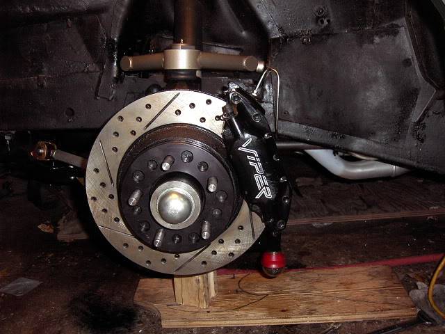

Here is mine.

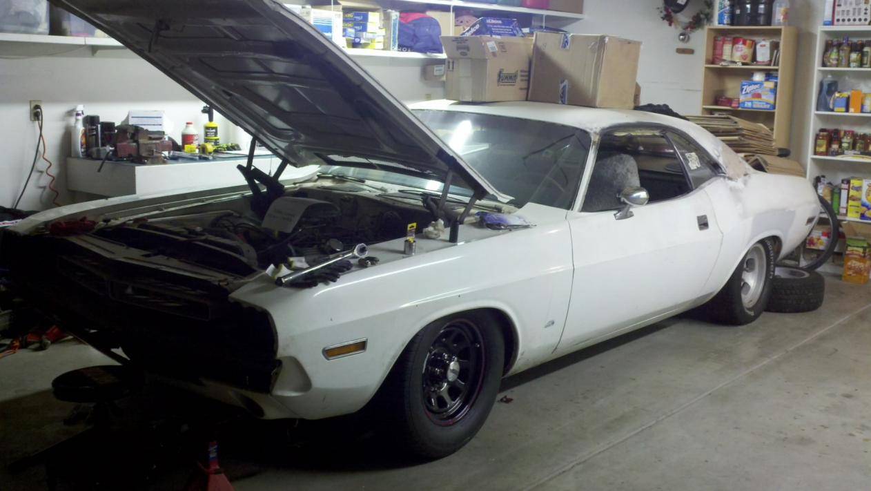

Wow, rad! Yes not lookng forward disasembling them...just had to take my best guess. You have the tie rid sleeves and strut rods I want (not to mention the brakes!) but I'm getting there. Running stock sleeves and rods until I can save up. Just got it on the ground today too and must have forgotten to center the steering gear or something before putting linkage back together...turns a ton in one direction but only 1.5 turns in the other. :eusa_wall: Bummer...will be back on jacks tomorrow for a bit.
What kind of finish is on your lower arms btw? Or is it just shaded funny in the picture? Also, do you have any pics handy of your center link? I cant tell from the manual which way it should really go in. Thanks so much for sharing Brads70!
.....Anyone else out there running similar setup and want to share too?

It's just a rattle can paint job on my LCA's. It's an A-Body arm not a E-Body. I used a B-Body center link, I found it gave me slightly better results when setting bump steer. Tie rod sleeves I made, I used a stock inner tie rod and a howe quick bump kit for the outer.
