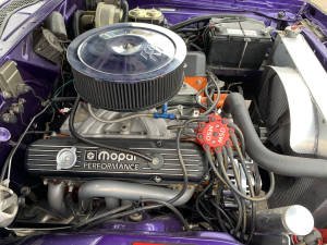

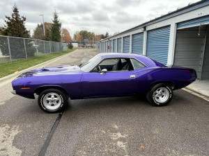

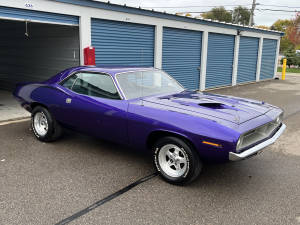

Here are a couple of pics from the listing for the car. DetMatt - you may know this car? The prior owner was in the Detroit metro area and reportedly enjoyed participating in car shows, etc.
The son, who was selling the car didn't give me much information about it, maybe he didn't know much about his dads car obsessions? He did say his dad "finished" the restoration in the 2001 timeframe. It looks like an original white car. Anyway, vin shows it was a 318 Hamtrack car, with AC. I was told it sat for about 10 years before I bought it. It doesn't have a fender tag. The car currently has a 440 with a '78 casting number on the block - originally a motorhome engine? Torker intake with a Demon carb. The trans has a reverse shift valve body with no kick down rod, and an odd cable control shifter. The 8 3/4 rear has aftermarket axles, 3:91 gears and posi (spool?). It has headers and what I think is a 3" exhaust with crossover. It fits OK, but it's tight. And loud.
It needs a lot of work.

Welcome to the show. Nice looking hot rod. If you go slow in a very tight turn, and the inside turning circle rear tire chirps/hops a little, it's a spool.
