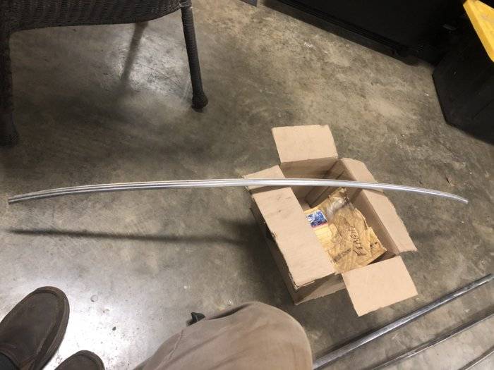

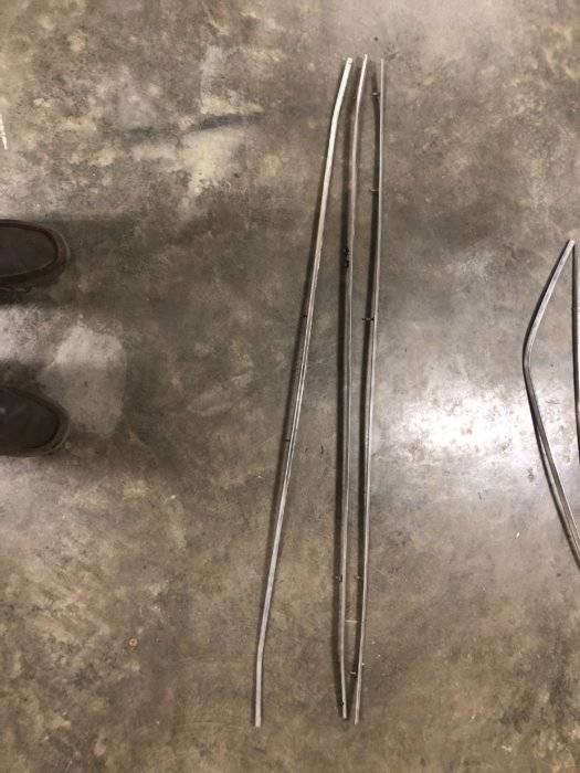

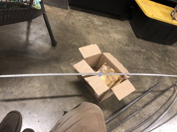

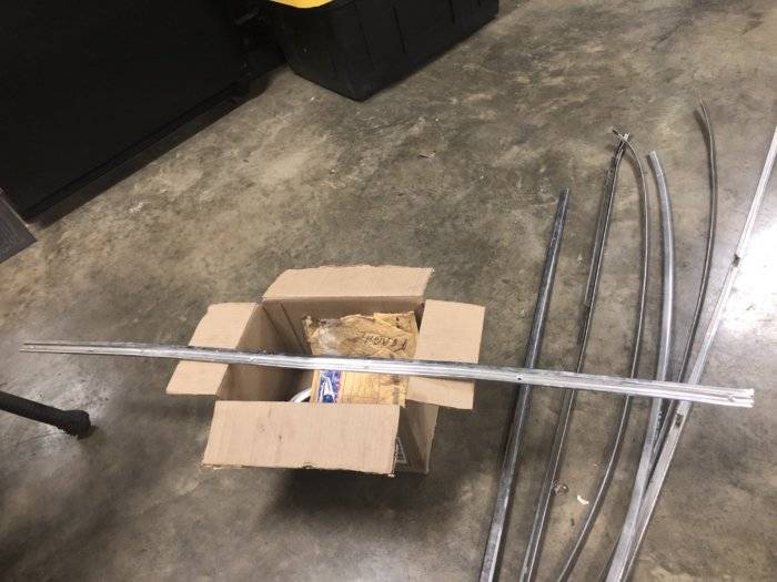

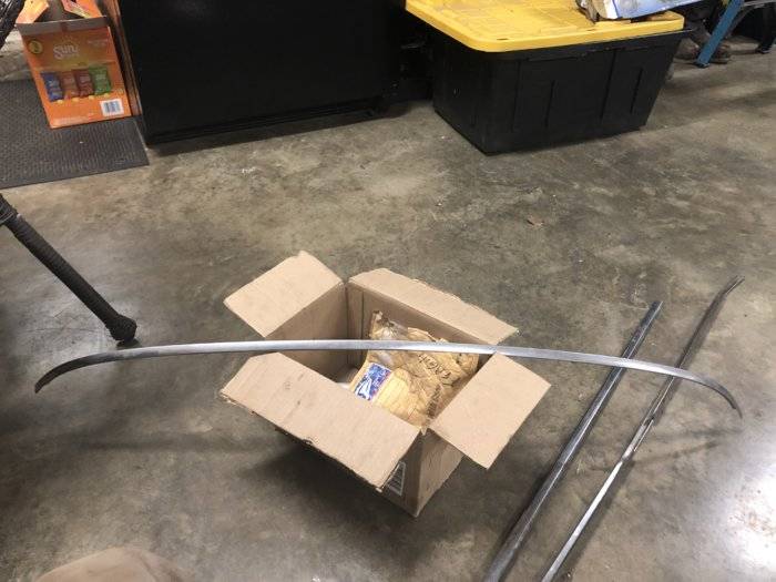

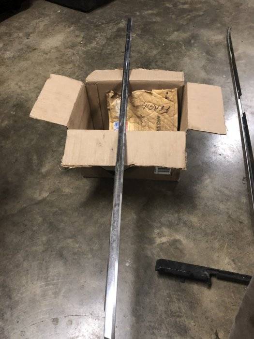

help needed and appreciated ! I need to know what this trim is. Thanks ps some wiper Motors too

You have the front vinyl top molding clips, the 2 small parts in photo #3. Photo #2 are body side moldings. Drip through moldings, rear trunk lid molding, hard to see detail in some pics. Real easy to tell if you have a Challenger. Just match them to the body.

In post #1, the first trim photo is the vinyl top molding below the rear window and wraps around below the quarter windows.

You have a few B body mouldings in there. Compare them to 69 Road Runner mouldings. I'm using a phone to view them right now. Too small to tell exactly what is what.

I believe the last photo #2, the 2 pieces of trim taped together w/yellow tape. For an E-body w/ a vinyl top these are the trim pieces that cap off the vinyl outside on the A pillars. One for each side.
