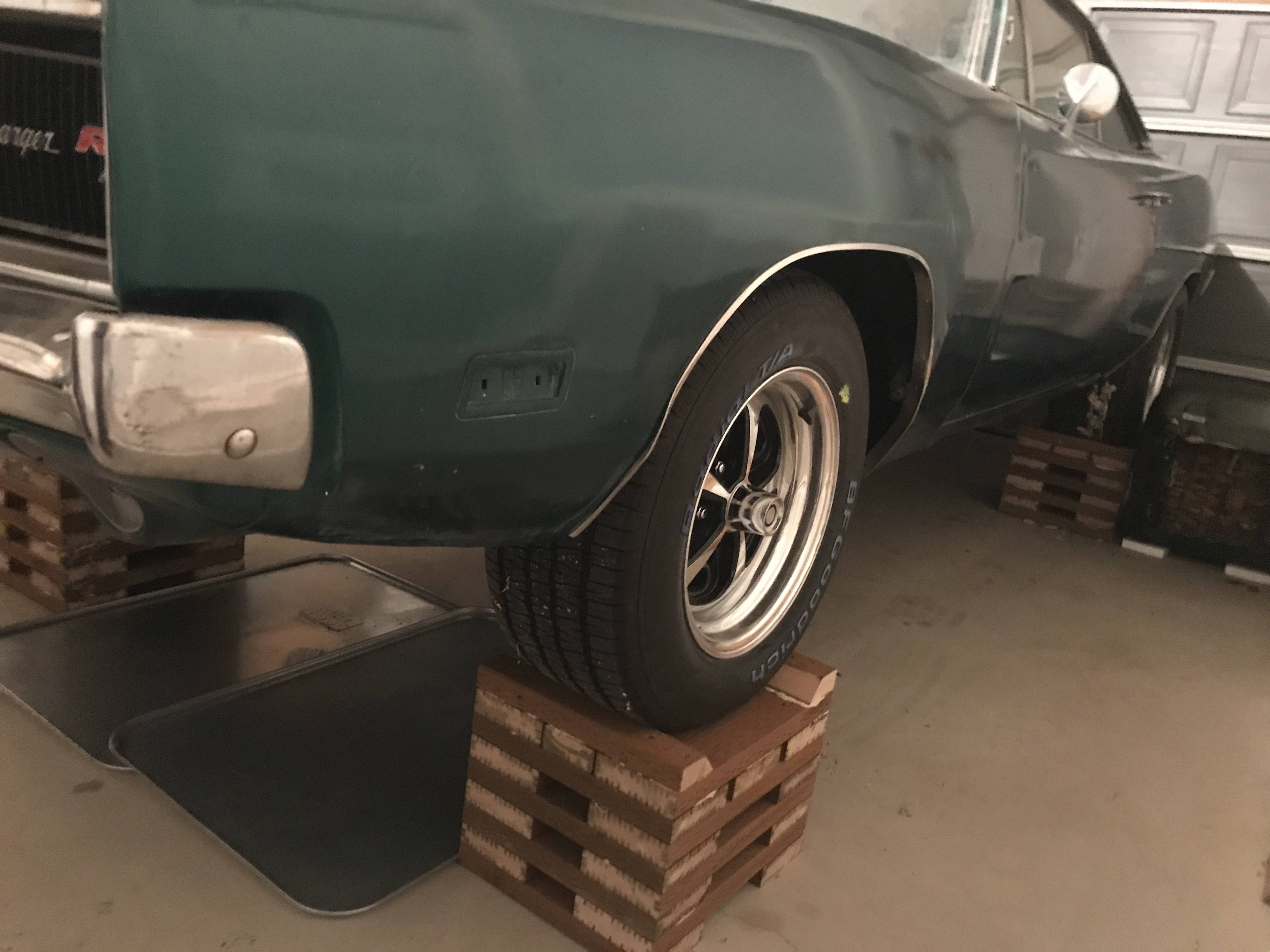

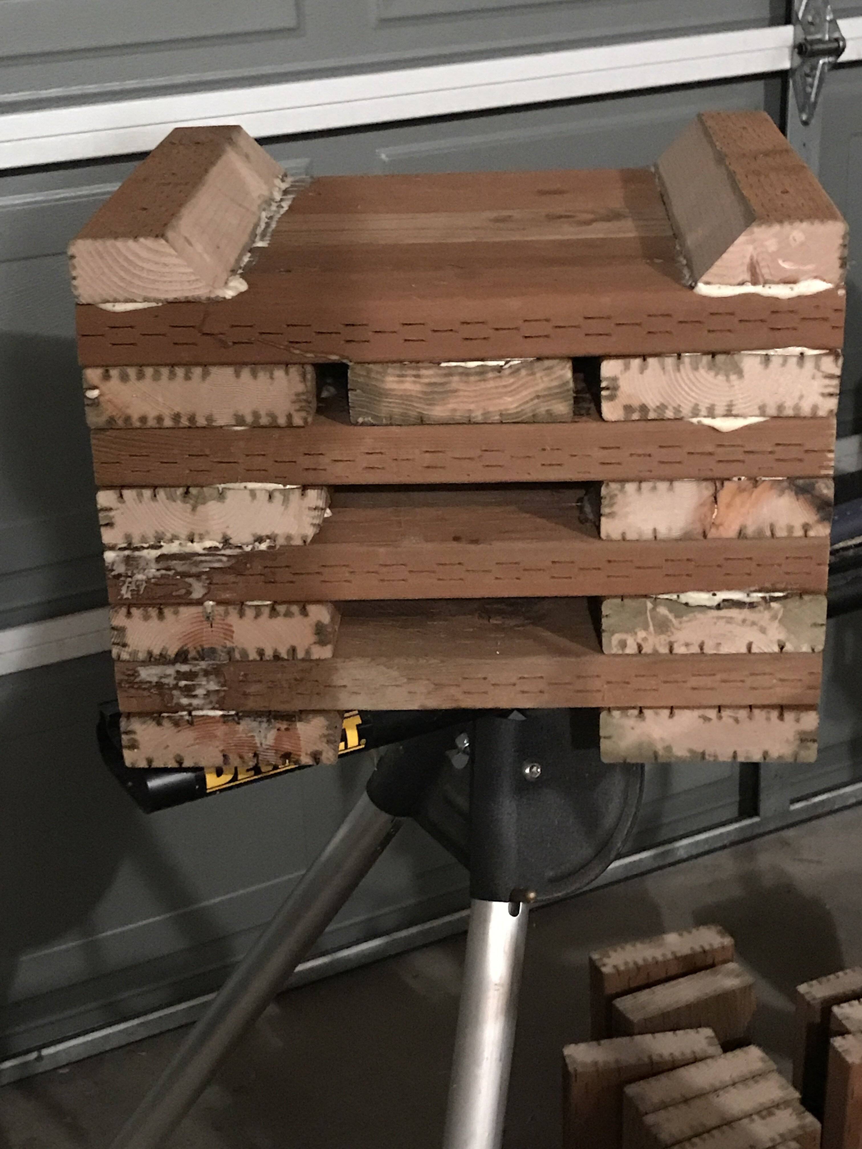

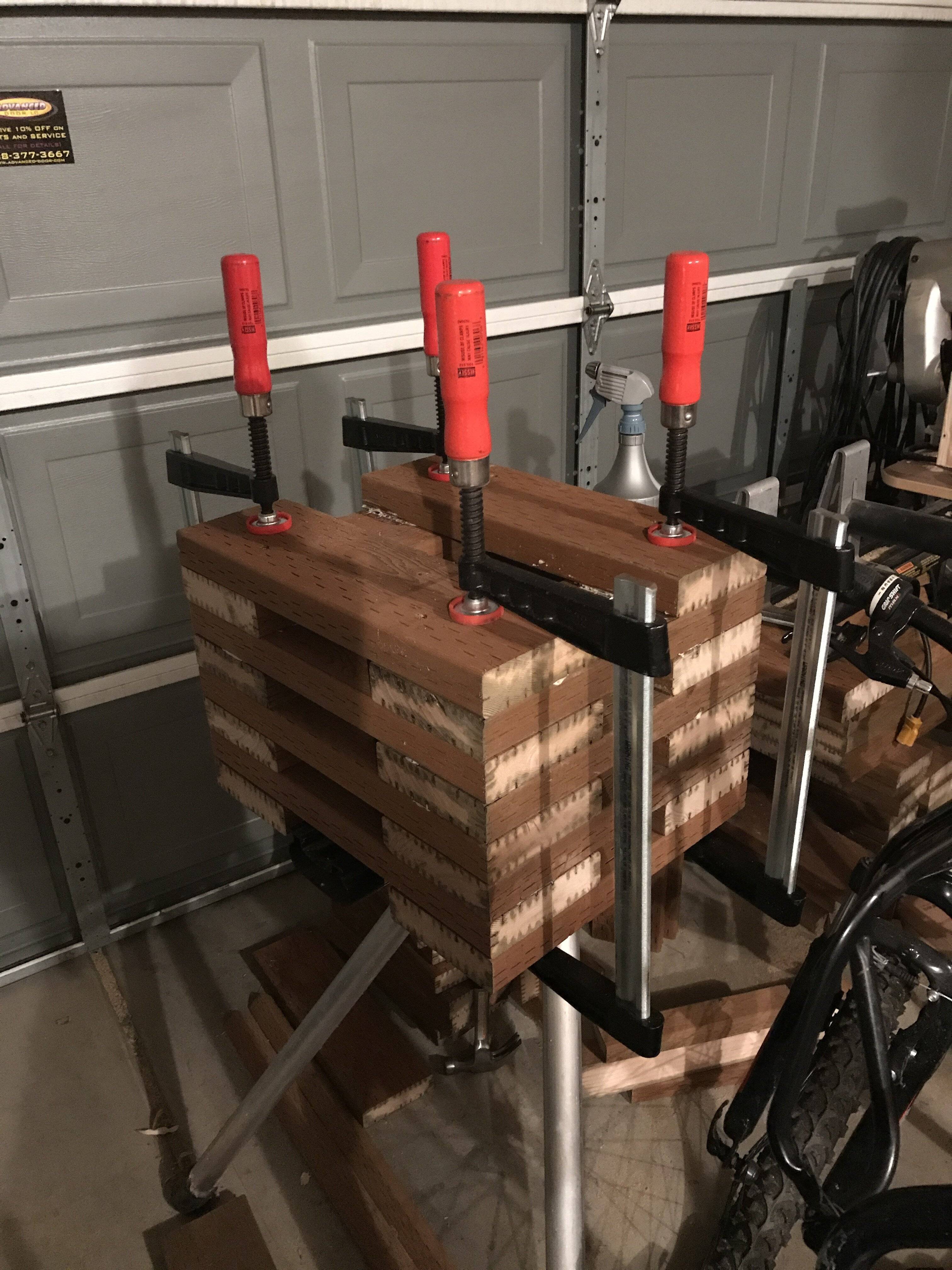

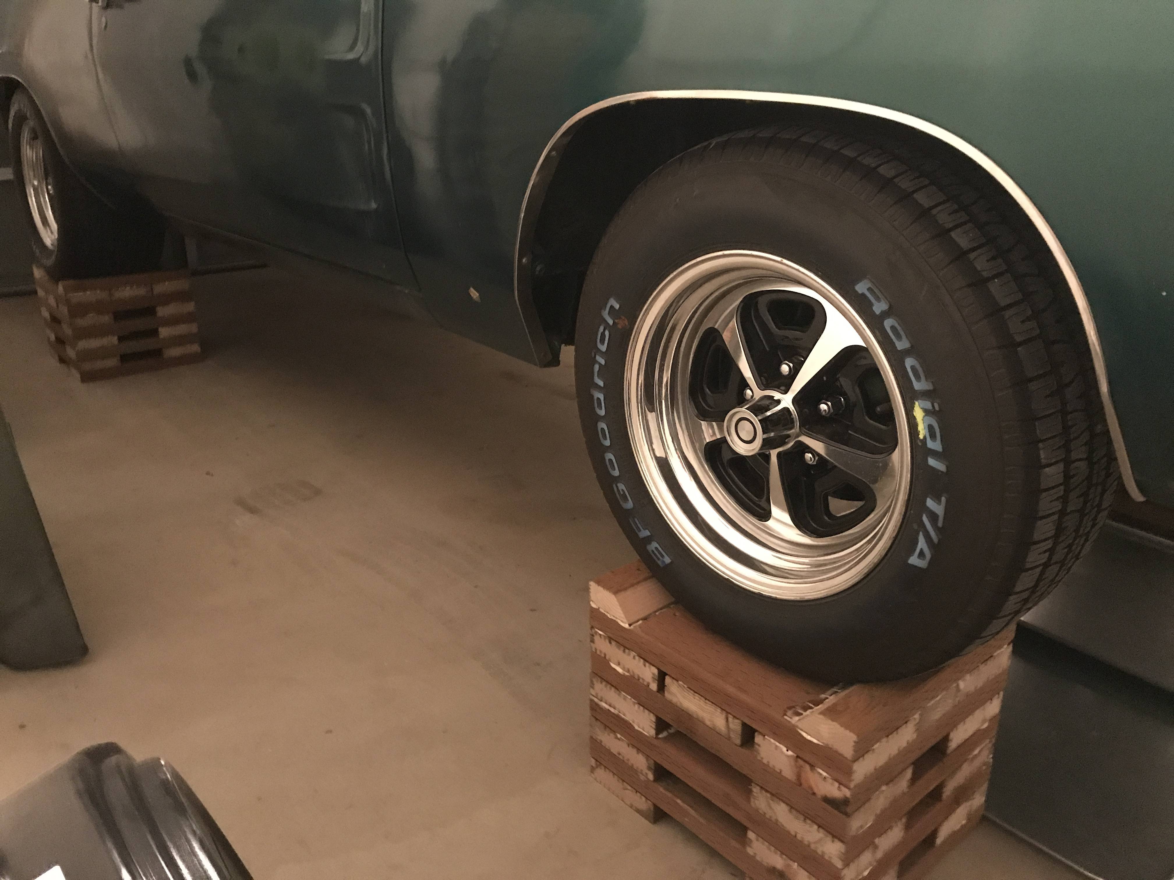

Last time I installed exhaust on my car, I used jackstands, and when I was fitting the pipes on the car, it started to rock. So that was the last time I used jackstands, I made some wooden cribbing, made it safer to crawl under my car. You can make them as high as you need, but I wouldn’t go over 14 inches.
Avalanche
Sep 1, 2011
581
78
Massachusetts

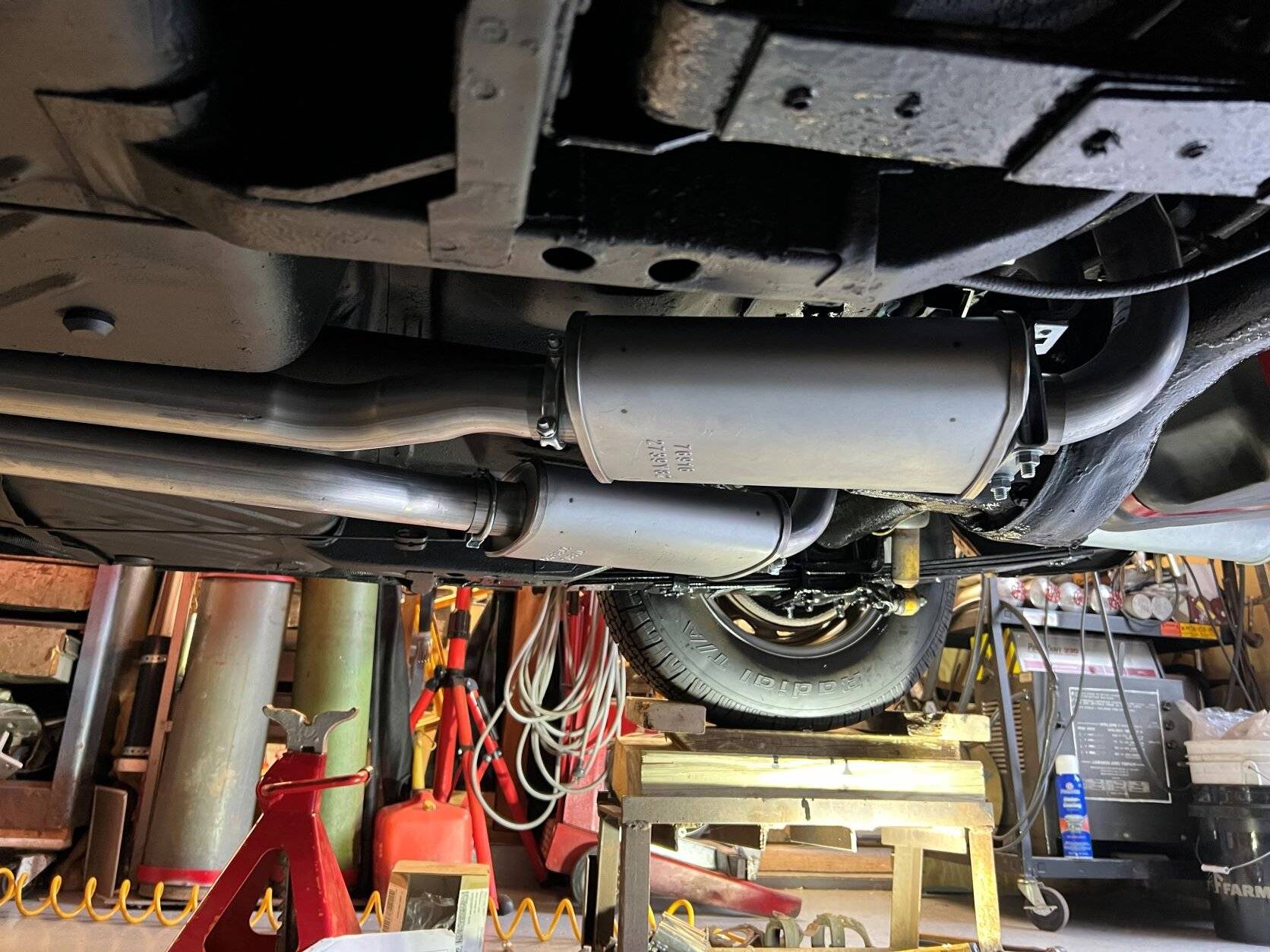

View attachment 95277View attachment 95278View attachment 95279View attachment 95280
Those look great. I have to make some for next time I'm under the car.

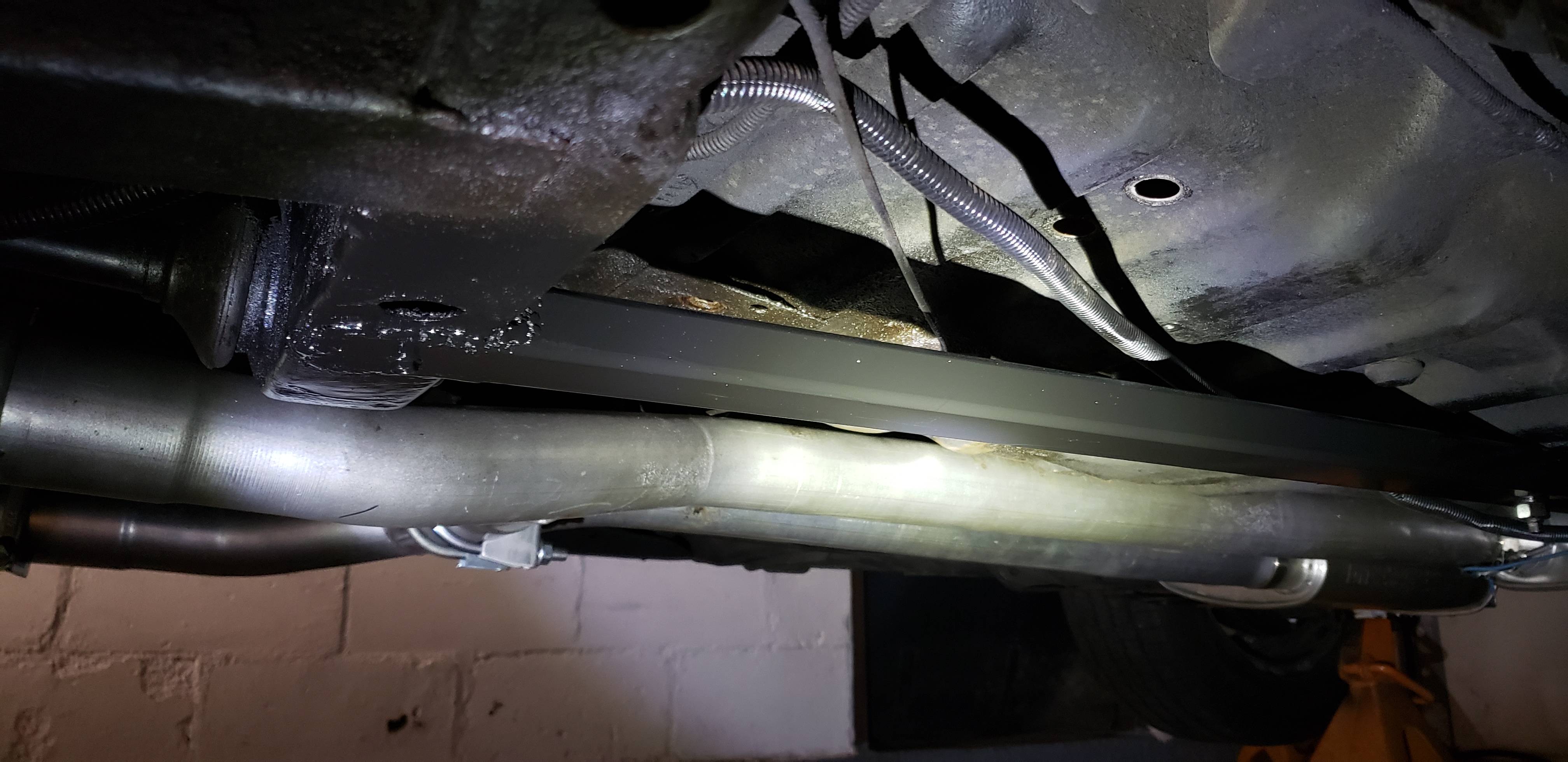

That said, I did mine on jack stands. It was the headers to the over the axle pipes. It’s not pretty.
I recently bought an H pipe kit to bolt to the headers so I will still need to fab up 2 pipes to bridge the gap.

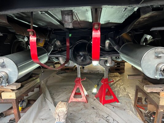

I put on TTI system, from stock manifolds to tips, on car ramps up front and jack stands under the axle. Plenty of room to do it in garage by yourself.

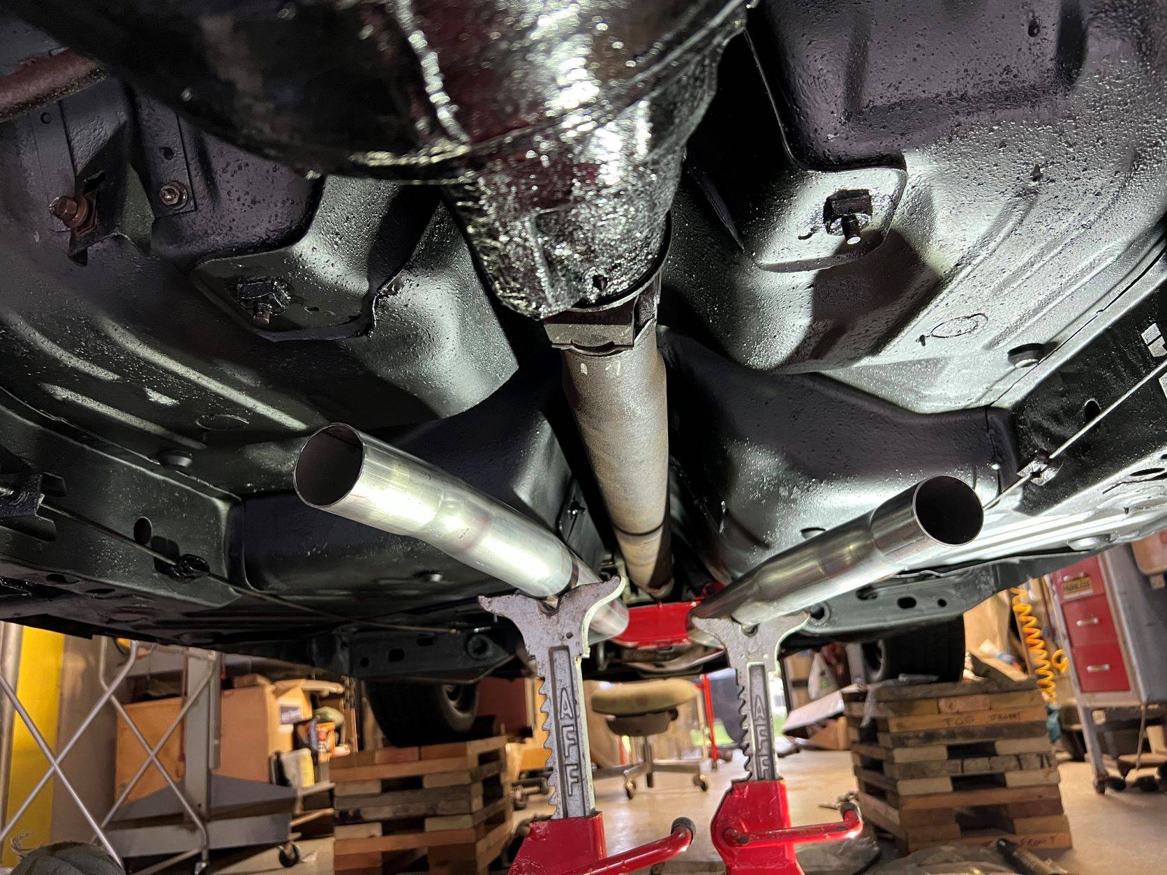

Did 2 complete exhausts on my back in my 1 car garage with the car on jackstands from manifolds to tips, selling one of the packages now, TTI x pipe 2.5” with dynomax ultraflow mufflers for cuda (with the polished welded on tips)…

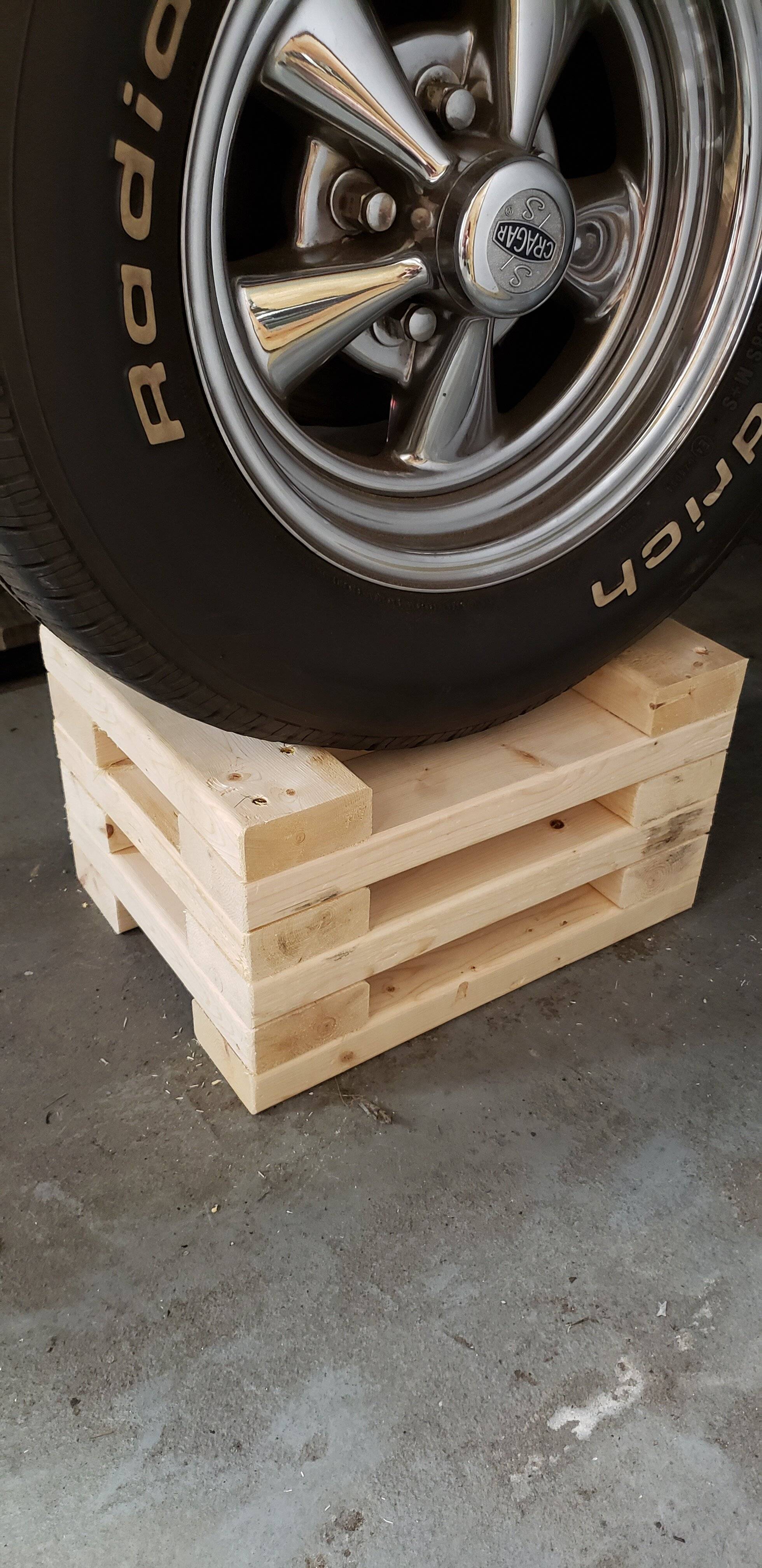

If using jack stands, get the HD 3 ton ones. They are much more stable. I just did a 4 speed swap and TTI exhaust on HF 3 ton stands. I also made some wheel cribs for installing my frame connectors. They work great also. Be safe!

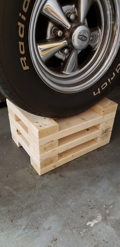

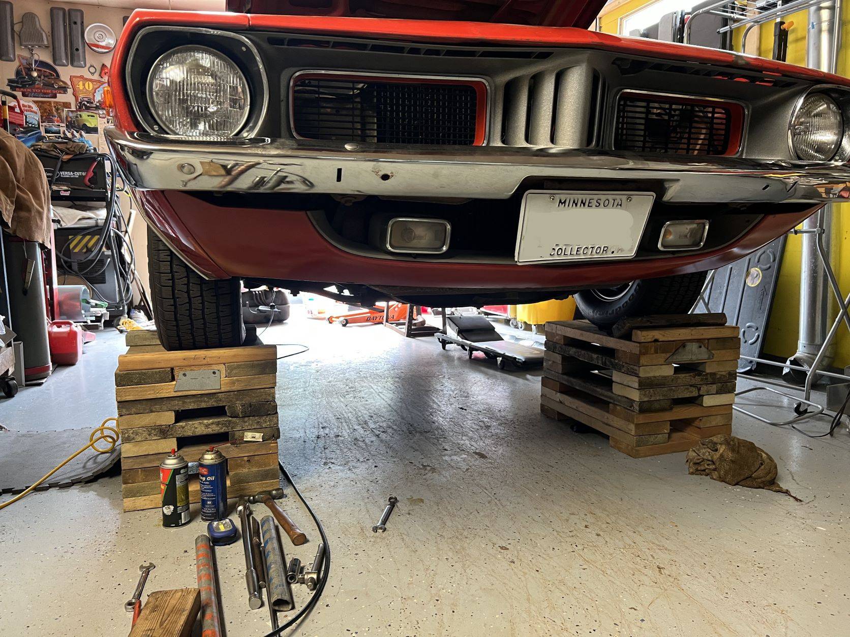

Looks like everyone seen the same posts. I used 2x6 screwed together and I stack them. Worked great enough room to work for me.

How do you get the tires jacked up that high to get that much blocking under them?
73-Cudah2
Sep 9, 2021
123
41
Minnesota

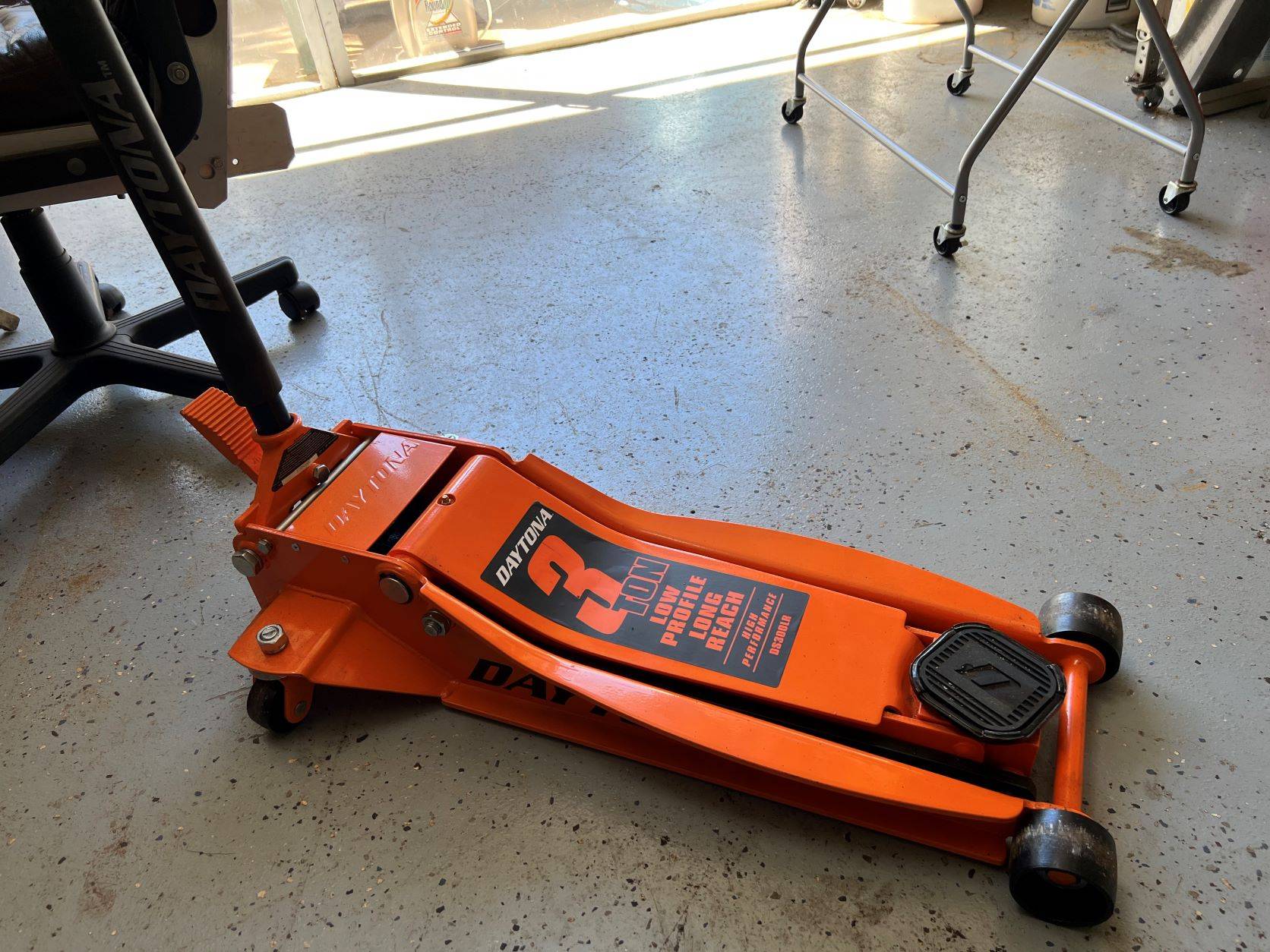

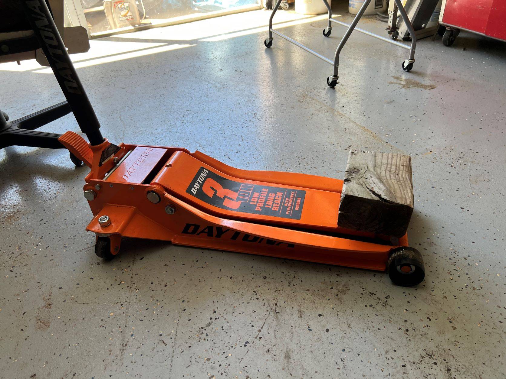

I have a HF low profile long reach floor jack with a little help ( wooden block )
use the block at your own risk!! You need to be careful the car is not move and the jack can move as it lifts.
