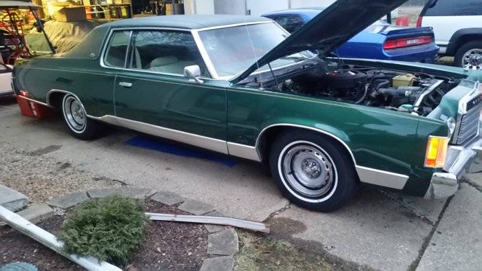

An 850 is perfect for a 440. I run a 850 on my bone stock 440 New Yorker with a little super power shot of Nitrous and this cars scoots for a 6200 lb tank. It just takes some jetting, secondary cam, and a/f adjusting to get it dialed in.

I stuck a 750brawler on my 340 which was all new everything. Ran fine for the first few rides and then was bogging and I tore the front bowl off to find the float had a pin hole in it. Was full of gas. Replaced the float and that carb is a good 1. Had an 850 dbl pump on my 440 with the .509 and was a great match. It was 4 sp with 3.55s. I blew that rear and went to 3.23s and actually liked those better. I'd stay with the 850 and do some tuning. Could have something stuck in it. Make sure its clean and I always throw a 50cc pump in the back. Don't drop more than 2 sizes jets at a time and stay consistant with the rear jets also. Good luck with it. Thats a beautiful car. I had to get the dog dishes when I checked out your garage.

replaced the needle and seat and was okay for about 2 days..now it is bogged down and won't restart unless i keep pedal to the floor and there's no fuel in the front bowl window.
Needle might be stuck and not allowing bowl to fill. Try unscrewing the float adjustment and check the needle isnt stuck.
