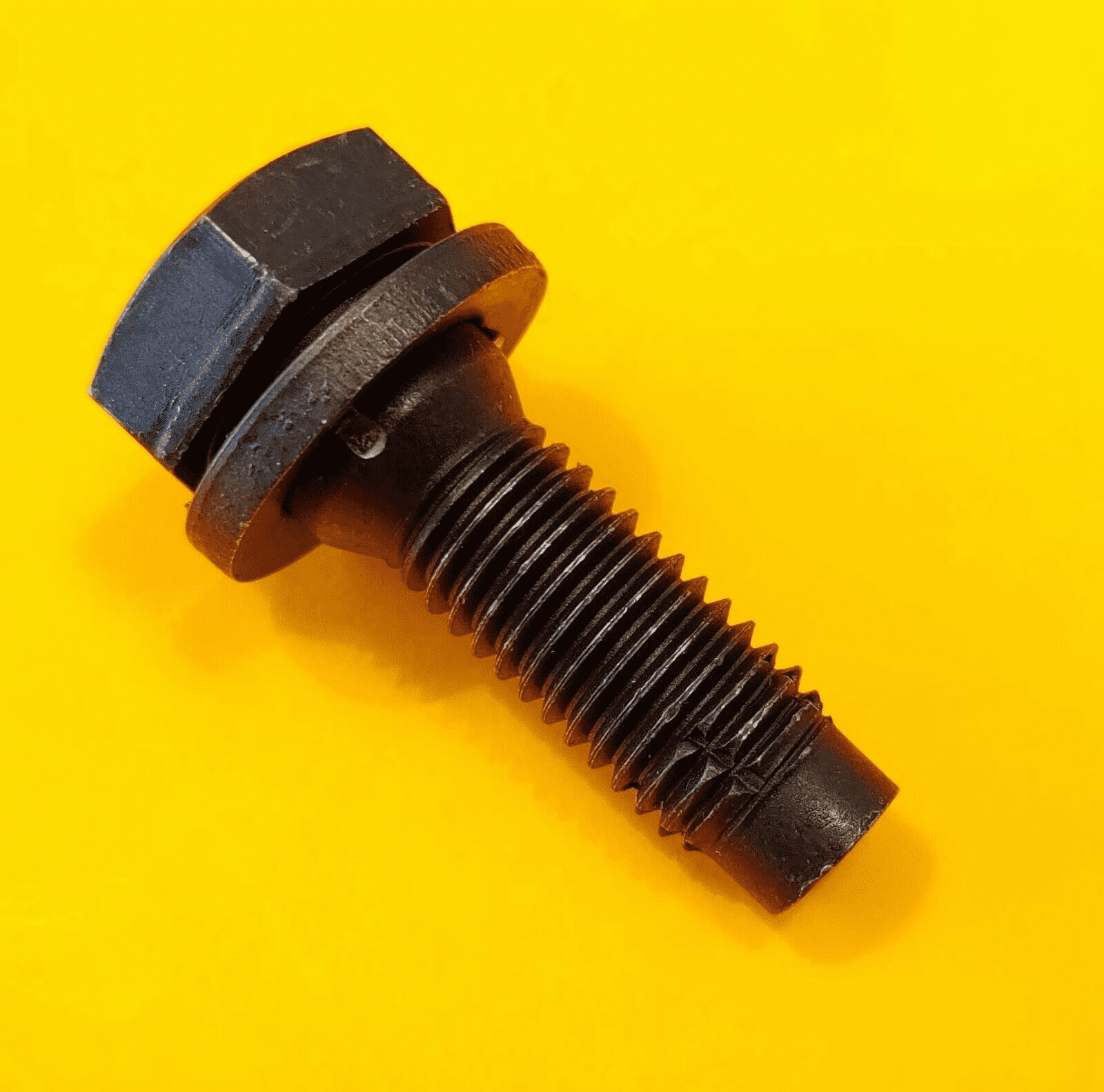

If you take notice to the thread they are cut. that bites into the other thread keeps them locked in per se.
