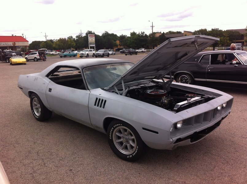

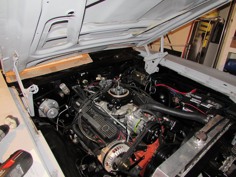

Here is my 5.9 magnum, now a 408. I have EQ heads set up for a LA intake and used LA M/T valve covers. All LA stuff bolted on, although I did fab up brackets for a Sanden style AC compressor. This is in my 71 BHG.
