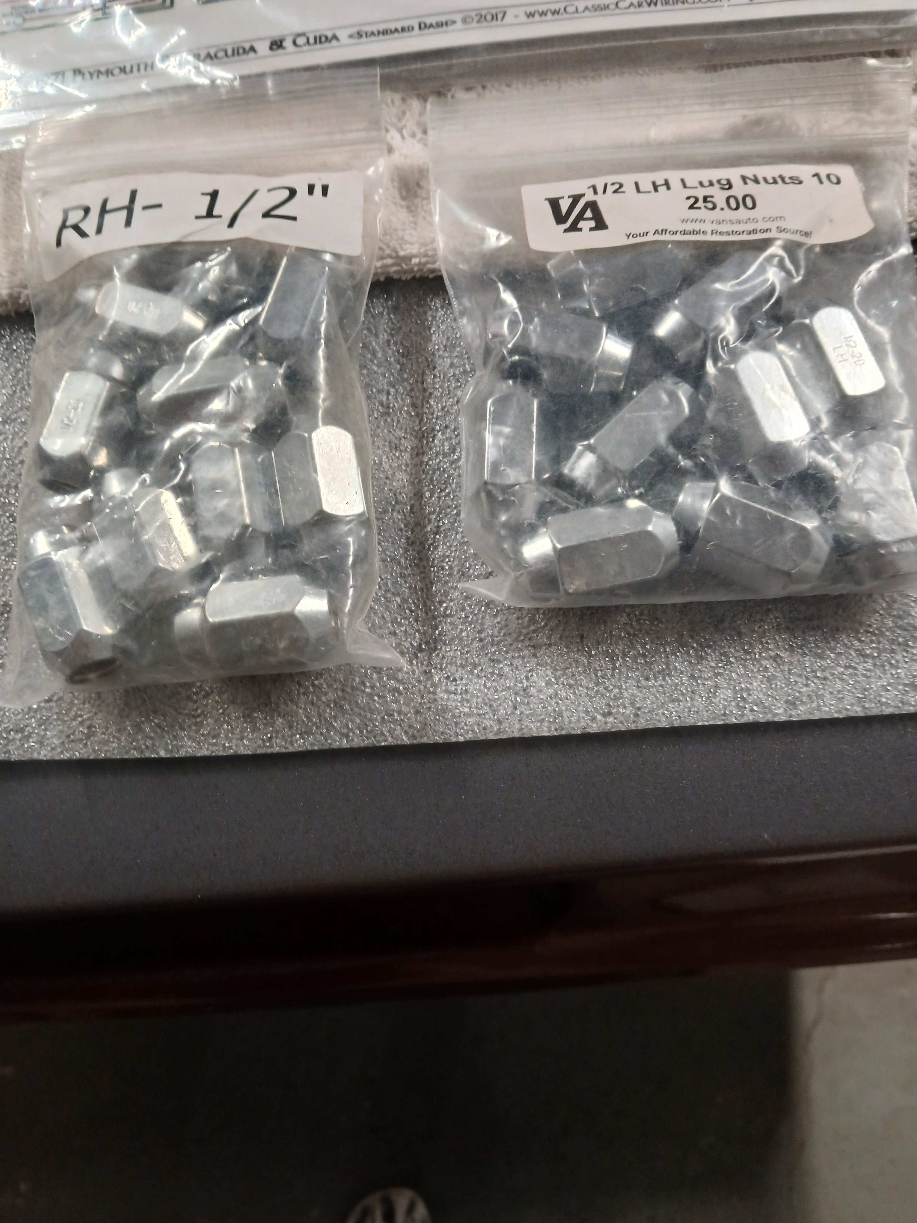

Right hand nuts on rear? Left hand on front. What's the deal on these nuts???

Well, another guy selling me stuff I don't need. Told him it was a 71!!! Who needs left hand tire lugs???

Yes, I am whinnying $25 could go to something needed. Get a lot of this from vendors that know everything about restoration of a 71 barracuda. I never got my hands dirty once, or even turn a wrench.

I agree what a seller claims to be accurate can be wildly... inaccurate. ePay is the biggest example. Unless I know what the accurate part is, dimensionally, and what it looks like, taking their word for it is pretty risky. But so, too, are other websites. Sometimes, the description is wrong accidentally. Other times, on purpose to make a sale.
If it's too much effort or expense to return the LH threads, just list them here and sell them to another in need. or ePay.
