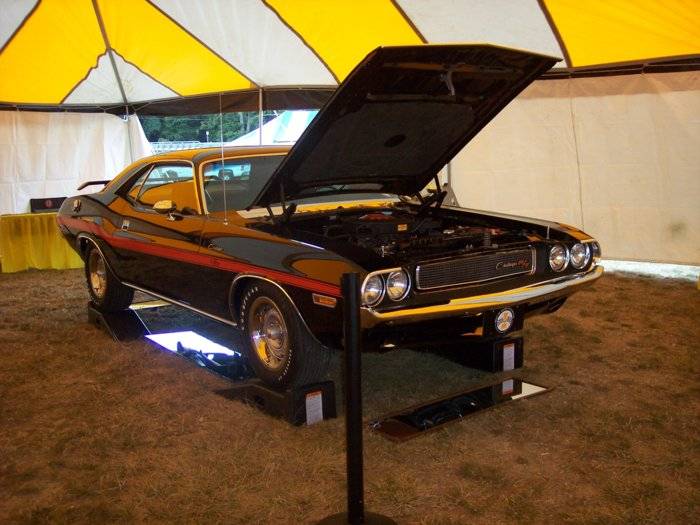

A buddy built this and couldn't fit into it. He now has a 70 Bee and loves it.
