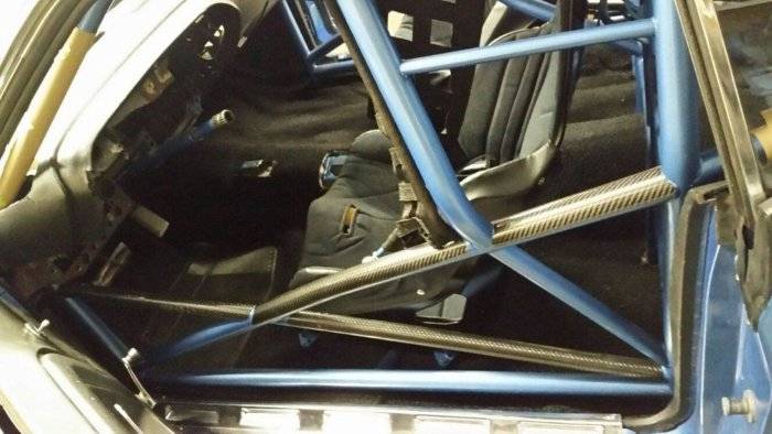

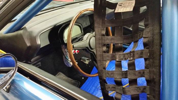

Try getting in and out of my 70' Challenger. Lol. At least I made a removeable steering wheel adapter to my wood grain wheel so that helps.
