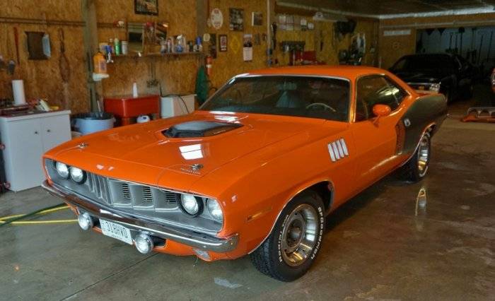

I am currently running an Edelbrock LD340 on my Cuda and feel it shaker sits a little low, buy which one you like and add a carb spacer or Air Cleaner spacer if needed.

Thanks Ross. Great looking car. I currently have an LD340 but the center is cut out making it a single plan intake. I wasn't certain that would work on my mildly build 340. Not sure what impact that would have on the performance. If anyone knows please let me know.

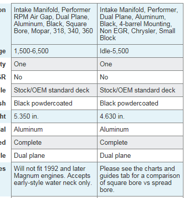

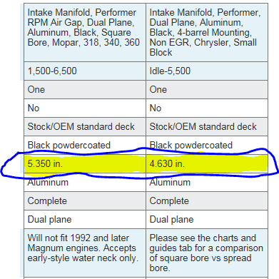

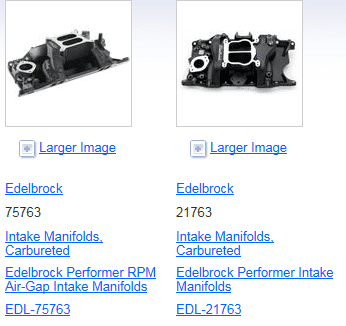

I think I have it narrowed down to these two. Yes I want powder coated black. I've measured my LD340 and on average overall it's about 5-1/4" tall. Each corner was slightly different with the straight edge. I'm thinking of the RPM Airgap because It's slightly taller and you said you still have room with the LD340

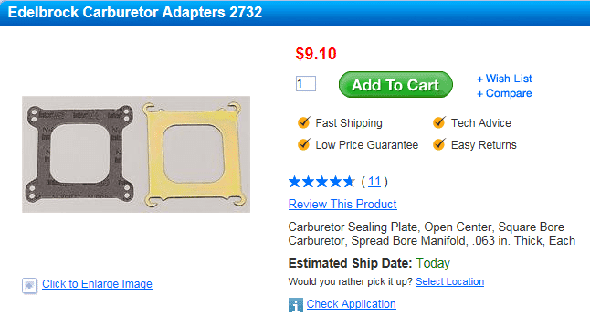

I have a new 650 Edelbrock Thunder series carb and if I get the Performer Intake I would have to get the adapter below to fit the carb.

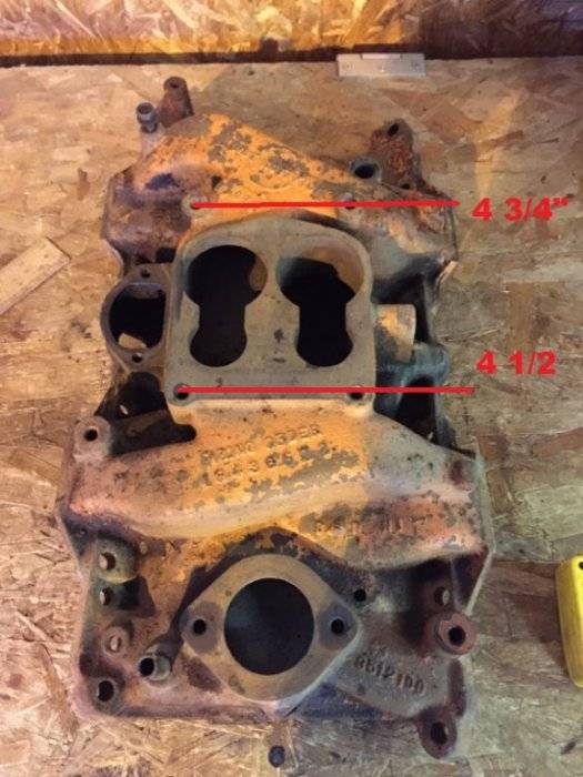

Does anyone know the height of the original carbs that came with a small block or can they measure for me? Thanks

My engine has a Mopar dual plane manifold made of aluminium. It has a 1/4 inch heat block between the carb and manifold also.
However it appears very similar to the cast iron manifold picture posted earlier. It is not a high rise.
