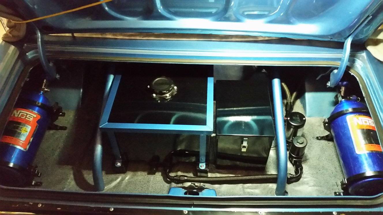

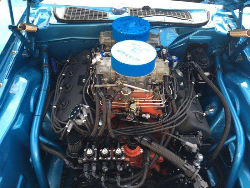

I have an Aeromotive S3000. Good for 3000 h.p. I run my Hemi with two 1050 Dominators and two Stages of NOS Foggers off of the one pump to the fuel log and split with three regulators. -12 from tank to log, -8 return, -8 from log to the carbs, -6 to both nitrous kits.

Does your fuel pump have a limited run time they recommend? I am looking at another fuel pump but they say not to run it continuously for more than 1.5 hours.

I have run it on the street now for several years with no issues. With the return line it never even feels hot to the touch.

Looking over the specs it looks it would do the job. Nice looking setup. Thanks for the info.
