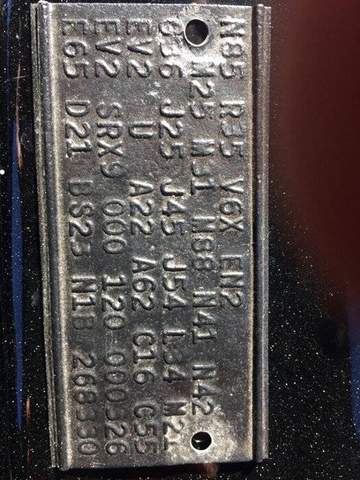

I really only found this one L34. Cool car at that.
I don't save every tag i see. I just save cars that have options that I really like or options that are rare or uncommon.

Good ole Dan over on ebodies. org explained it this way for me.
for 1970 L34 - "ROAD lamps" were STANDARD on all 'cudas (BS23 & BS27) - so every "BS" car (AARs included) received the firewall piercing for the "ROAD lamp" wiring
mid-year "ROAD lamps" became an OPTION on Barracuda (BH) & Gran Coupe (BP)
for 1971 L34 - "ROAD lamps" were OPTIONAL on Barracuda (BH), Gran Coupe (BP) & 'cuda (BS)

So it seems L34 was an option in 71 and would have had to be on the fender tag.
I've asked about the BCS and how the assembly line people would have known to install these lamps or to not install them.
Apparently the road lamps were illegal in PA and CT so they would have had to have been removed by (probably) the dealership and dropped in the trunk. The louvers were also illegal in those states as I have read.
I've asked for details on how line workers knew these things and have not gotten an answer yet.
