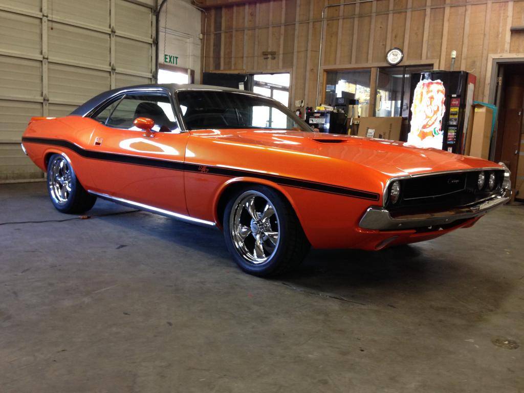

Sorry so Slow....It's a 1970 340 Block Based....408 Stroker with the A833 4 speed and 3.91's out the back
Here's a snap shot after putting the stripe on this weekend.

Thanks.....It was a fun build!! The Jeep has really turned out to be a great performer as well.....Love my Forced Induction.

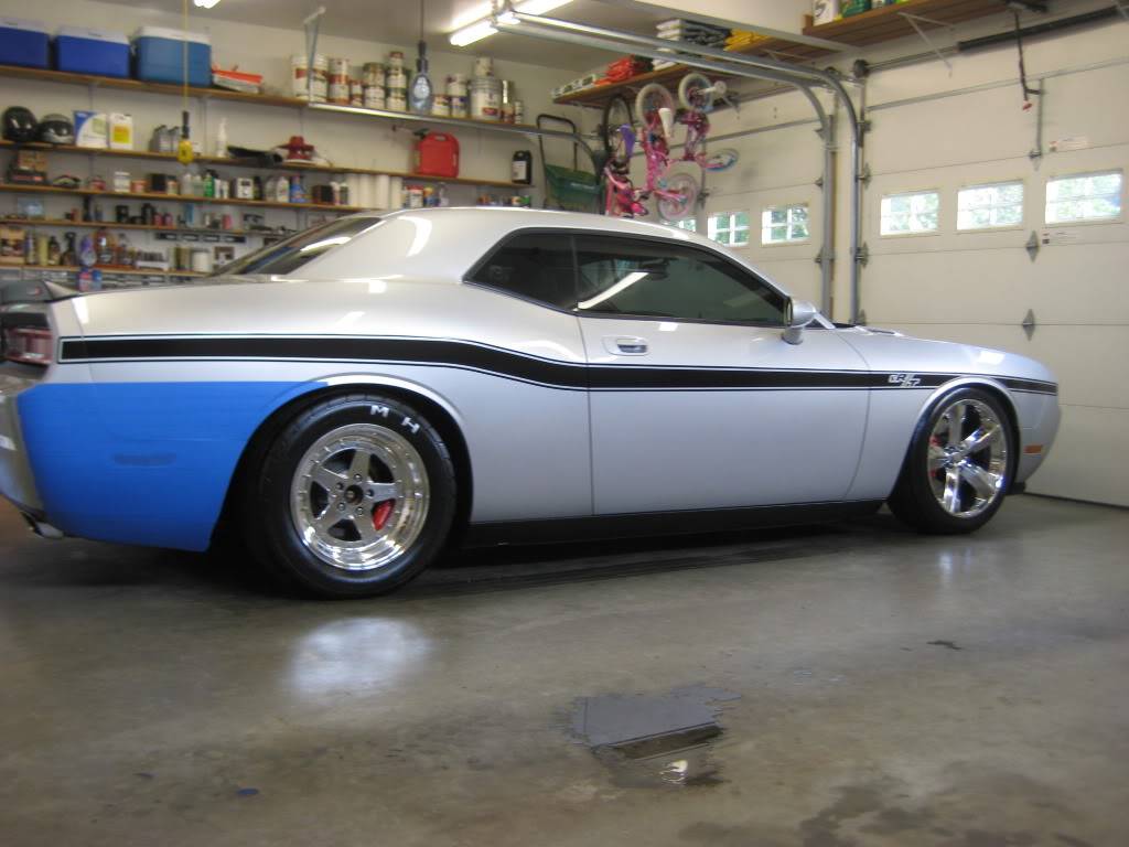

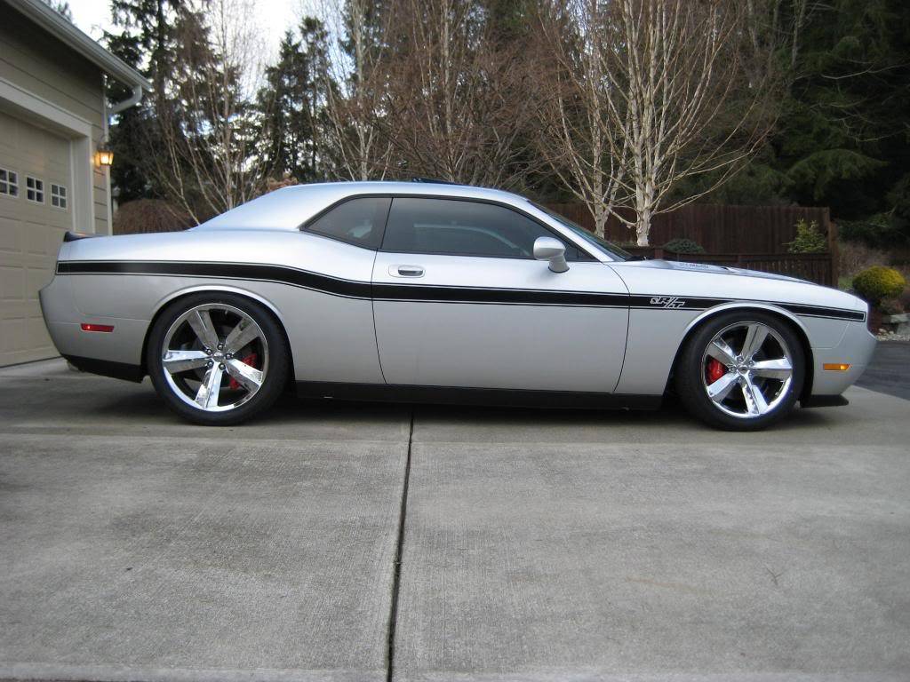

Here's My '08 Build
Track ready
Street Ready
Engine Bay

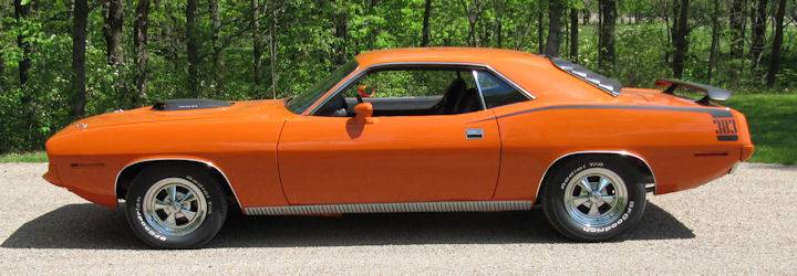

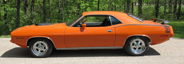

I recently had a Tremec 5 speed put into my 70 Cuda. It had a 4 speed and a 3:91. The shop already had a used Tremec that they sent to Keisler to get rebuilt and bought the rest of the "kit" from them. I also had the 3:91 changed out to a 3:55. 60mph is now 2,300rpm instead of 3,800rpm. Only regret is that I didn't do it sooner.

Nice ride my friend.....Love it! Do you have any pics of thr tranny view, Interior or during install?
Thanks!

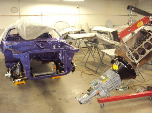

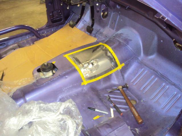

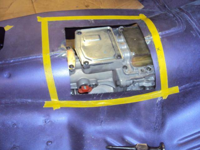

tremec tko600
Got mine from Keisler took quite awhile cant remember but i'm thinking 6 months

Thanks For the Pics...Just what I needed to see!......Fricken Nice setup on thr front suspension Bro!

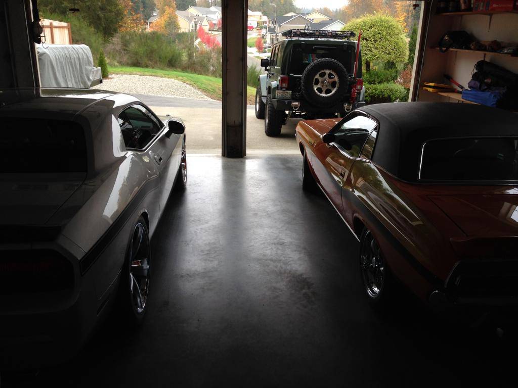

The Family Mopar's.....(2) Forced Inductions and an Old School NA
