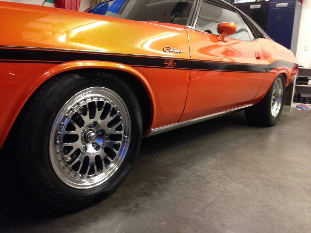

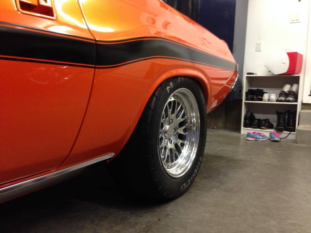

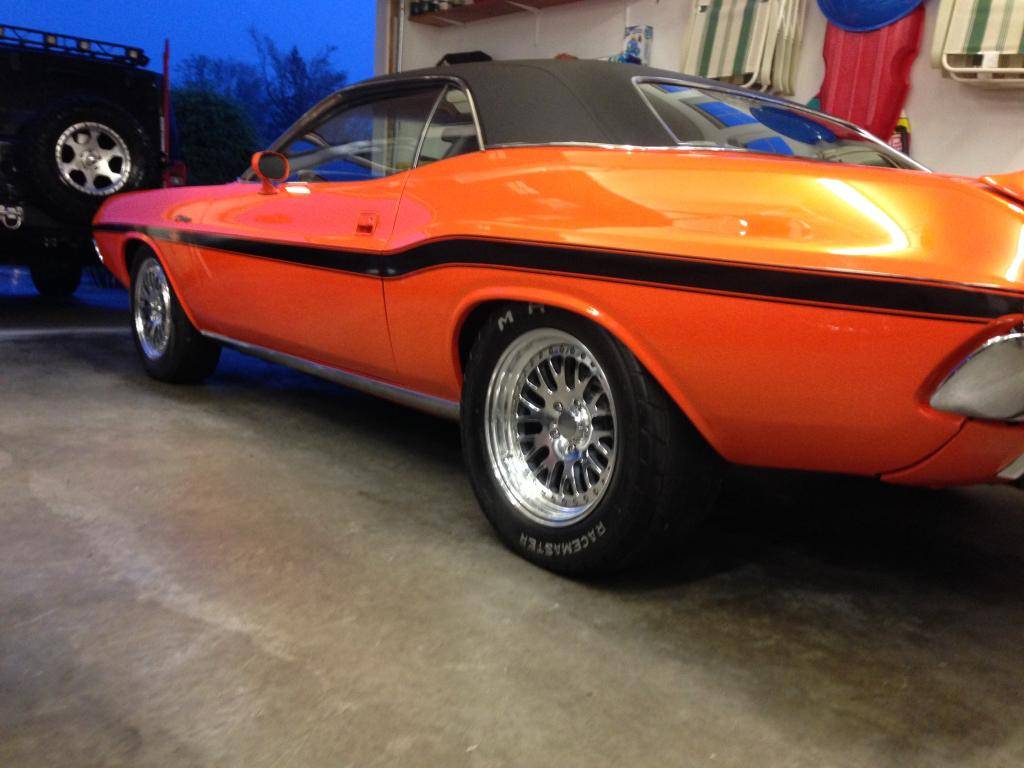

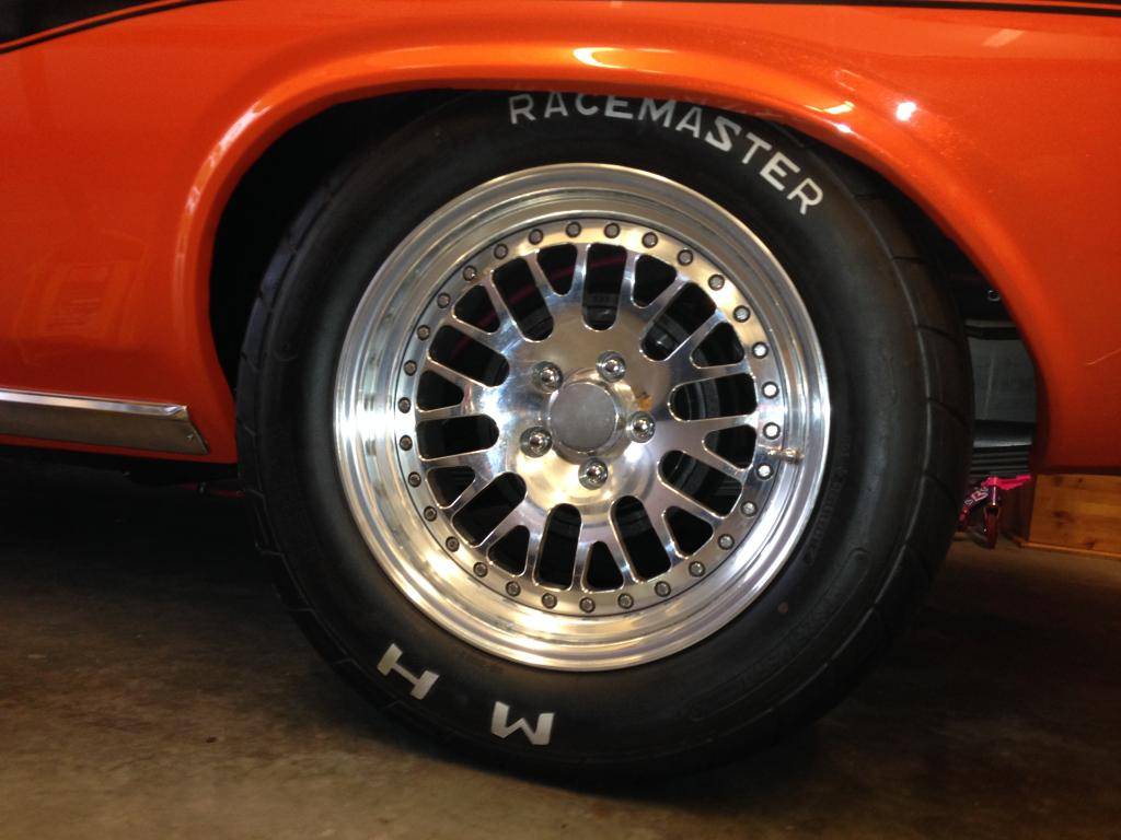

Got Motivated after looking thru another members awesome ride....So I Test fit my '08 Challenger Drag wheel package on the '70!!
Other than the Fronts being 29" Diam....Need 25-26".....It all fit like a glove!!
CCW Classic Drag Lite Weights
- 6 x 17 Fronts
- 10 x 17 Rears with 325 x 45 - 17 M & H Drag Radials
