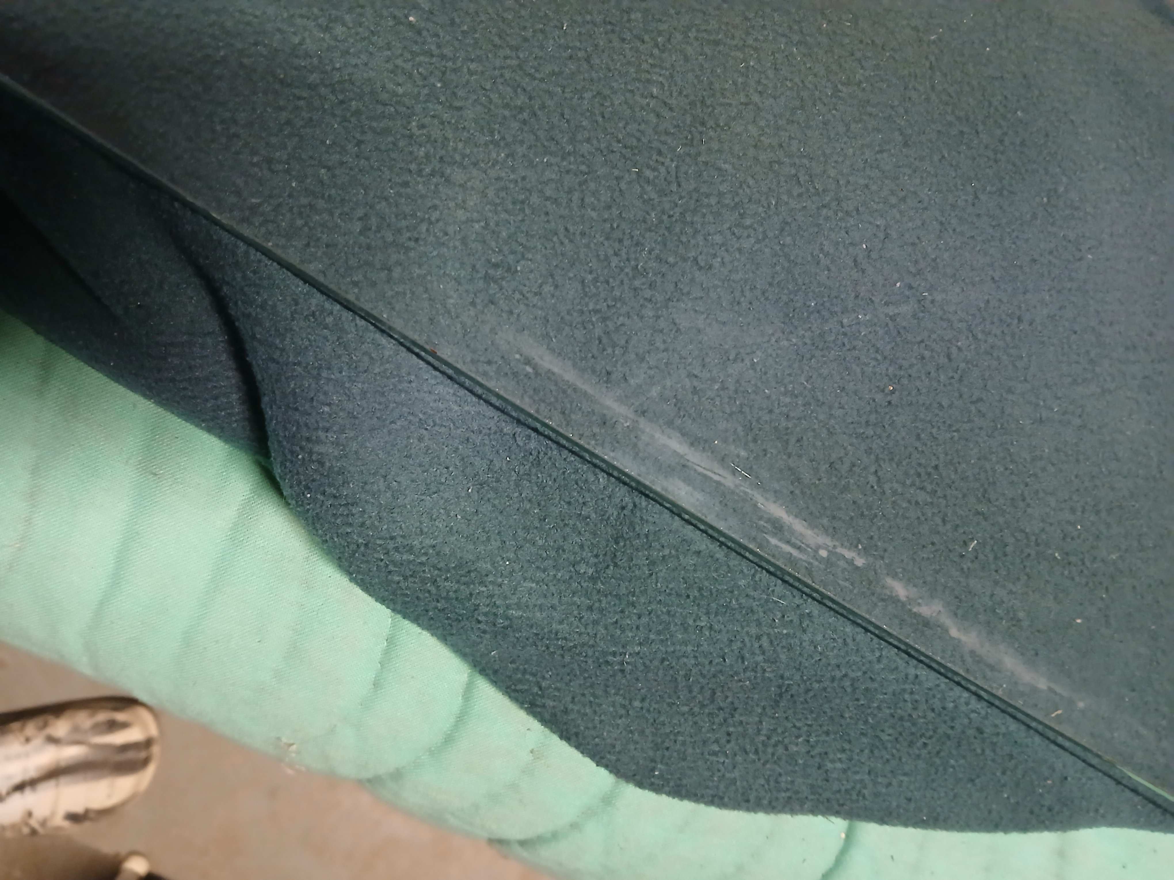

The back windshield has been in car forever. That mineralization on the glass is from the stainless moldings. I guess it shouldn't be called stainless. What product is good to take this off. Used acytone, fantastic, and tried wd40. Any suggestions

You might try 0000 steel wool, it definitely won't hurt the glass.
No coarser than 0000....ask me how I know. Cerium Oxide helps too. You can buy it a glass shops as CRL Sparkle.

Thanks, I believe I got it conquered. Took different approaches, and a lot of muscle.

I used the steel wool along with some vinegar on difficult spots. I used a razor blade very carefully to scrape the stubborn deposits that the steel wool couldn't get.
