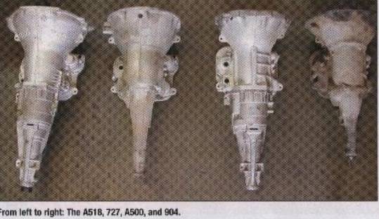

Welcome, I'm not a mechanic, I'm a body/paint guy, but here is a picture of different Mopar tranny's that might help you ID it.
My guess is it would be a 904, but again, I'm not a mechanic.

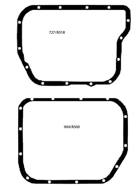

Good photos, Alley. One of the ways you can tell the 727 from the 904 from under the car is a visual inspection of the shape of the pan. If it's kind of squared off it's a 904. It's it has a "bump" to the shape it's a 727. Either way, if you're looking at a 440 for this build and you have a 318 in there now you're also going to have to get big block tranny, since the bellhousing is different from the LAs to the B/RB engines.

Here's a pic. that shows the difference between 727 and 904 pans...and I agree with what ramenth said, if you swap to a big block, you will have to switch to a big block tranny regardless of what you have now.
