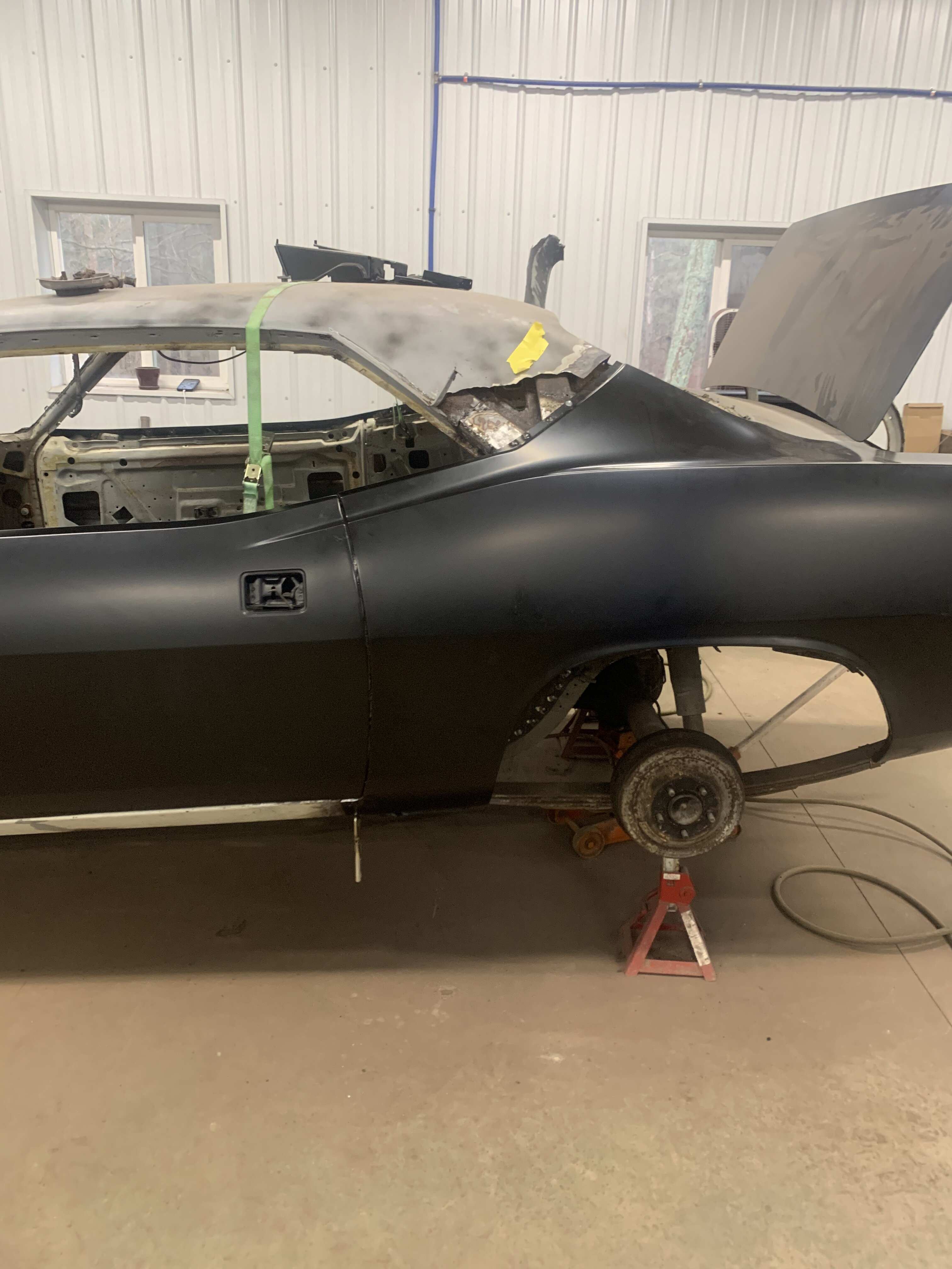

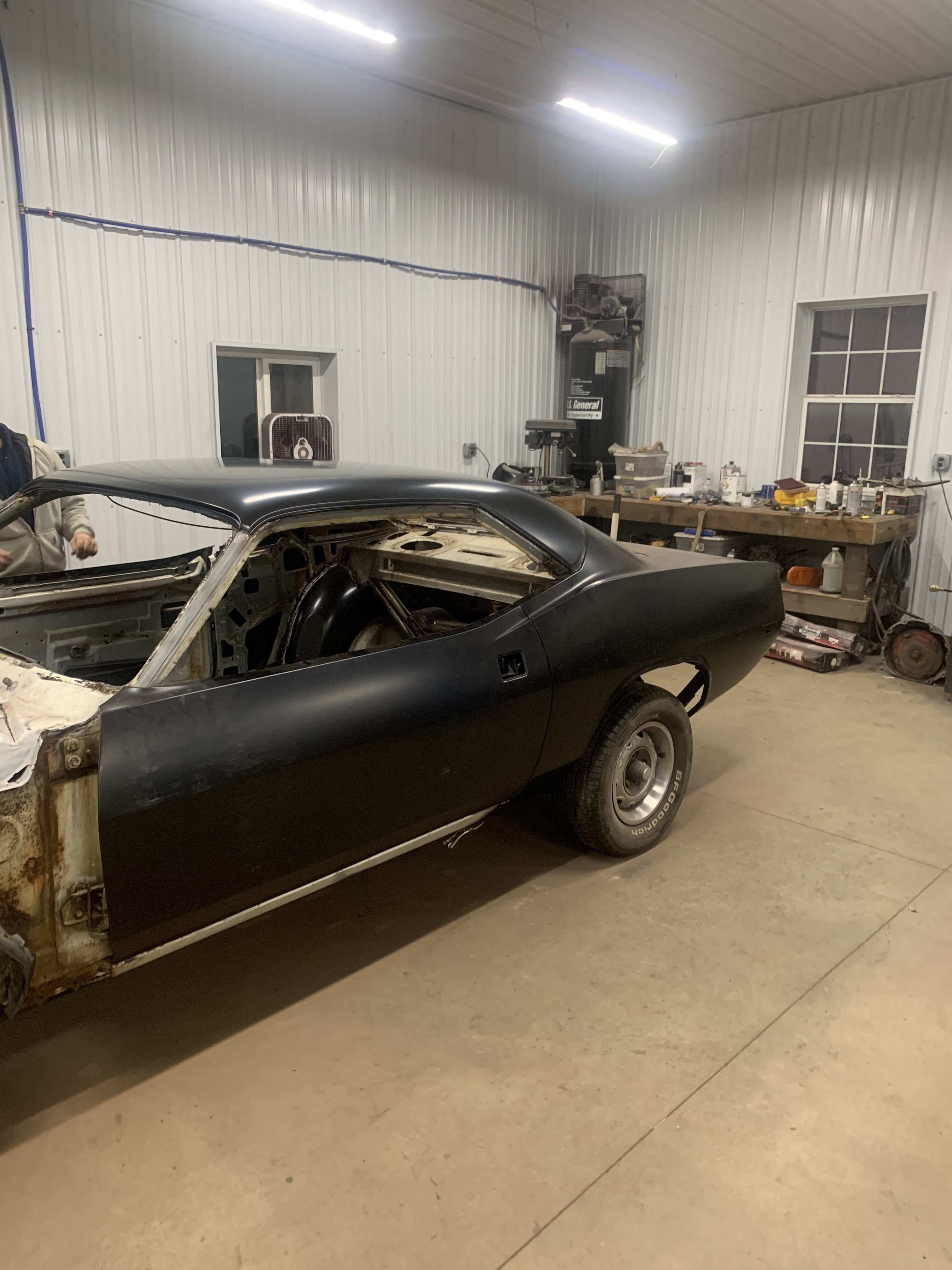

we’ll we are progressing. final fit on pass side full quarter was to easy , it’s tacked and could be welded in . new door skins installed both sides so alignment is confirmed. the left took a little more work but is looking very good . another piece to the puzzle came off back order at amd, my roof skin is en route . that is great news .

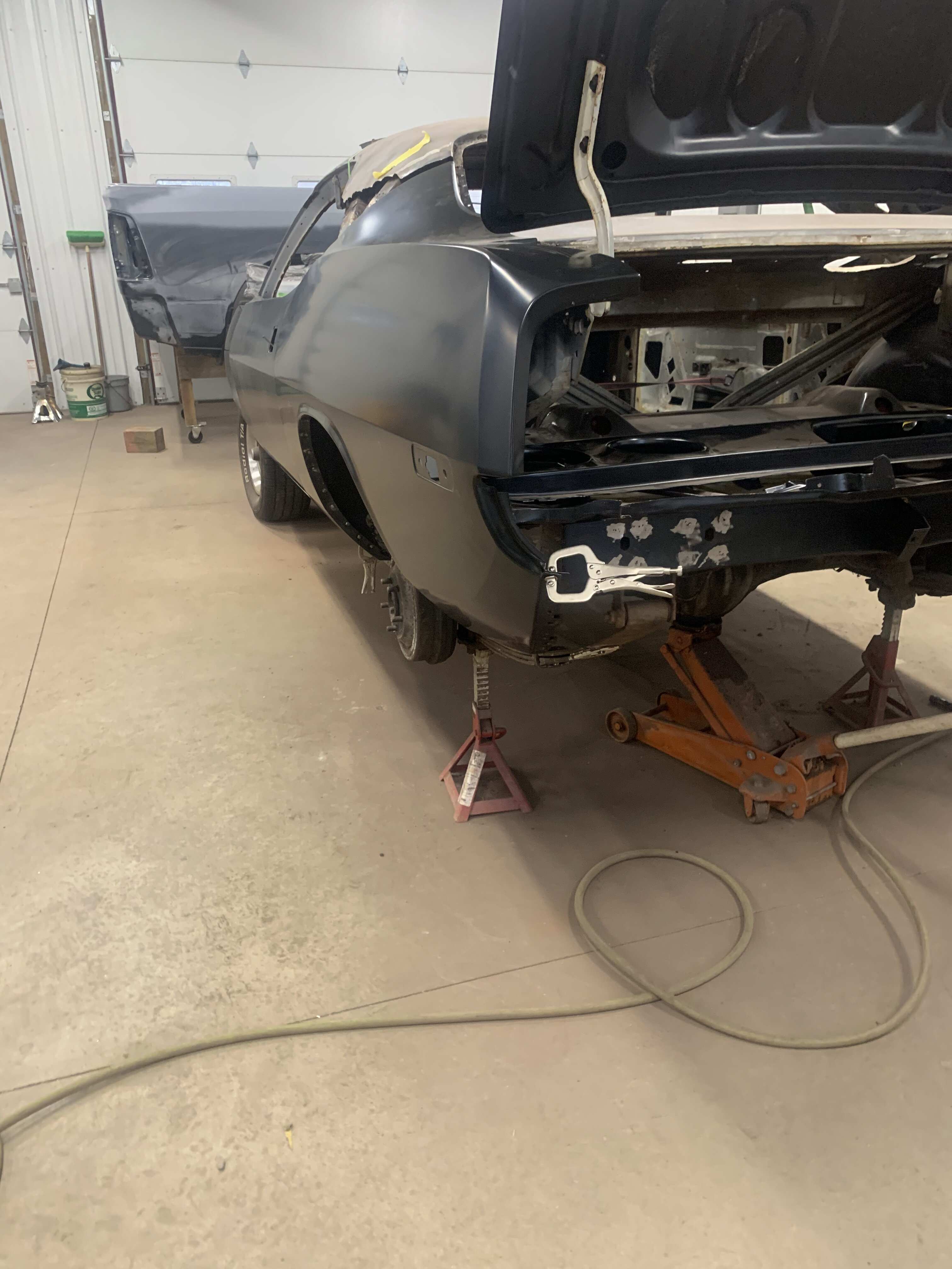

next hurdle will be fit taillight panel and and rr valence . that should lock up the whole tail section to the quarters ….man i can’t wait !

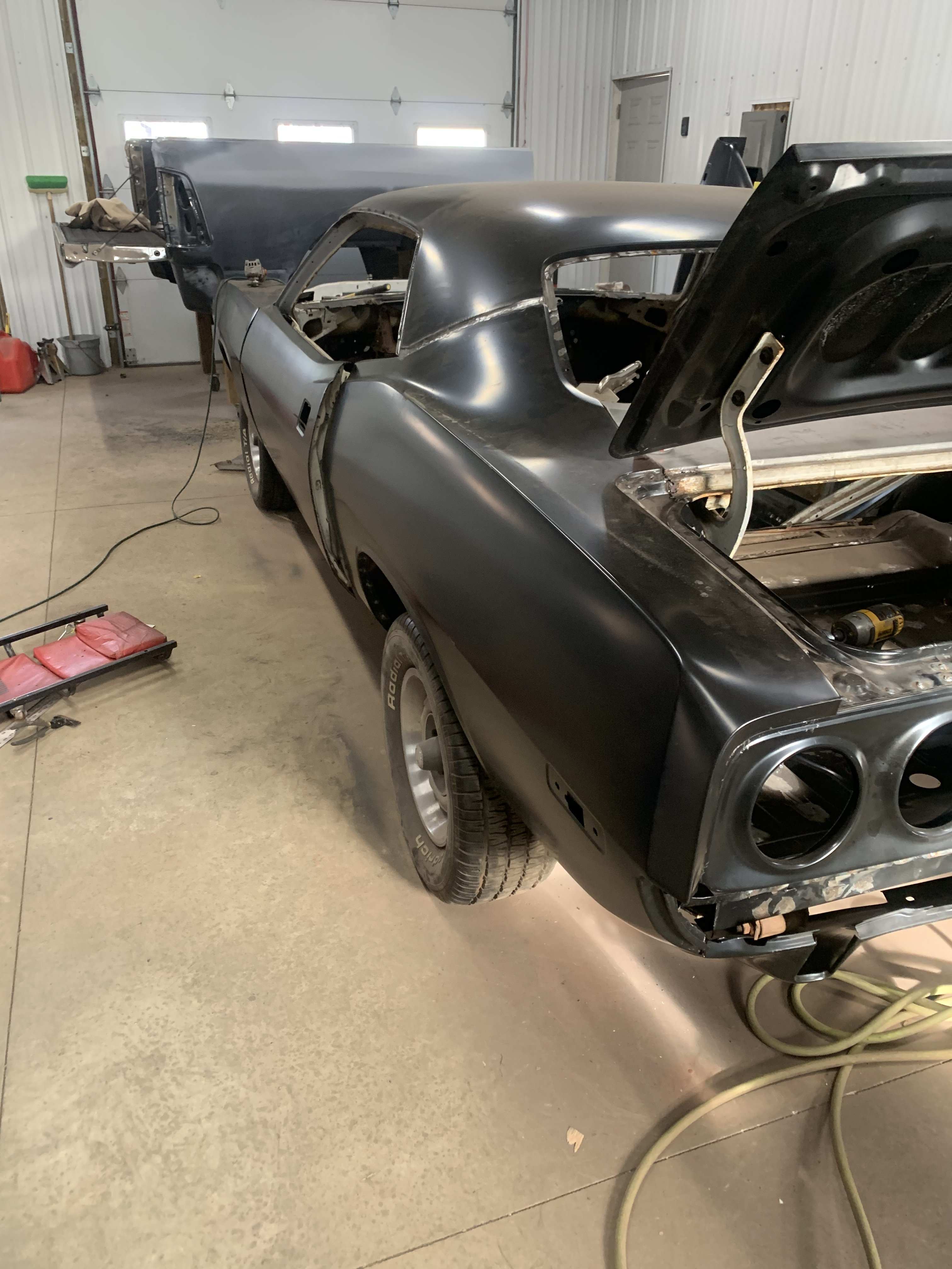

forward sections of both full quarters now welded in , looks very nice , we left the very back for final fit with the tail section , roof skin should be here literally within an hour ….

deck lid question? i bought a 1974 chrysler parts catalog but not finding the exploded view of the deck lid for e-body . i have one torsion spring for the deck lid , is there supposed to be two ? it appears torqued for one side to the other … pics would be helpful, tia….

cool thanks , my deck lid don’t come down flat and trying to figure why . it hits on the left (driver) side before the right . we reduced tension to the last hole but same result. thought if it was supposed to have two springs and that would mean im missing one it might be the reason . but now i have to figure why it’s twisted . by the way it’s an amd replacement deck lid on original hinges n hardware…

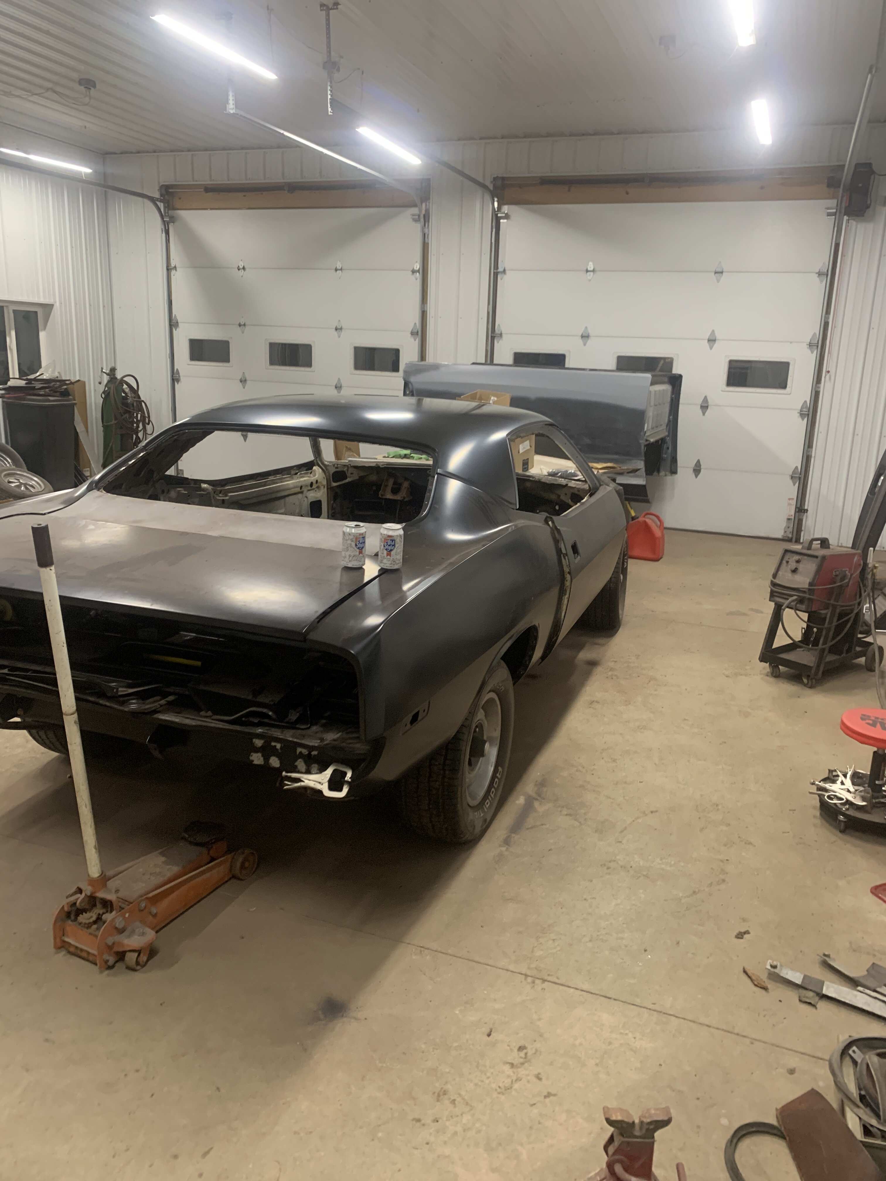

roof skin removed and now fiting the new one (amd) which arrived in great shape . the new drip rails (amd) don’t have the same contour as roof and have to be shaped to follow roof . anybody run into this ? there also a tad long towards windshield , if any body has pics on the drip rail install please add , be a help ….

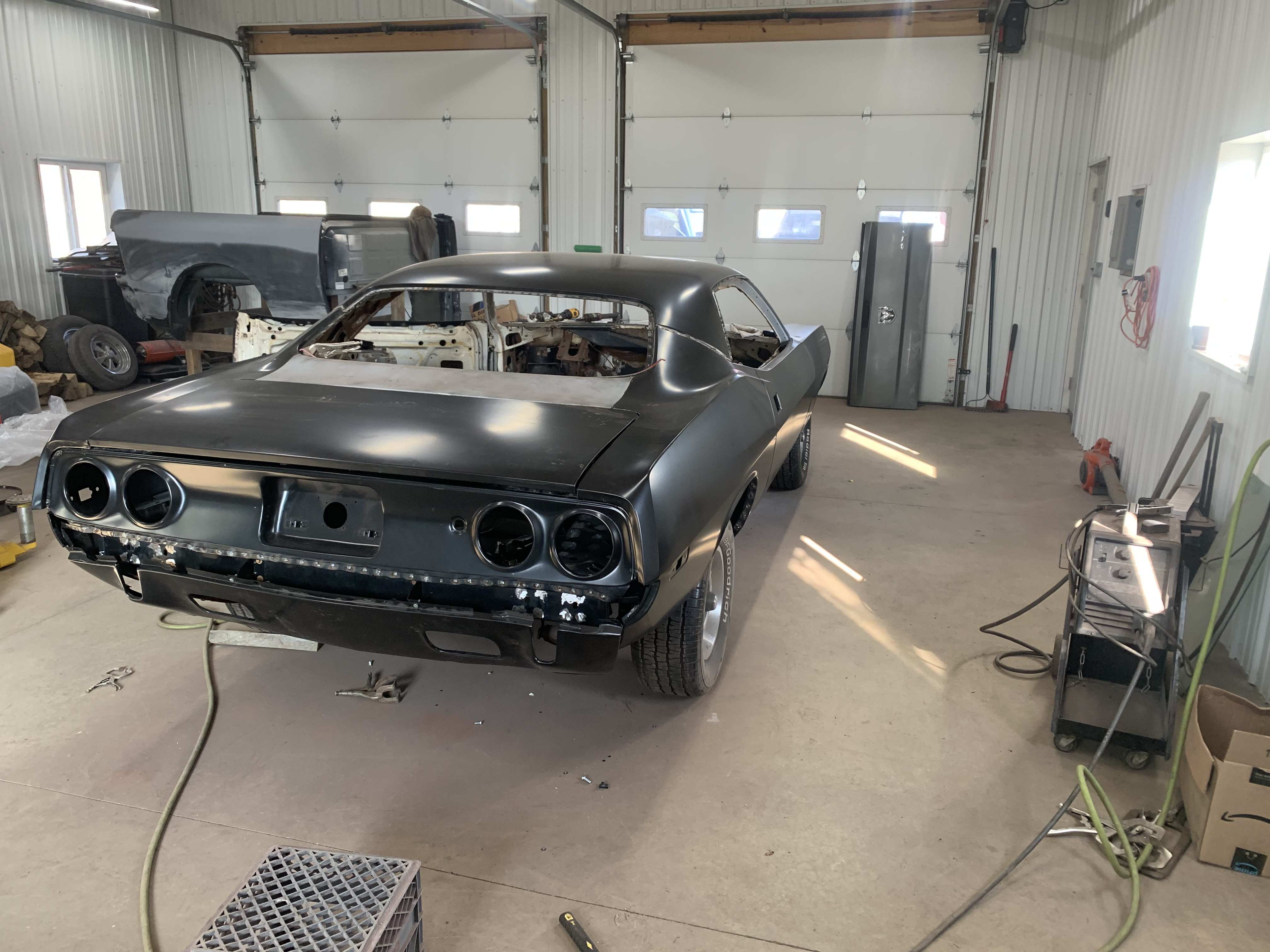

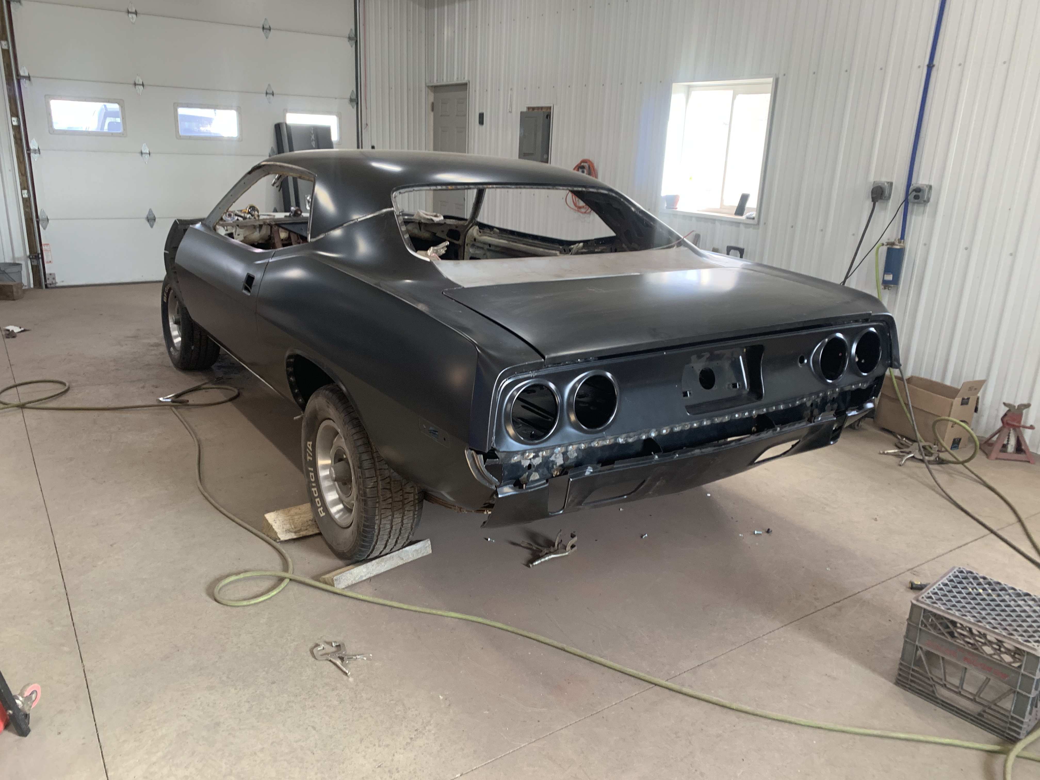

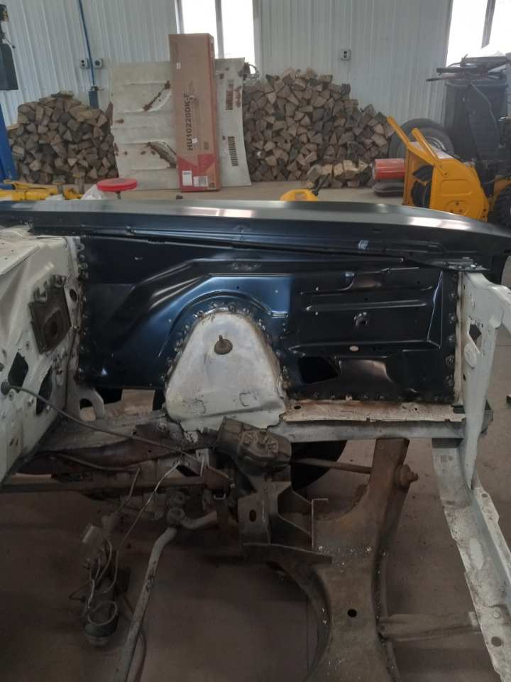

be awhile time for some updates- taillight panel , trunk gutters fitted and welded in , right side inner fender removed and replaced, outer hanging for visual inspection. looks great so far ….for skin fit and partially welded….

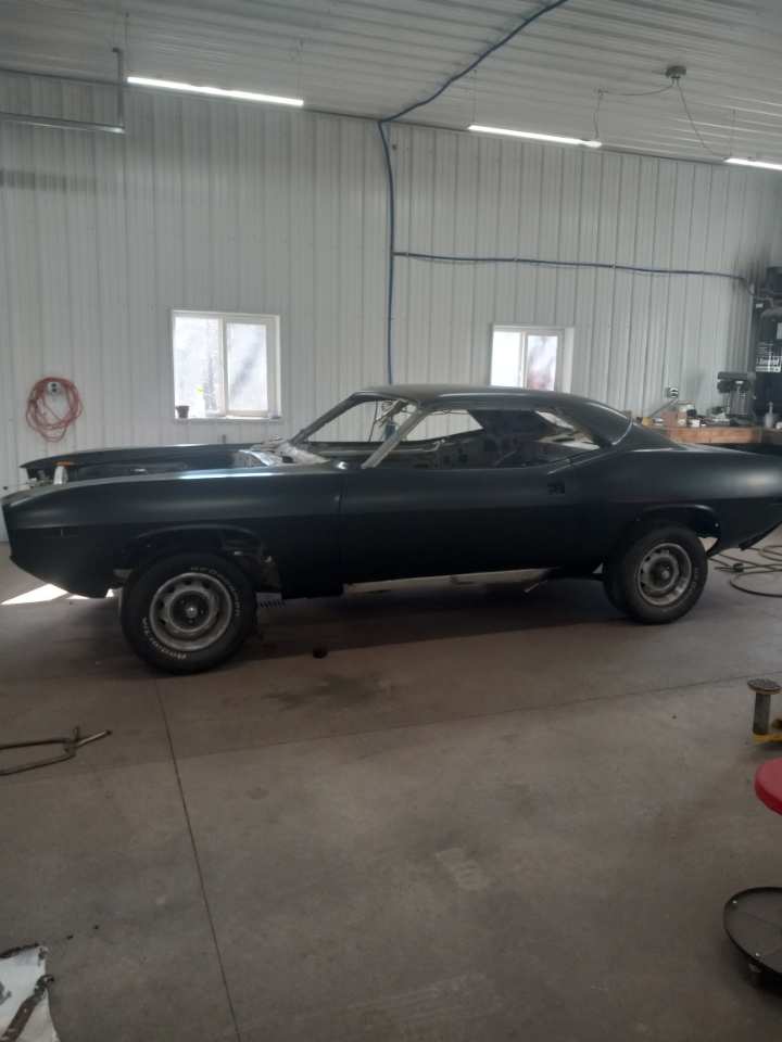

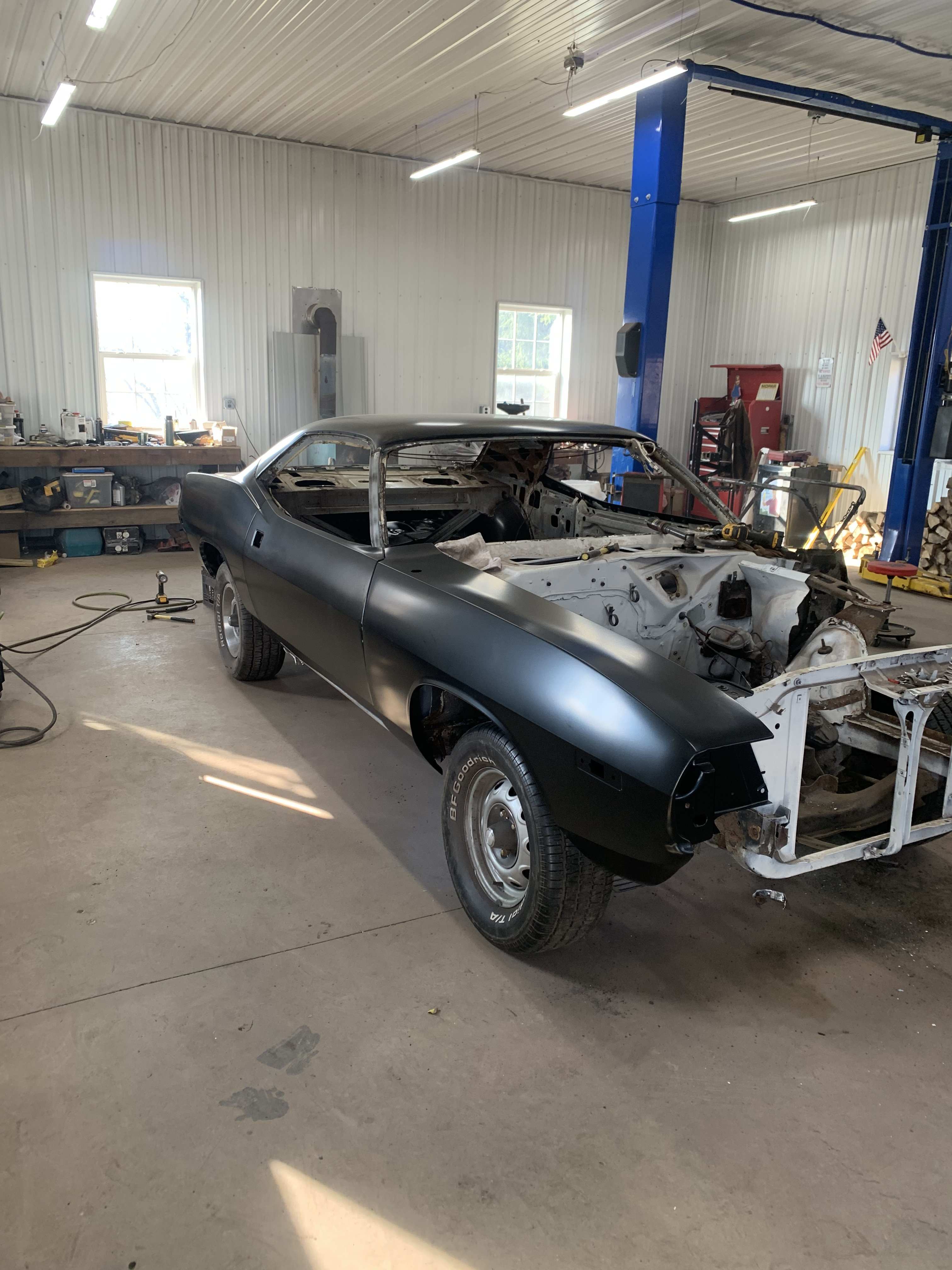

can’t tell by looking at it but we’re progressing nicely. most is the panels welding now completed! finally. a little touch up welds on front inner fenders . then we ready to fit / hang front fenders , valence, headlight buckets. i’ll probably look at the front bumper fit as i want to locate them as a 70 would look . i think i can mod the brackets in the front . i’ll probably replace the rears with early brackets as not sure the mod as easy in rear . all the white you see on car is oem , black stuff replaced panels …lol!!!
