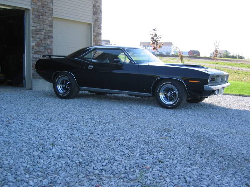

Yes, the 15x8s will fit fine. You'll need a 4.5" back space. Although I would recommend putting the 15s in the front. Seems to me like you might end up with a little too much rake with the 14s in front. That's just my opinion. I have 275/60/15s in the back with 135/60/15s in the front. I think this combo gives a nice stance. Heres a pic...
That does look very good, thank you for the input:)
