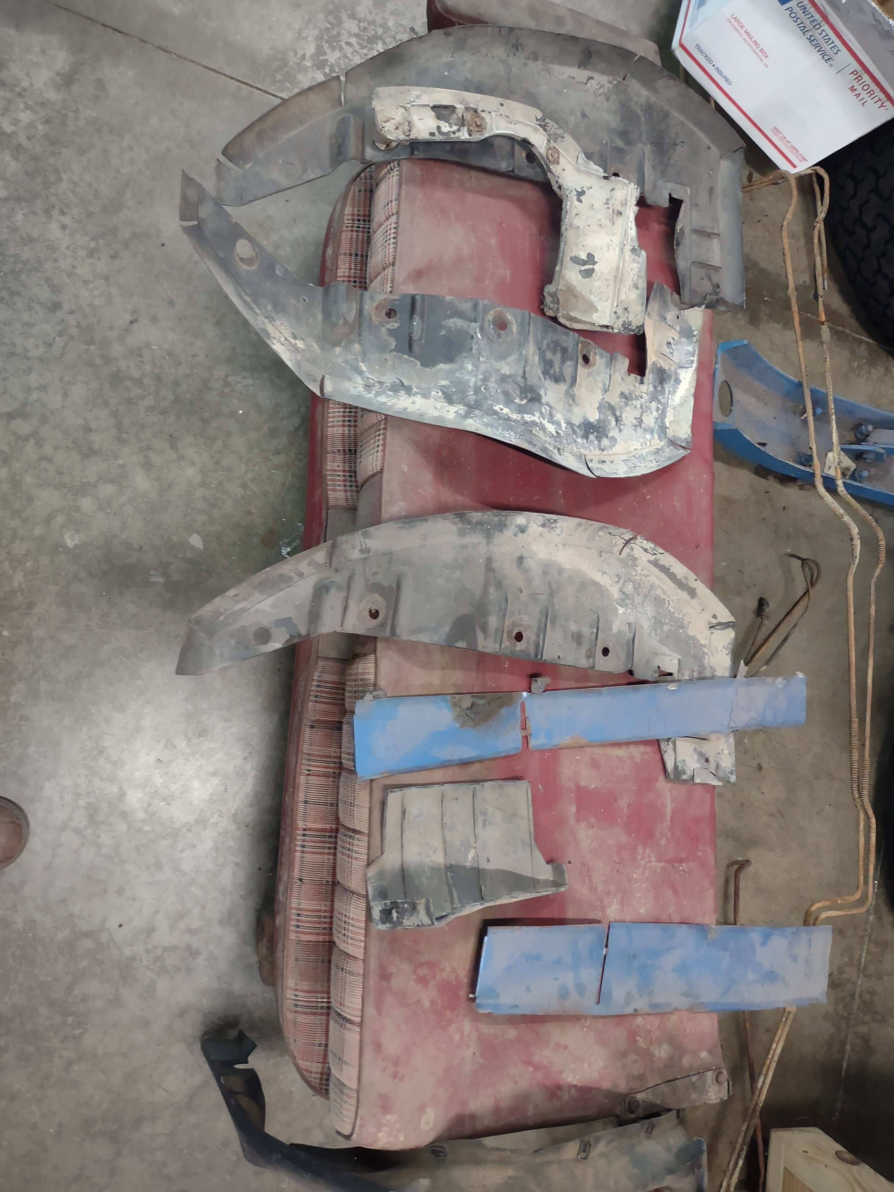

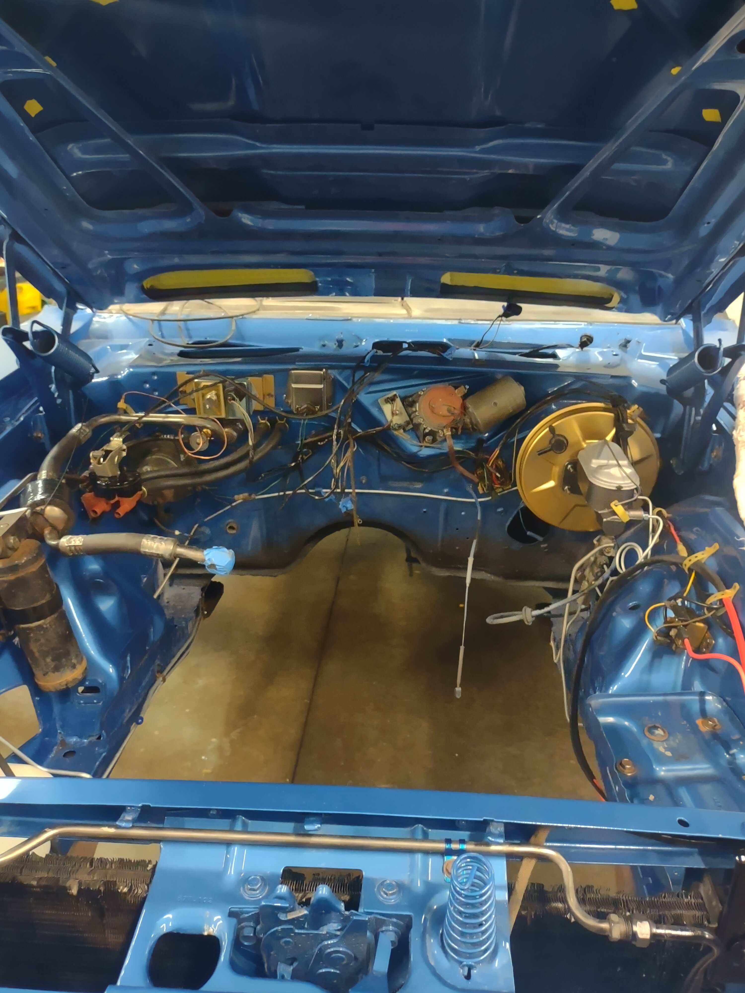

Can anyone identify the two slightly curved pieces of metal that are painted blue in the picture. They have hooks on one side. I'm putting my 72 cuda back together which was originally partially disassembled. Any help will be appreciated thank you

I have wiring loom covers on my 67 Camaro which run on top of the rocker and the carpet lays over it however these have hooks so I wasn't sure thank you

Yes they are wiring covers. They go along the inside rocker, drivers side floor board. Towards the front.

Thanks for the info. I'll bet what I thought were hooks were the spot weld sites

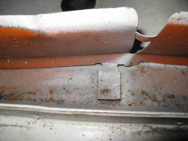

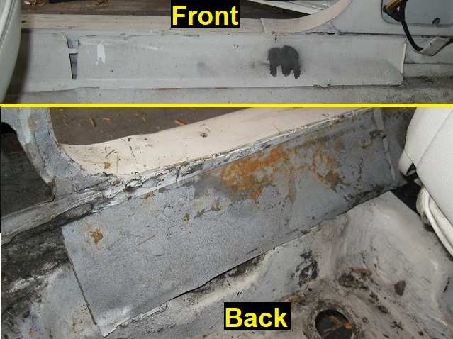

Here they are in my car and a welded tab picture (not my car)
They're available new if you have broken tabs, which is very common.

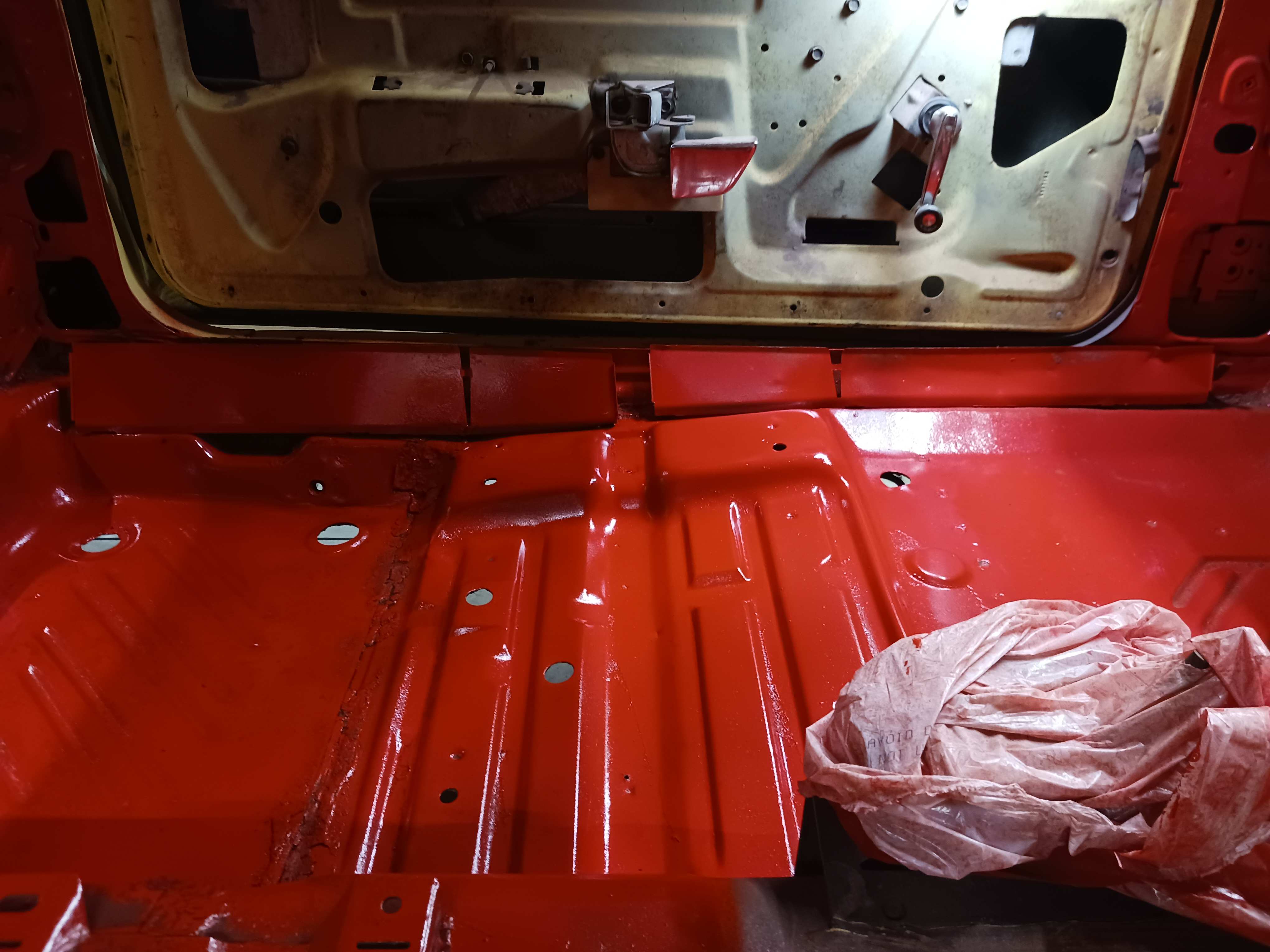

Thanks that was very helpful. Unfortunately when I started out there wasn't much of a floor in this car. It's nice to have some pictures for reference.

I really appreciate that. Like probably most you guys restoring cars I'm over budget so I've got sheet metal and I can weld a couple of tabs on my old ones and install them again. Thanks to all
