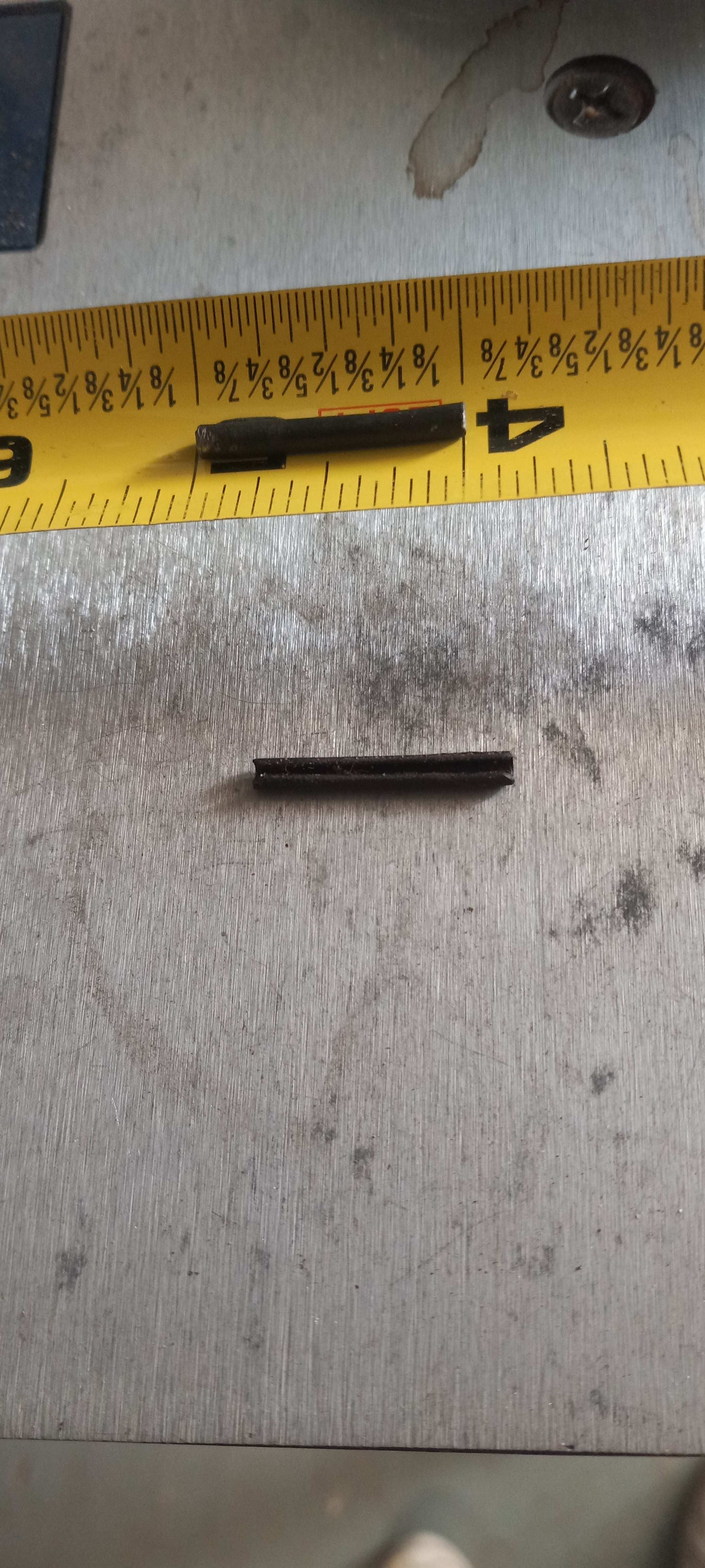

Finally got some needed parts in, and back to putting the gran coupe back together. Got a couple of 1 inch pins, have no clue what they came out of? I believe somewhere in the front steering? Does anybody know???

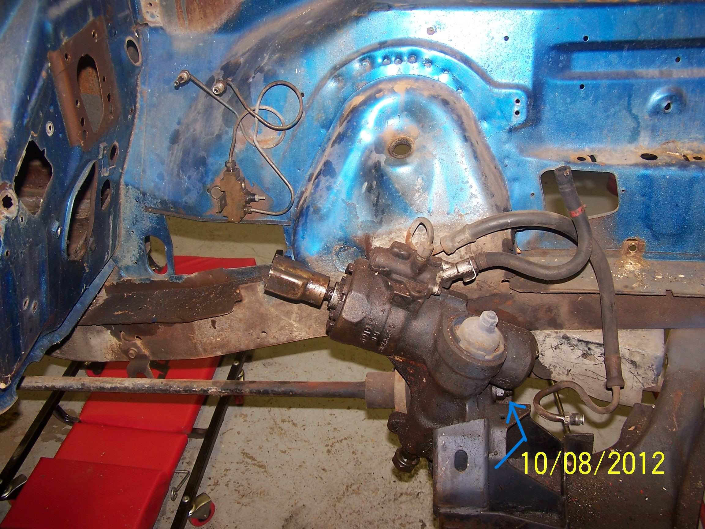

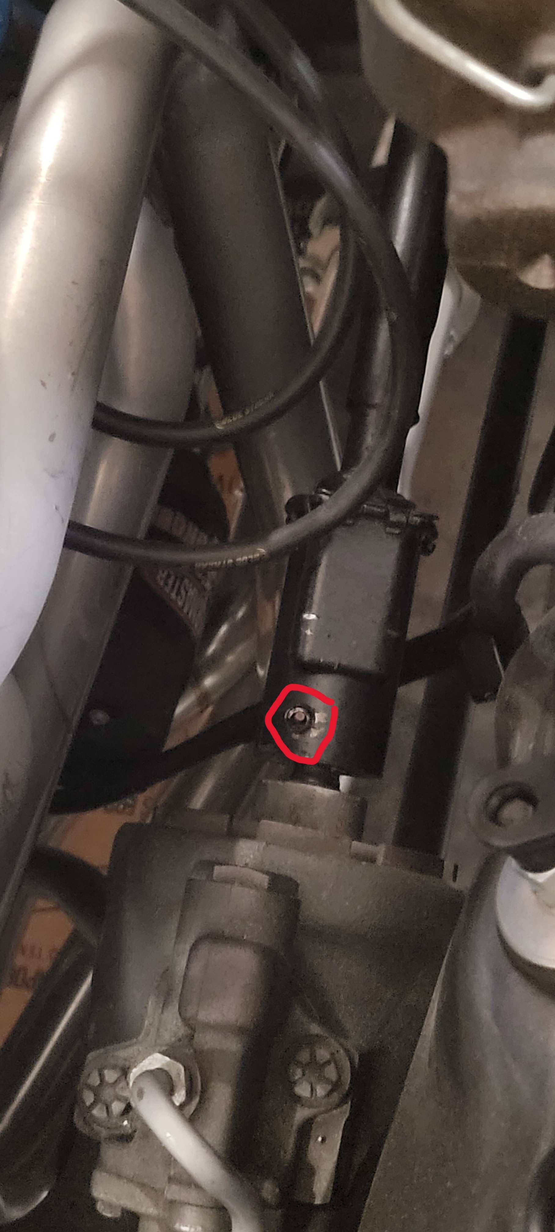

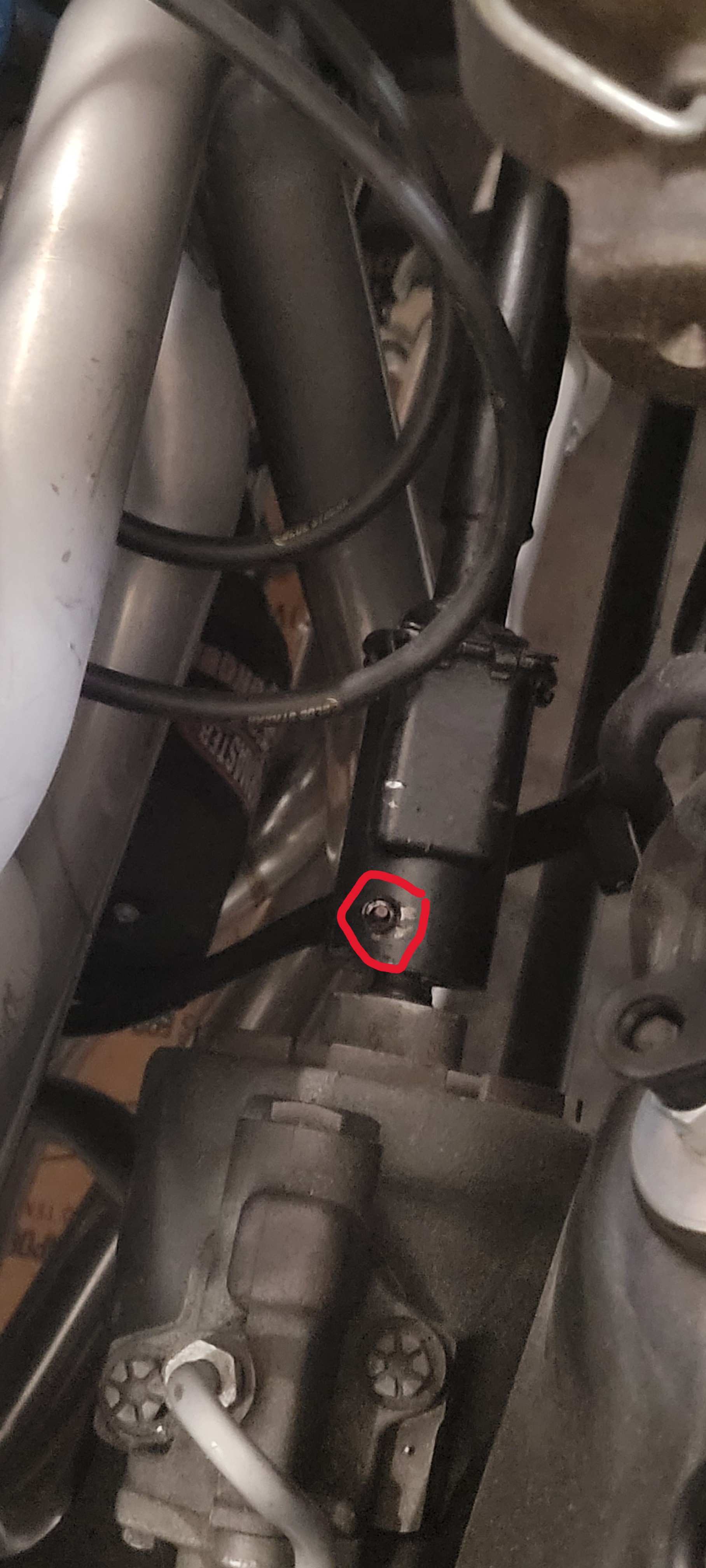

I am not an expert, but I think it goes here. It aligns with the recessed groove on the splined shaft. But only one, not both of them.

Agree with Challenger RTA. Look at the end of the strut rods, there is a hole there for the roll pins.
Yes, without the 2 small roll pins. Would that make it sag? I know I did put them in. Wanted to know how and where the go??
I think the only job those pins do is stop the strut rods nuts coming off and being lost.
