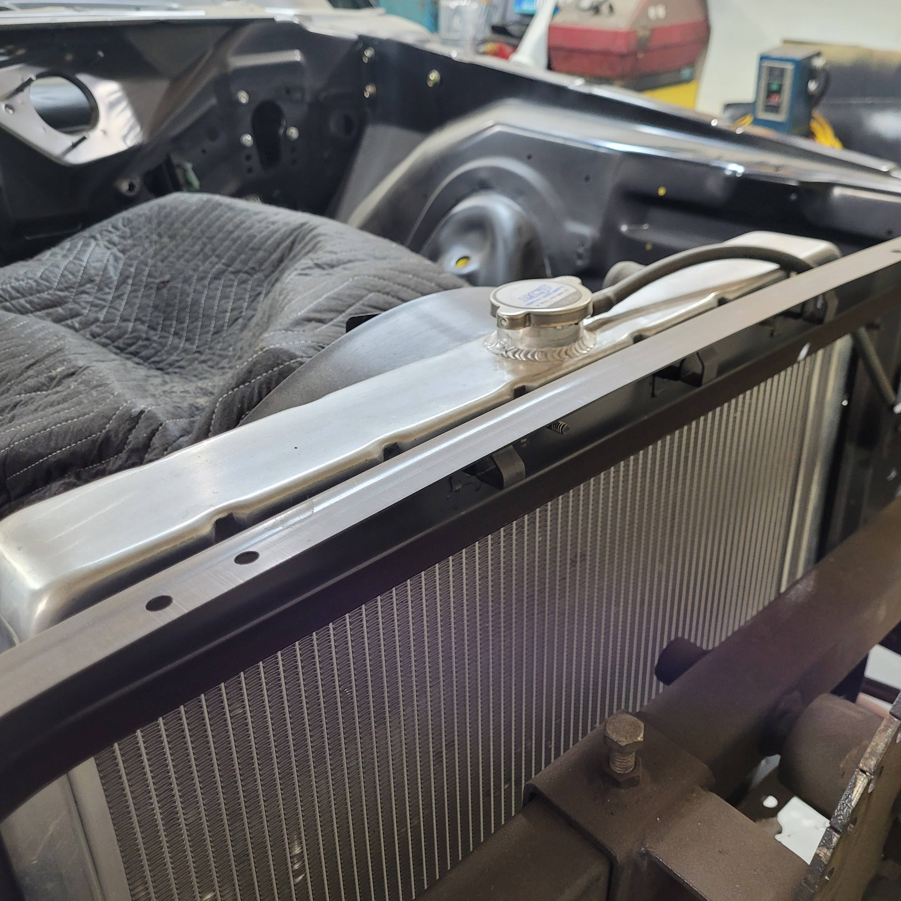

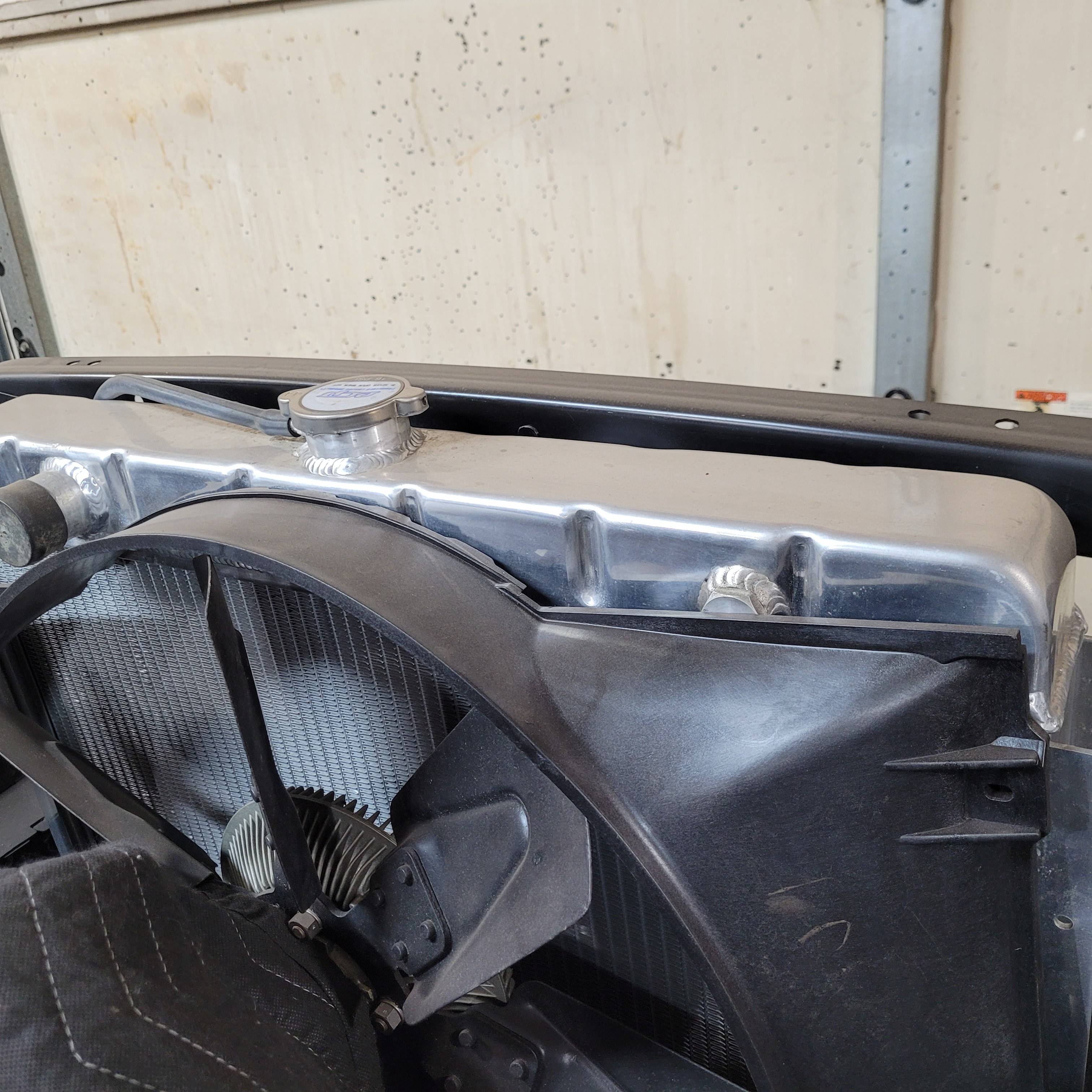

Im installing an aftermarket aluminum radiator. Its going to require some customization on the mounting brackets but I need to know how much higher does the top tank sit above the radiator support. As I have it installed now the shroud cannot be installed because the fan will hit it. Looks like the radiator needs to go up about an inch to get the fan centered.
The car is on a rotiserie and currently has no fenders or hood on it. I wont permanently mount it until the hood is on but wanted to get it roughed in for the time being.

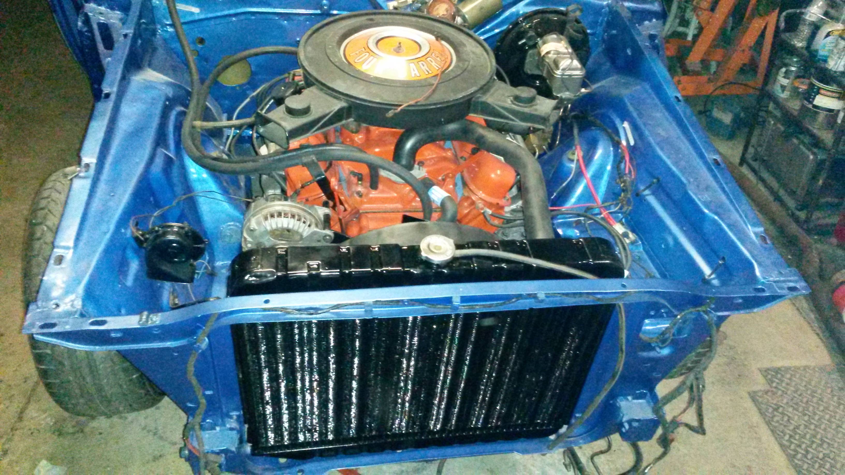

Thanks, that confirms what I though. It appears to stick up above the support. If someone can get me a measurement that would be great.
