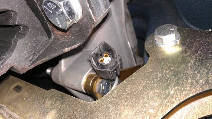

I'm installing an SST TKO five speed in my 70 Challenger. the car was originally an AT car. does anyone have any photos or info where i'm supposed to run/connect the TKO's neutral switch wire to?
Thanks.

The normal place is on the clutch pedal with a manual trans , not sure if the TKO has a neutral switch in the trans

Apologies, I wasn’t clear. The TKO has the electrical connection with pigtail. Where do I connect that on the car?

start relay , there are 2 spade connectors , the yellow one is the power to the relay the brown wire grounds through the neutral start switch to ground

Connect the original brown NSS lead to one side of the TKO NSS pigtail, connect other lead of the pig tail to ground. The TKO neutral safety switch will then allow starter function only in neutral.
